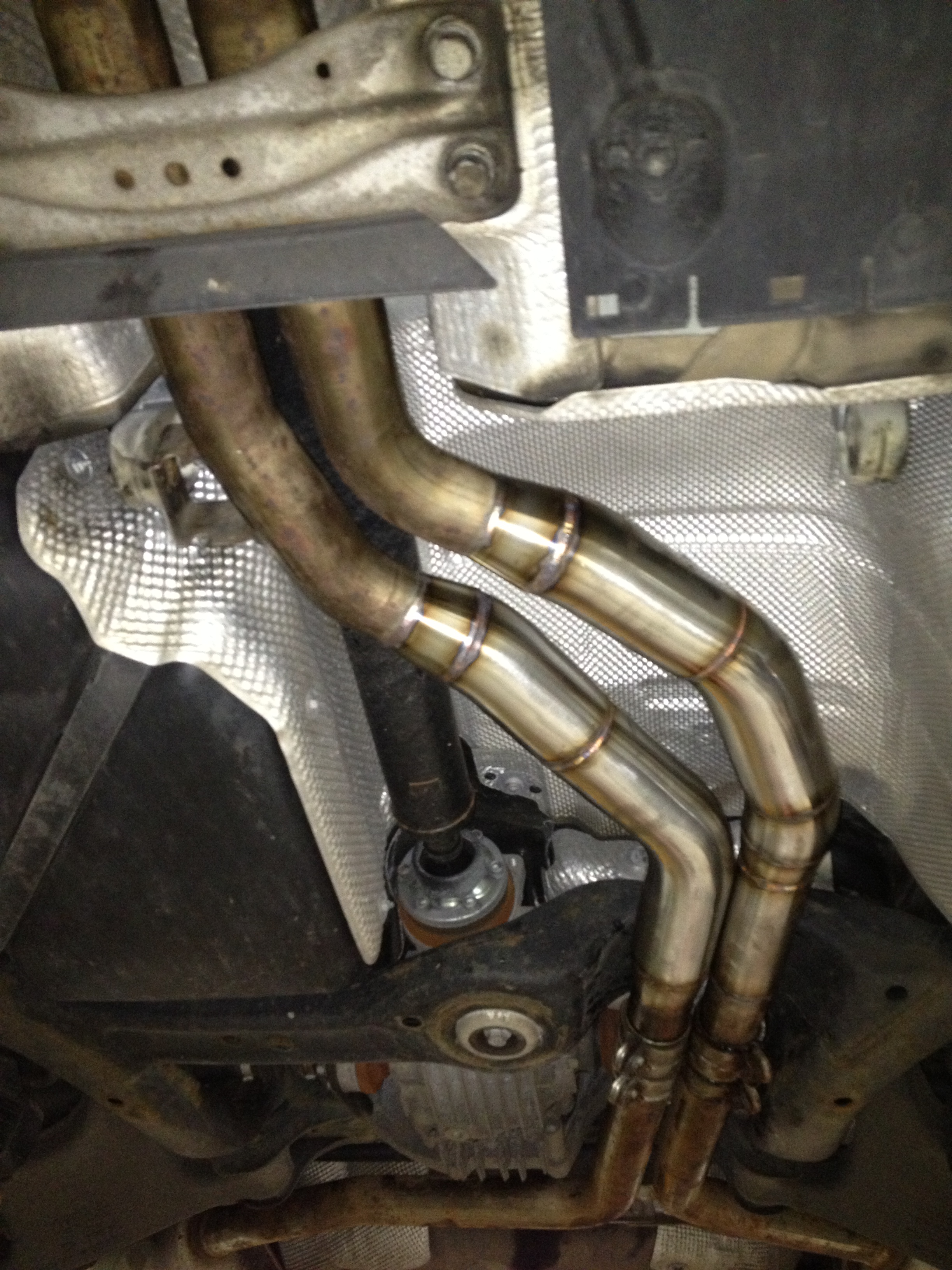

Just back from MRC in Banbury. Great bunch of guys. First class service and lots of care and attention given to the car.
Now, this is where it gets complicated. I was down at MRC for wee performance upgrade. This has taken the S4's power from about 350ps / 477Nm to 472ps / 580Nm.
You can find the job here at mrc:
https://www.facebook.com/media/set/?set ... 647&type=1
The actual Supersprint x-pipe exhaust part of these changes fell through. Supersprint in Italy cocked up the order which was supposed to have arrived at MRC last week. The Supersprint rep in the UK, having claimed that the order was shipped, retracted that and stated that the factory cocked up the timing of manufacture. I saw the correspondance for this. It was now due to arrive a few days late.
Given the distance and the travelling arrangements, it was too late for me to cancel the trip. MRC offered to fabricate an alternative - essentially their own X-pipe. (They have a superb fabricator down there). If it didn't work for me, they'd take it off. The x-pipe was nothing to do with gaining more performance, only an improved sound.
The result:
For me, it initially sounded a bit more raspy than I would have liked. Under load, there is a definite presence, with a note which is higher in pitch than a B7 RS4 say, but not as sweet. After a couple of days, I now have to say that driving around town and country roads is a joy. It can be quiet on start up and moving off, or you can make it rumble. On the Motorway though, I'm not so sure. There is a definite drone at 75+. In 6th gear it's not so bad. In 7th, (s-tronic) the lower revs increase the base note to a point which annoys after half an hour. I'm still undecided from a long distance journey perspective. Other than that, it's a joy to drive.
I'll try and get some noise vids together. Meantime, see the image below for the fabrication work.
MRC's B8 S4 centre box delete

Interesting about the drone on removal of that big X-Box from the standard exhaust setup. I was told that this may occur by Milltek, but of course one man's "perfectly reasonable" is another's worst nightmare. Sounds to me as though it sounds much better in many ways, but jury is still out regarding m/way cruising. I have the 6MT, so perhaps that is higher geared?

The performance increase is very very noticable. The torque is just nuts. It's like driving a diesel. Even in high gears at motorway speeds, I can still pull away really quickly.
With the S-tronic gearbox, I was getting annoyed at the fact that I couldn't tell which gear I was in from the engine and exhaust notes alone. That's all changed now. I'm now learning to use the paddles manually without having to look at the revs or the DIS to see where things are at. The stock B8 S4 is way too quiet for a fun drive.
A major spin off benefit is the wee engine blip as the car changes down the gears during braking. It's really neat and now very obvious. Love it!
The next day (Saturday), I took the car to Bedford Autodrome for an open pits day. The car was very quick and easily held it's own against track cars. On the long 1km straight, it manged to get to 135mph before heavy braking - it had plenty more to give. There are numerous comments from track day attendees on Facebook regarding same. Truth is, I'm crap at track driving - not getting the opportunity very often. The car made me look better than I actually was.
Another data point is that all 3 MRC cars and and many others got black flagged that day for being too noisy. (There's a low noise limit at Bedford). This included MRC's red B8 S4 saloon there which has the Miltek. Go figure!
Another data point I discovered when asked to do the noise test at 4500rpm, is that, in S-tronic Neutral, the car is rev limited to about 4000rpm or less. That was weird. I didn't expect that - never tried it either. :shock:
