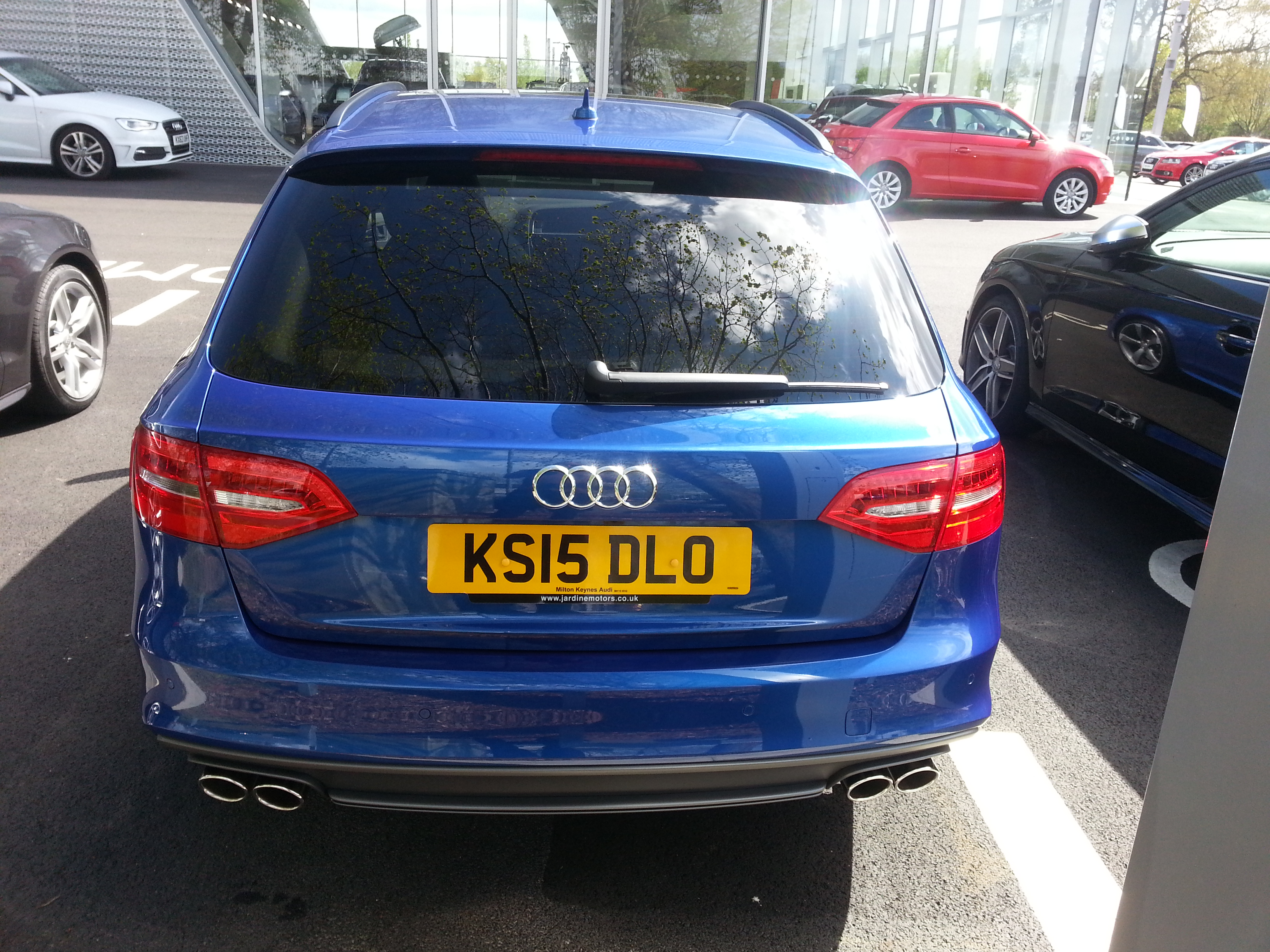

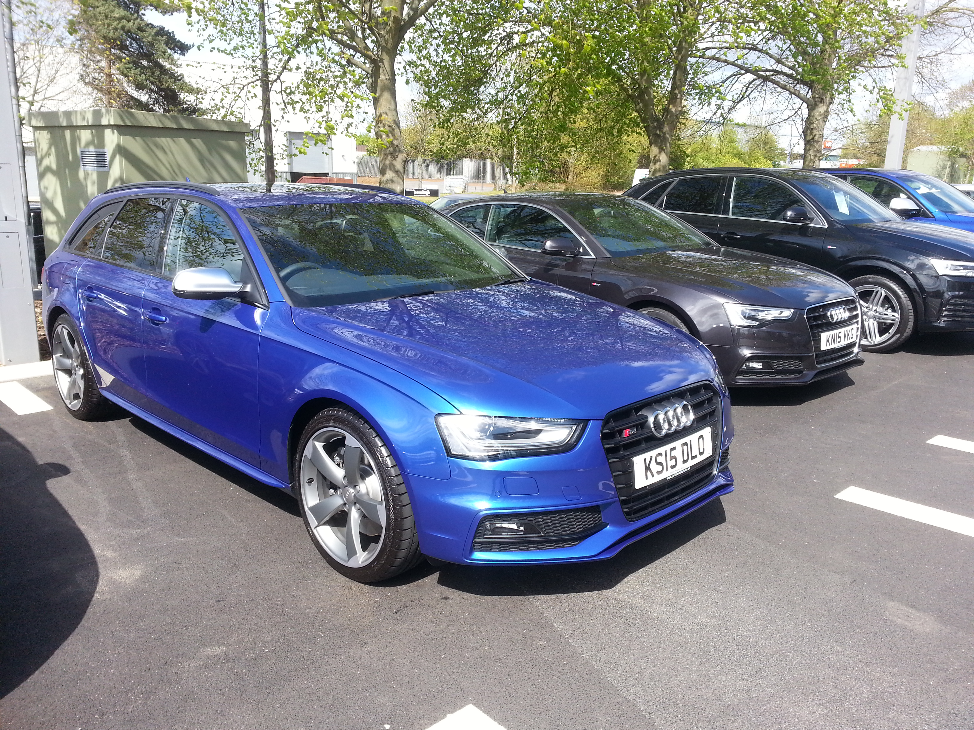

A couple of pics of mine debadged. The dealer removed the rear tailgate and wing badges but could not remove the grille as they did not want to risk damaging it. I have covered it up since with black tape.
