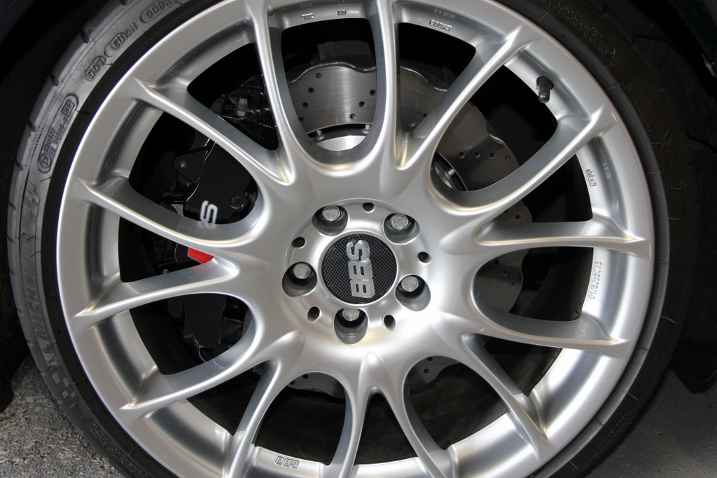

You're running MRC stage 2 aren't you? Given the weight of the S4 and the additional performance you now have I would suggest a front brake system upgrade. The S4's single-piston floating caliper and one-piece disc/rotor just can't dissipate heat quickly enough. Bang per buck I'd recommend the RS5 setup, consisting of bigger 2-piece discs and 8-piston Brembo calipers. It's a straight swap, and whilst expensive is a lot cheaper than most BBKs out there: http://www.ebay.co.uk/itm/Audi-R8-RS5-R ... 0739&rt=nc
I can vouch for these after having just fitted some to mine:
