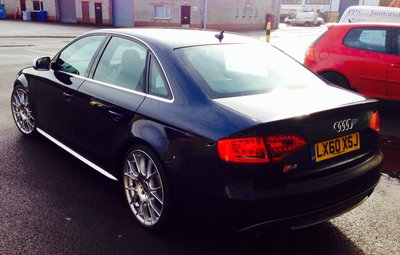

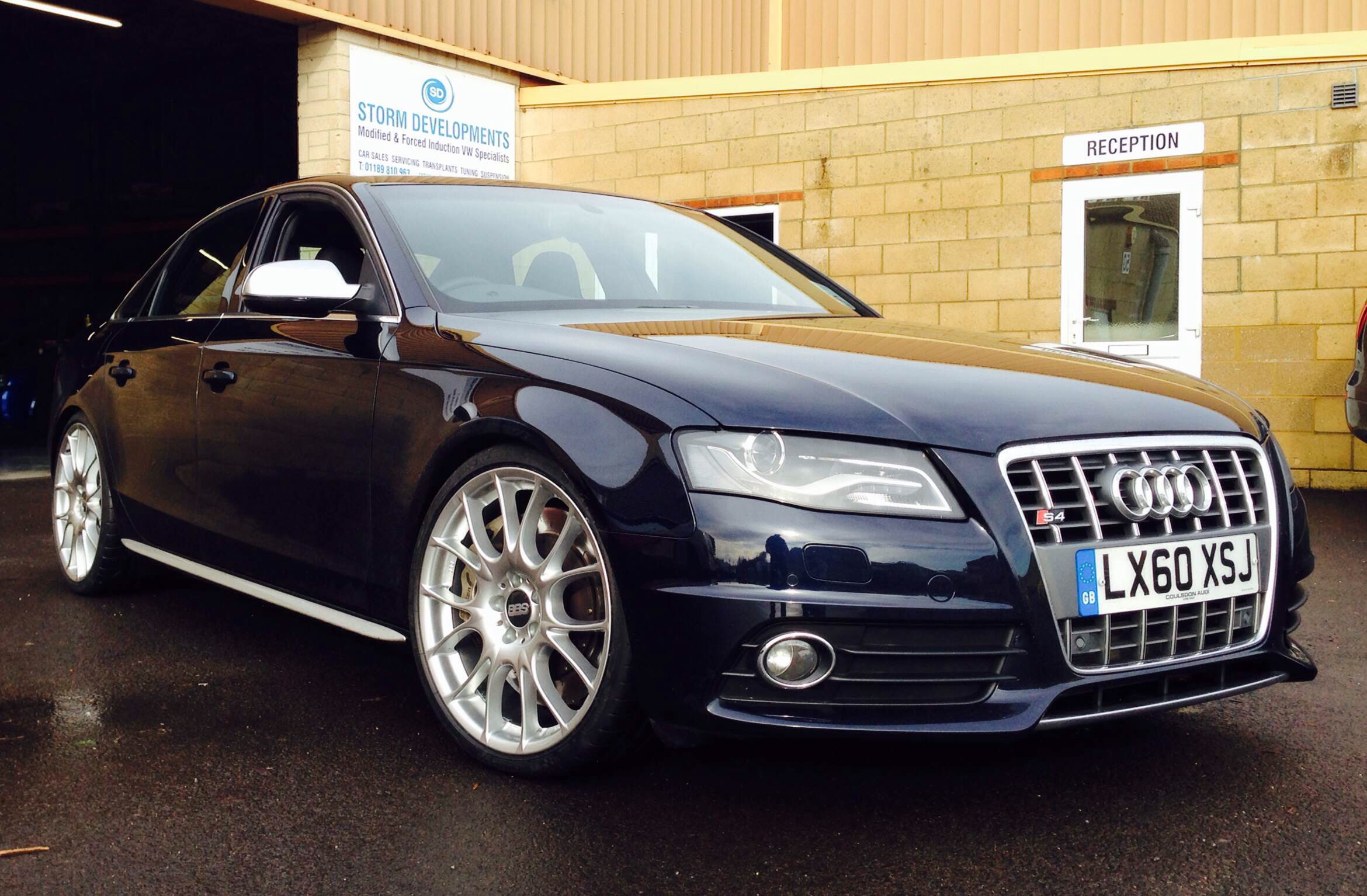

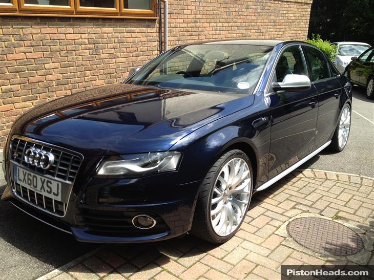

Ditched the STaSIS 19s for some genuine 20x8.5 BBS CKs courtesy of Storm Developments. Slight drop on the coilovers to suit and she's sitting pretty.
BEFORE:
AFTER:
:biggrin2:
For anyone who's interested these wheels are ET38. I'm considering running 10mm hubcentric spacers for the rear as the front wheels seem to sit out further in the arches by around 6mm, same deal with the old wheels, which is normal for B8 S4s so I'm told. Can anyone else confirm that?

fit 6s or 8s looks near spot on to me, cant really tell with the front being turned.
looks good tho, classic choice

Measured the tuck last night and it's 10mm exactly so spacers are a no-go. I'd only ever run a hubcentric and 10's the smallest of those I can find.

ah right, i can only find 5mm
http://www.ebay.co.uk/itm/MERCEDES-5-x- ... 27d7e6a61a
dont look hubcentric but 5mm should let the wheel still sit on the hub

Good point, I think you're right. Next time the wheels' off I'll see if there's enough hub to get away with a 5mm and the wheel still be supported. Cheers!
Thanks for the link too, but just in case anyone else looks and buys those beware that the B8 hubs are 66.6 and those are 66.1, so not quite a perfect fit.
