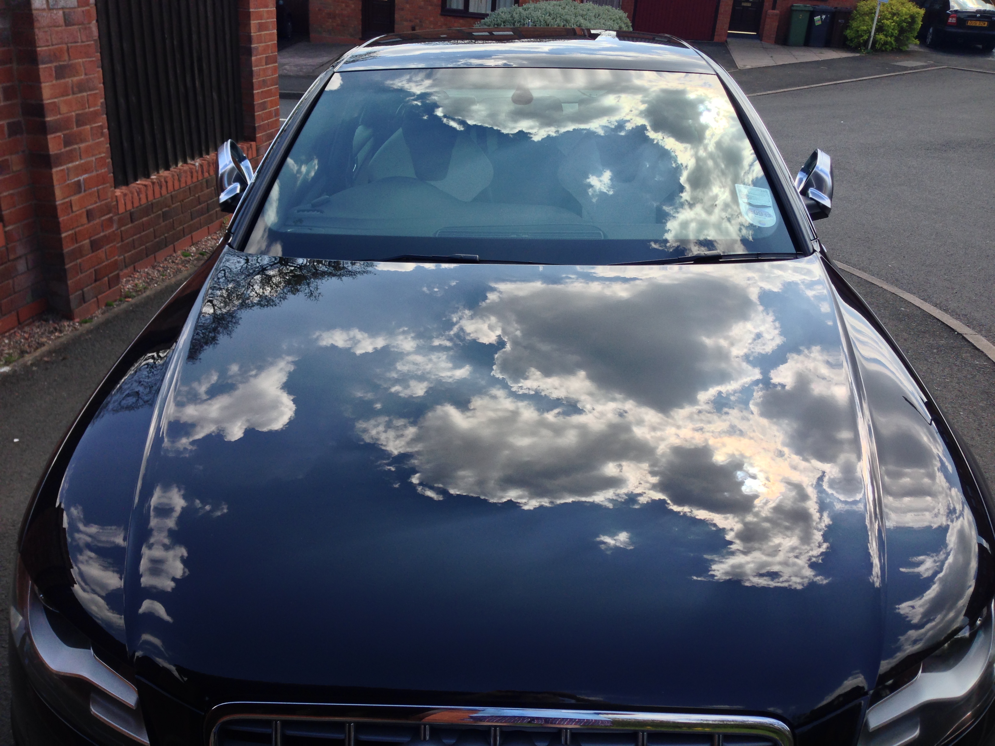

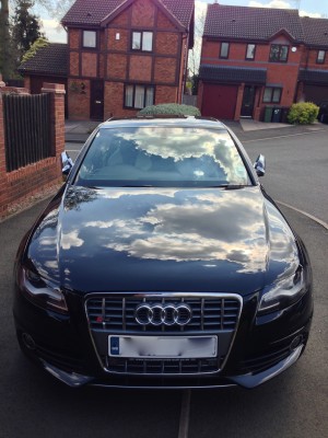

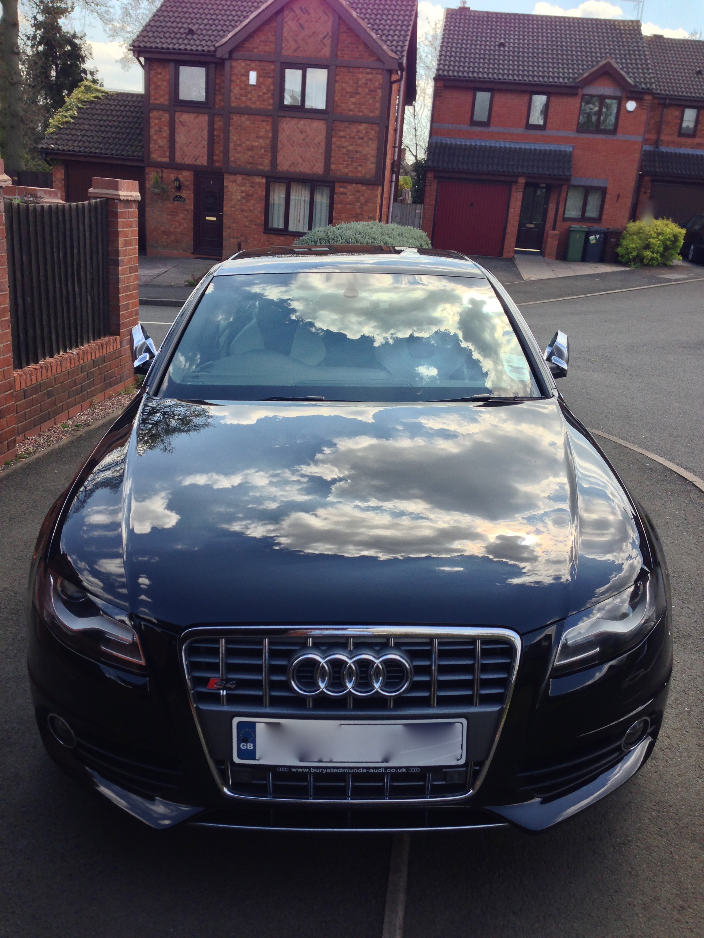

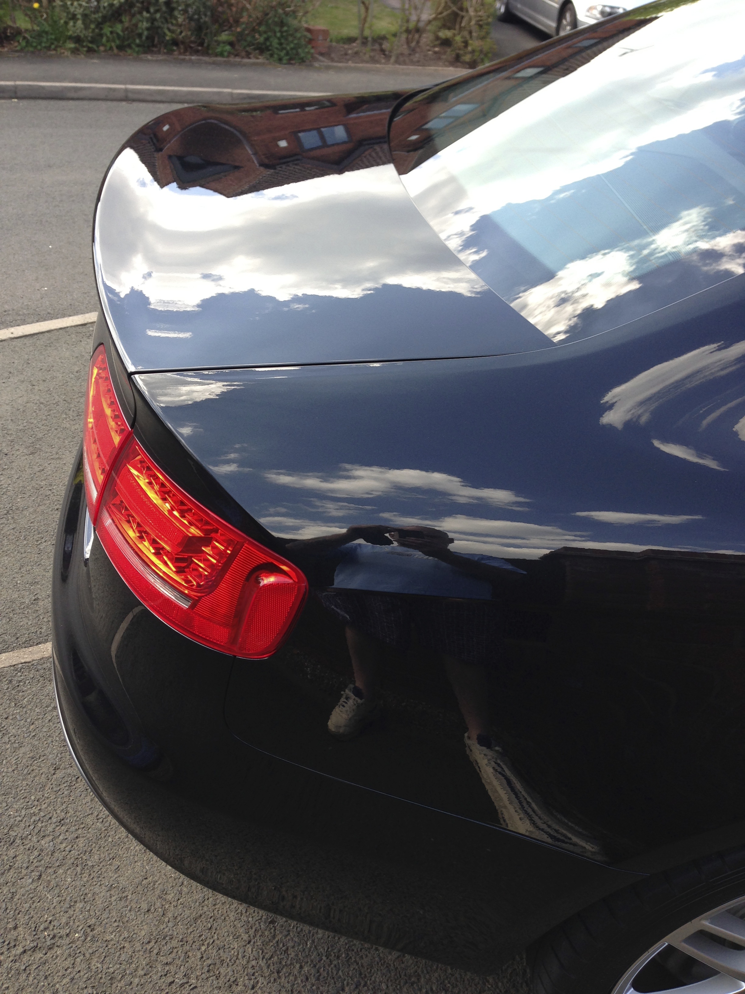

Detailed car on the weekend snapped a few photos on iphone today.

Looks very good. Nightmare to keep that way. I find mine gets covered in dust pretty quickly.

Nice, what did u use?

Nickyboy hope your still enjoying the S5,after detailing the car it had been sat in the garage for two days and there was a layer of dust on it when i took the photos.Mojo i used a da polisher with Meguiars 83 cleaner polish on a polishing pad ,Poorboys black hole glaze on a finishing pad and then a coat of Collinite 915 wax applied by hand with a foam applicator pad.

Love of labour, impressive :lol:
