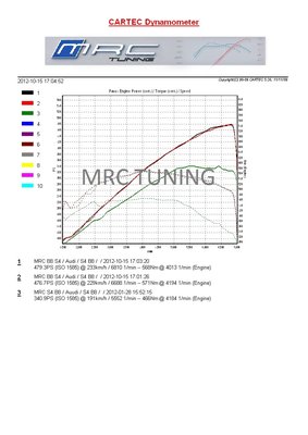

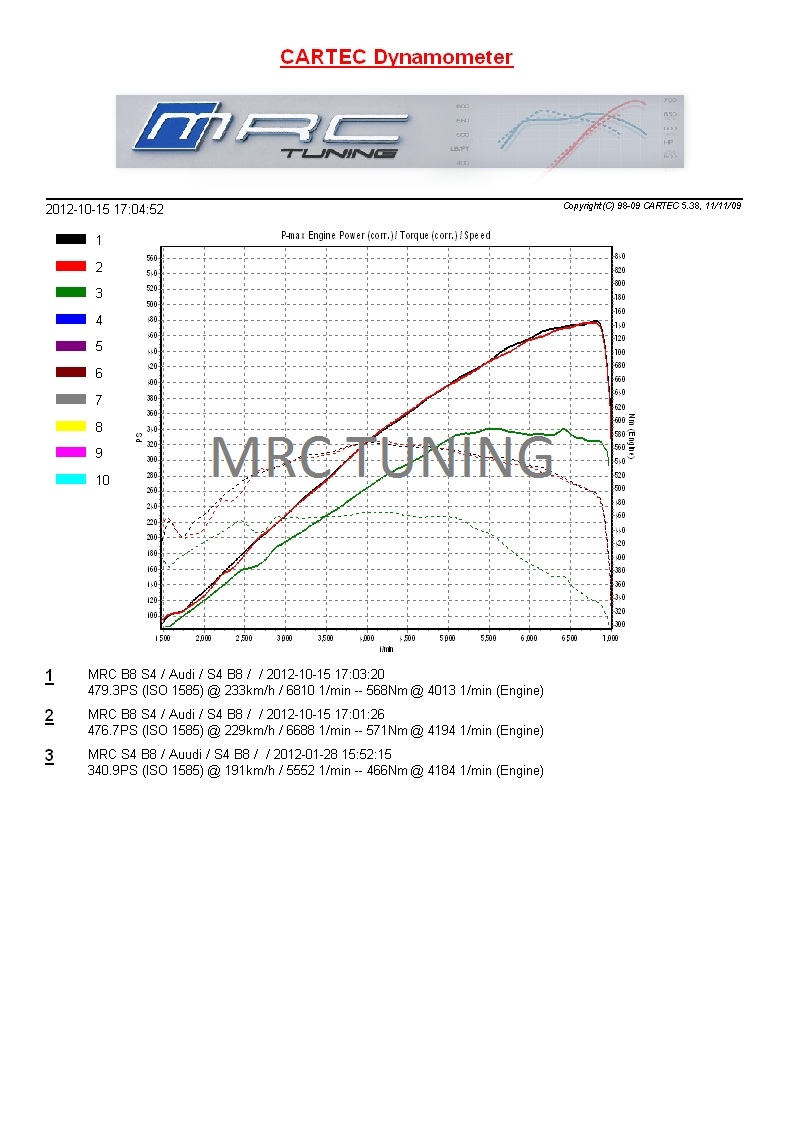

Our S4 B8 at stage2 spec:

Is this now released and ready to purchase and is this "just" software and pulley or does it require cooling mod for SC too?
I was going to opt for you guys on mine though 6 weeks or so ago when I was discussing, the feedback of further upgrade path was not really commited
Suggestion was to go for remap, filter upgrade and be happy.

Bloody good results!

Just a filter and remap should get you 440-460ps, and 540nm.
We have been testing differnet size pulleys and will have finalsied the one we are happy with soon. This will need exhaust, filter, intake pipe (which we are waiting to be finished) and stage2 remap. The cooling mods are optional and will be released later.
