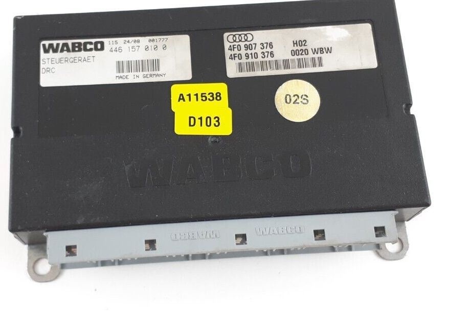

Suspicion fell on the wiring back to J250. We removed J250 which is situated behind the glove box, removed the grey connector and checked all wires for continuity or high resistance as well as shorts on Front right harness. All 5 were good.
That left J250 itself.
We found a marked difference in the waveforms fed to the motors by J250 between the left and right with the ignition on. The signal for the right was very much smaller than that appearing on the left.
The conclusion is that motor drive circuitry in J250 has gone faulty for front right, although it is a mystery why.
If you have this problem buy this connector pair to make life easier when probing https://www.ebay.co.uk/itm/304365739802
Now trying to find someone who can repair J250 or supply a used one!

I have the same problem as yourself, do you have the part number for the module you replaced?Ed Chappell wrote: ↑Sat Aug 31, 2024 7:28 amFinally resolved the problem by replacing the J250 control module with a used one purchased from a German car breaker.

Re: Problems with the Electronically Controlled Damping system on RS6, C6
All you need is in the picture below.
When buying a used one make sure the part number is exactly the same.
If I remember correctly a new one was £650+!
Good luck
