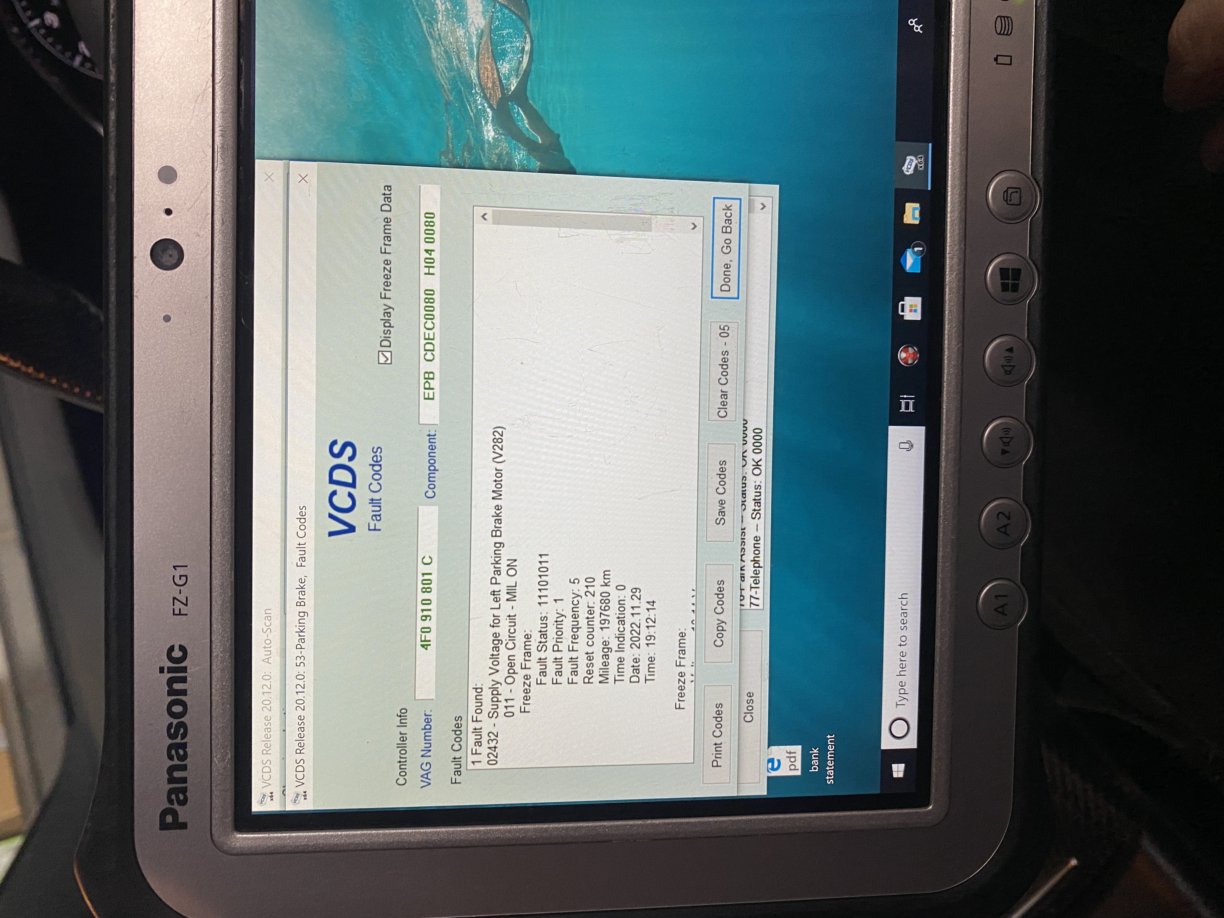

I have just had my first issue and got my pal to plug in with Vagcom.
I have posted the fault code on the picture attached.
I drove the car a few days ago, parked it up in the garage, came out to use it and it won’t release the park brake? Seems to the the passenger side?
Has any one got any ideas of what it could be please?
Thanks👍🏻

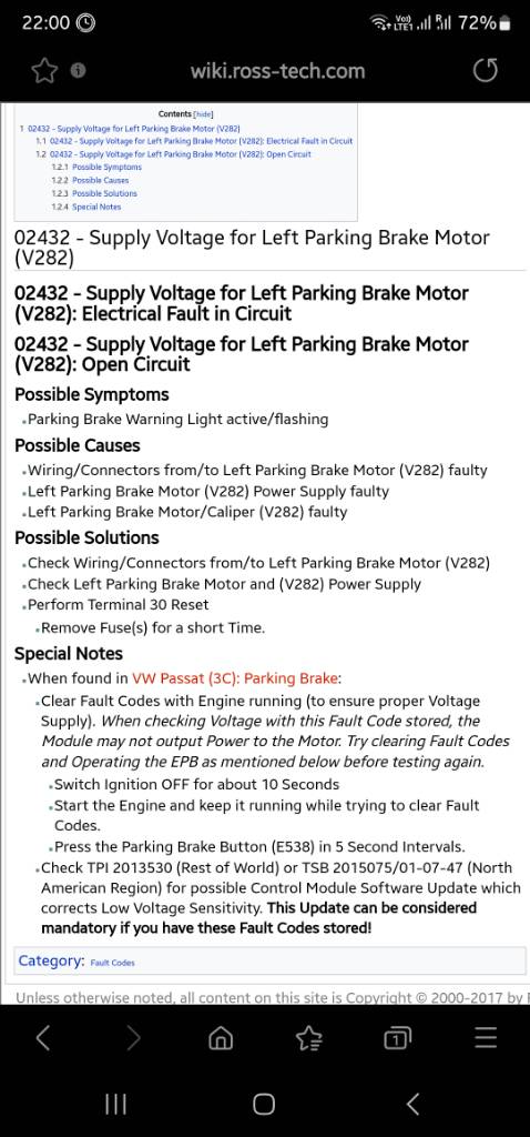

There is something you can do to be able to drive the car apparently. Looks like a wiring issue. But by removing a fuse or erasing the code you could release the handbrake
