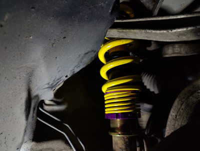

IMO, avoid the spacers if lowering. I had some on there and removed them as the tyre would rub the screws holding the arch liners in and that was at factory height. I think I had 5mm front and maybe 8 on the rear.
Mine with KW springs and camber bushes in the front. That's about as high as the KW springs go. Still rides fine though. Went to the continent with 4 people and gear. No signs of rubbing or bottoming out.

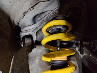

Mine with H&R springs and 10mm H&R spacers all round. Ideal stance in my opinion. Would maybe have it a few mm higher at the back is it was adjustable.ImageImage

Thanks Doug - that looks really good with the added bonus of not being too expensive either. It's probably the route i'll take to make it sit a little better.

It's 100% possible, no need to remove wings. The hardest part is getting the rears out without special Audi spring compressors (at about £800). All I'll say there is that it's easy with the spring in two pieces. I went with the KW adjustable springs, so I was able to set them at their lowest to get them back in without compressors.

I ended up just getting them fitted by someone who could recharge the DRC. I couldn't get the strut low enough to clear the wing with the DRC connected. Your other fight with be the top arm pinch bolt. You may end up having to snap/cut the head off and use two nuts o. The threaded end to pull it out. I then replaced them with stainless bolts.
Re: Lowering springs/spacers
Posted: Wed Oct 12, 2022 1:13 pm
by cammmy
Indeed, I destroyed the tip of a finger trying to get that out. I ended up undoing them from the top mount. I was fitting camber bushes so needed that undoing anyway. I ended up just fitting them using a portable bushing press rather than the big press in the garage. Unfortunately I don't think I have pics during the process. I did contact a couple of places about having them fitted but none responded to me.
