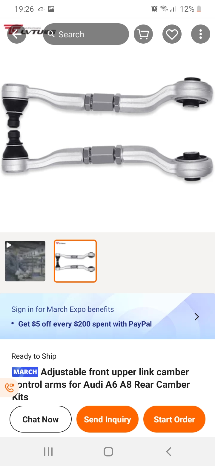

Hello again Ian,
Shouldn't theese do the trick?
Due to my research the c6 chassis have the same link arms.
/Robert
/Robert
Re: Adjustable camber kit
The RS6 bushings are stiffer than the A6/S6 ones so while the arms may be the same between a Rs6 and A6/S6 they are different part numbers because to the different bushings, except for one -
Lower Front Control Arms - Both the same
RS6 - 4F0 407 151 A
A6/S6 - 4F0 407 151 A
Upper Front Control Arms - Different
RS6 - 4E0 407 506 F
A6/S6 - 4E0 407 506 E
Upper Rear Control Arms - Different
RS6 - 4E0 407 509 F
A6/S6 - 4E0 407 510 G
Lower Rear Control Arms - Different
RS6 - 4F0 407 694 K
A6/S6 - 4F0 407 694 H
IIRC as the actual metal arms are the same you could fit A6/S6 parts but the bushings would be softer than normal which might cause other issues but I don't think anyone knows how much softer they are.
As I mentioned above, worst case just buy some A6/S6 ones anyway and give them a go, if they don't work at least we all know then.
As the camber adjustment is in the arms rather using offset bushes, if the bushes aren't up to the job you could replace them with polyurethane.
