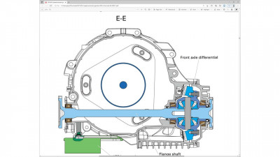

Re: Front Diff Whine.
Download SSP 283 and SSP 284.
Some more...
It's been very slowly building in noise level since I got the car back from Unit20 in September and I haven't been doing anything silly as it's just been too wet/cold constantly where I live for anything other than maybe 2-3 times a month a full throttle run for 5-6 seconds. My guess is that, having been sat static for over 2 years whilst I was stuck in Saudi (COVID rubbish), one of the roller/needle bearings has seized.
Thats perfect, I now have a better idea of what the internals look like. Transfer box - Could be that too but it "sounds" (not the best metric) lkike it's under my feet rather than by the gearstick but it'll need investigating and fixing anyway.

Did you ever investigate this one Ian, or is it one of those jobs you keep putting off?
Be interested to know what you found. AFAIK There are bearings for each drive flange coupling out of the diff, there is a bearing carrying the extended drive shaft on the other side of the bell housing, and there is a large main bearing at the end of the transfer shaft providing the rotation to the front diff. I would guess that if you were particularly dextrous and inventive you could do the first three in situ with some pain, but you would need the box out for the last one
