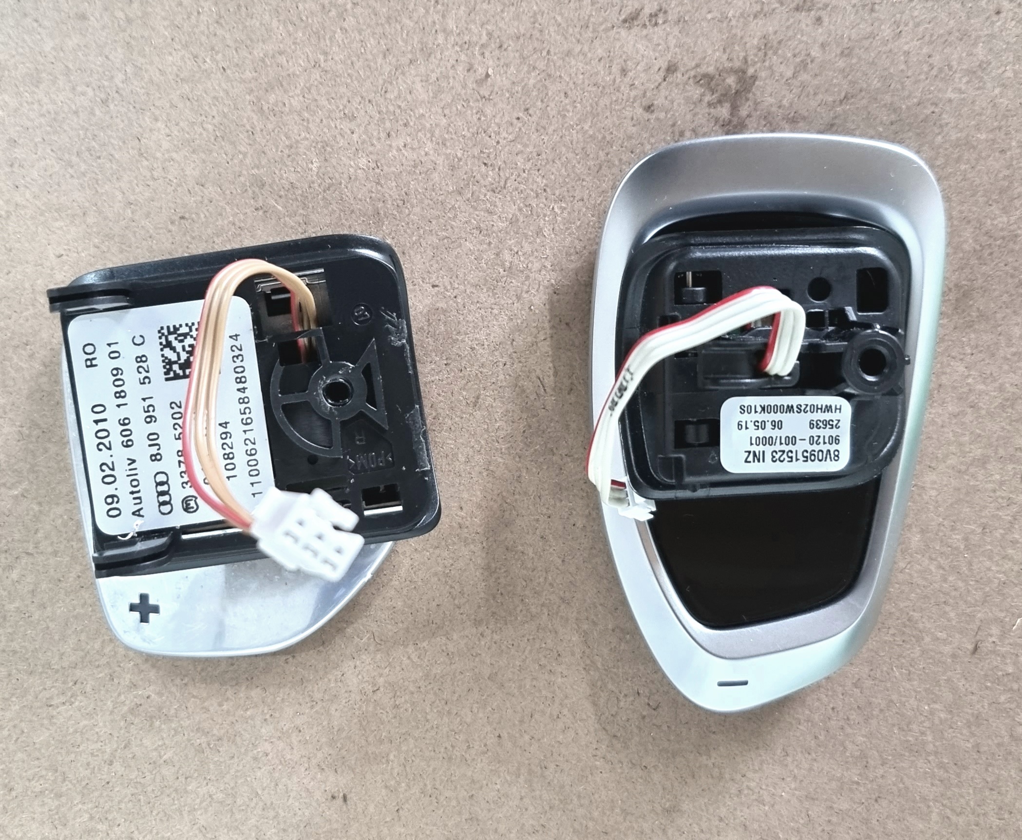

Can anyone confirm is the full replacement paddles for later DSG VAG stuff will fit on the C6 RS6?
I would like bigger, more useable paddles but I don't want the stick on ones. I've seen ones that replace the full paddle.

Unfortunately I can confirm that the later DSG type paddles DON'T fit, the mounting bracket is completely different and even if adapted somehow it wouldn't fit flush.
