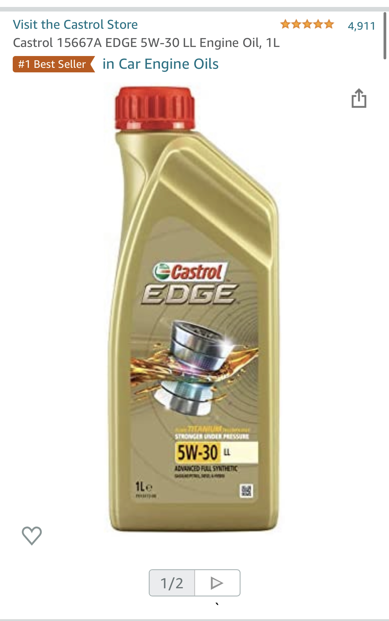

I use this one for top ups

Is that 504/507?

Post by grahamh84 » Sat Apr 17, 2021 4:20 pm
Castrol 15667A EDGE 5W-30 LL Engine Oil, 1L
VW 504 00/ 507 00
Caino6
Posts: 35
Joined: Sat Dec 26, 2020 11:19 pm
Re: Oil specification
Post by Caino6 » Sat Apr 17, 2021 4:24 pm
Lovely stuff, thank you very much, I have only had it just over a month so still getting used to everything as I’m very new to these, the service isn’t due until July, I will carry it out myself, I hear they have an interesting drain bung set up consisting of up to 5 drain bungs depending on the year of it?? Haha
