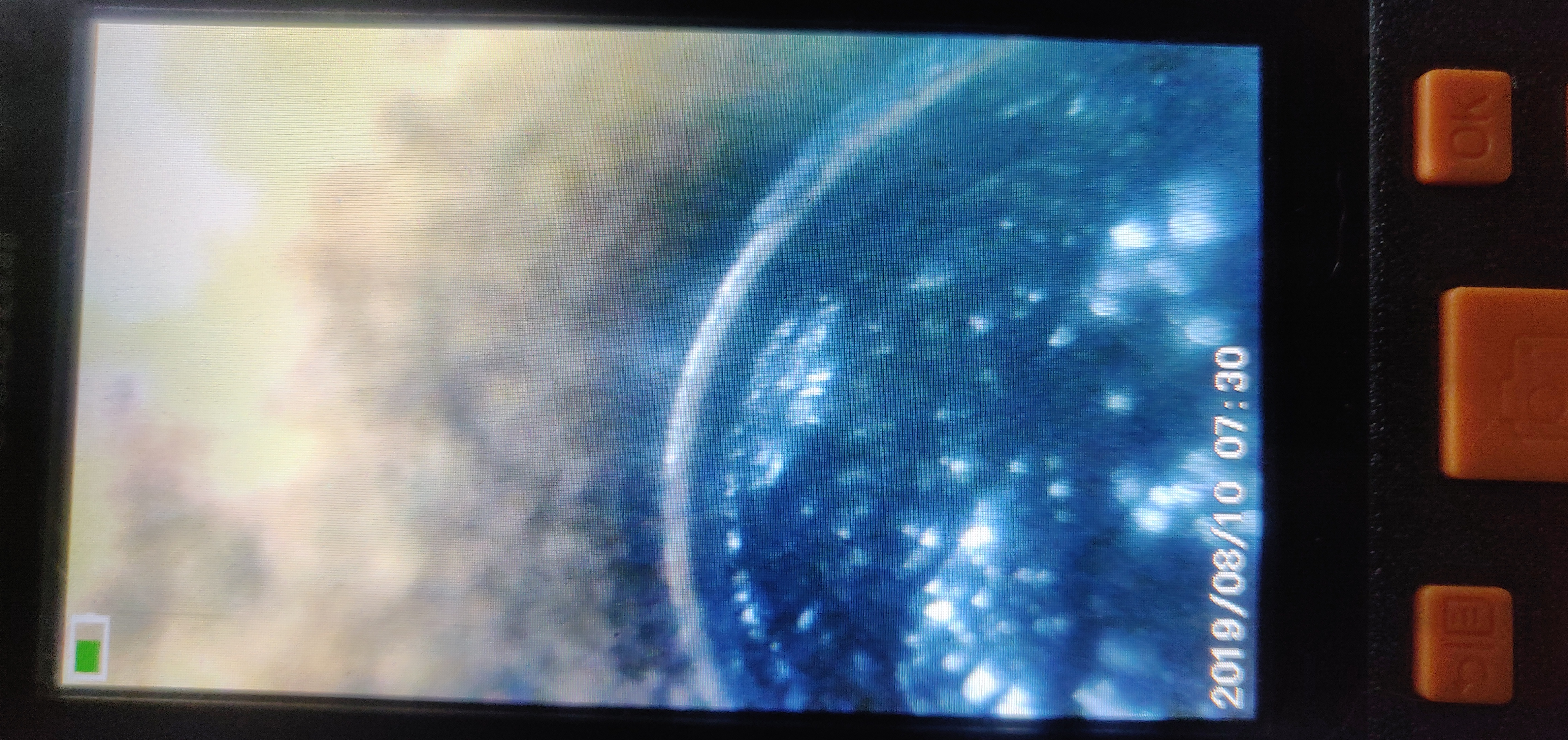

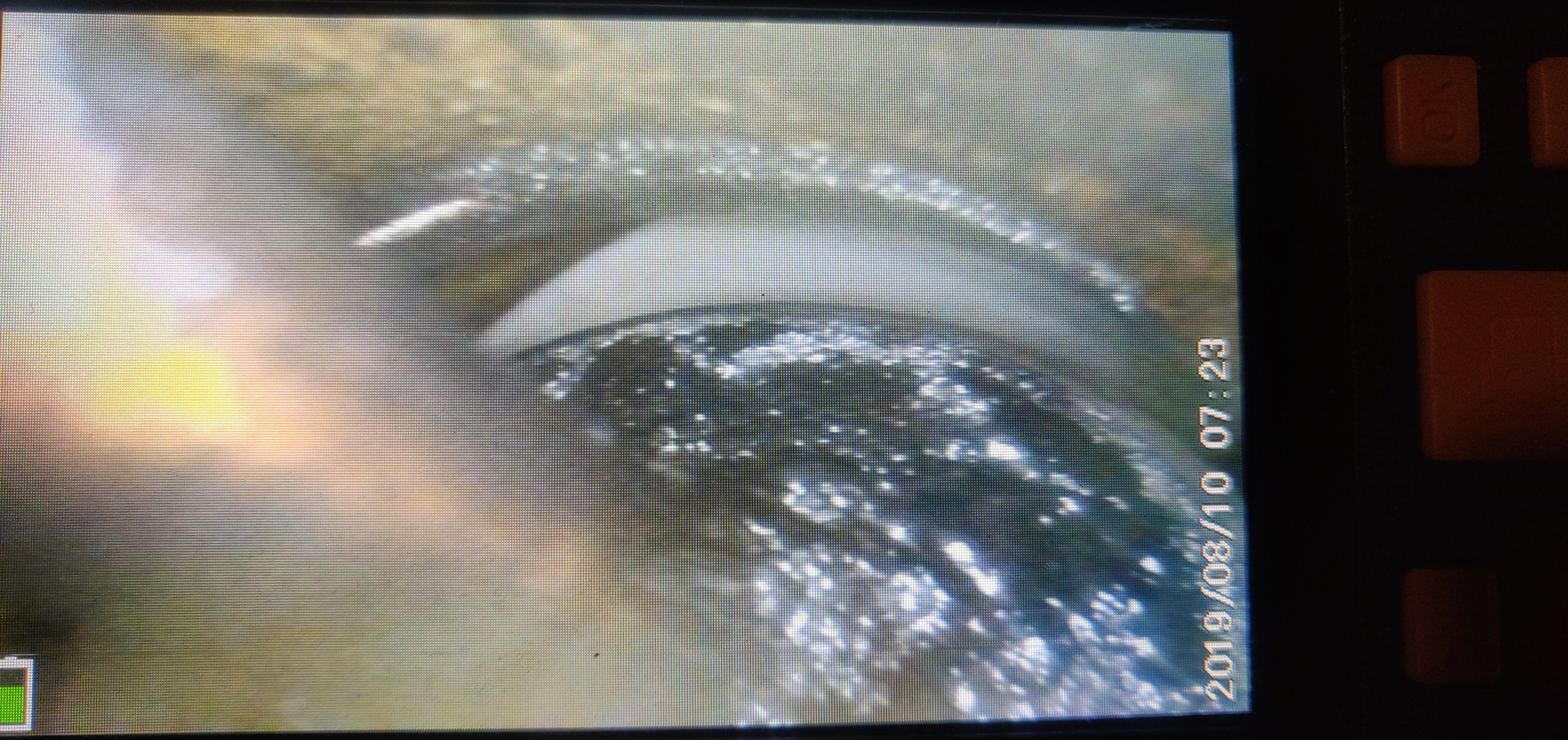

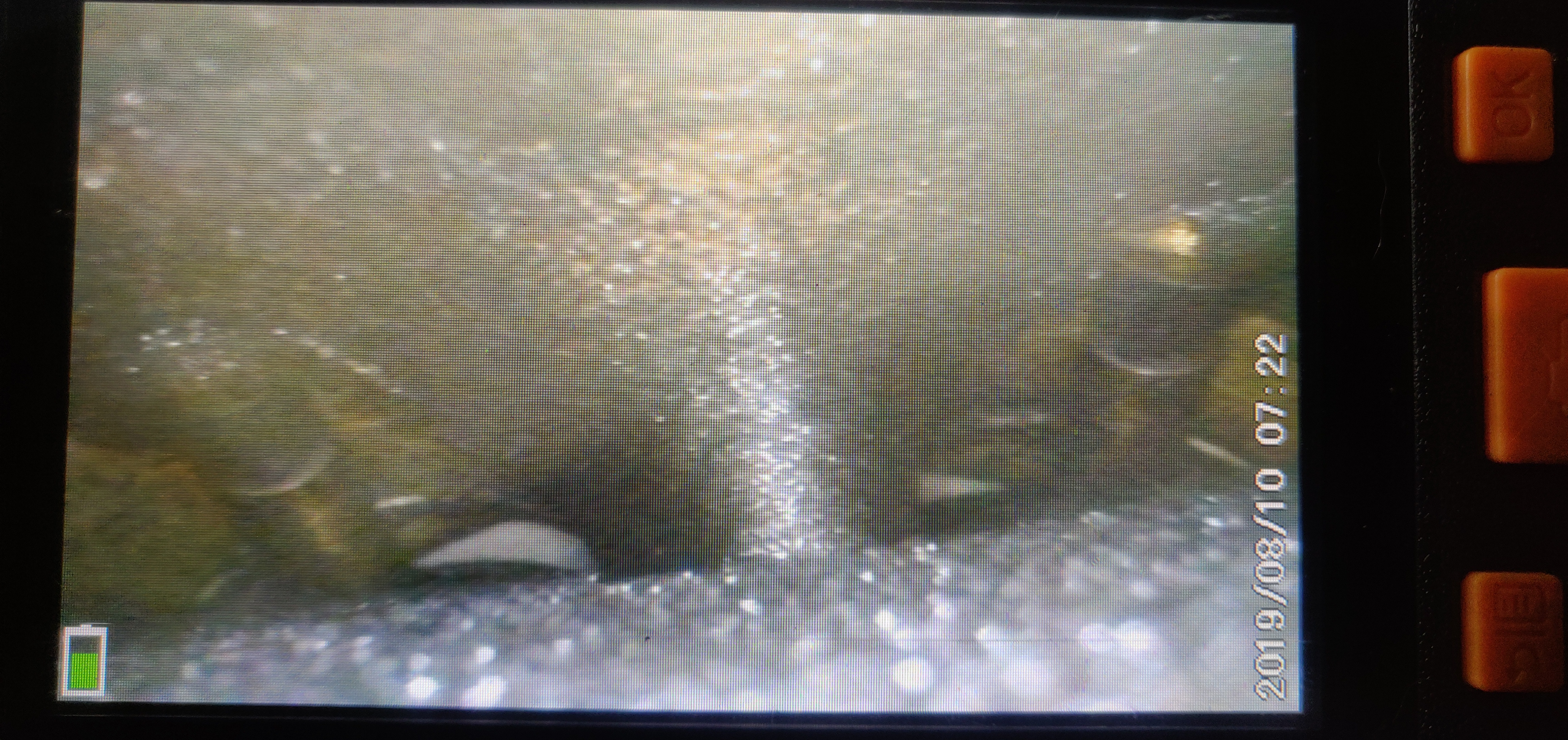

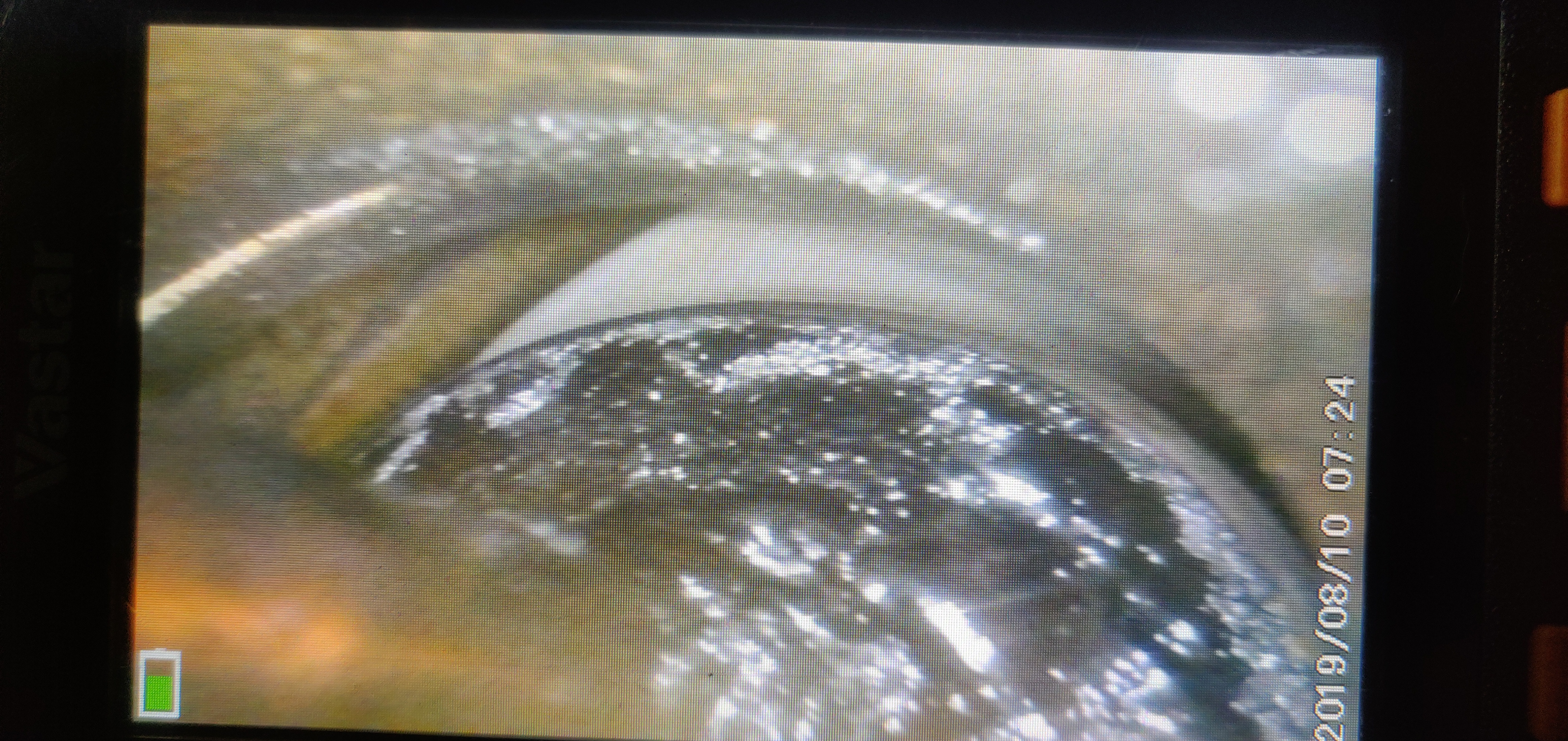

Hi All, I know there are various discussions about this, so I figured I may as well put the bore scope to work.
I noticed in the workshop manual that removing the intake isn't a big job and also that all the replacement gaskets are only £20. Since I have an air compressor, I figured I may as well look at doing my own walnut blasting.
I just popped off one of the throttle bodies and stuck the scope down the ports I could get it into. As you can see, it's not terrible but there is definitely build up. I may do the job anyway as there are lumps in there that I wouldn't want to send through the cylinder . The car has about 90k miles and I don't have any record of this job ever being done before.

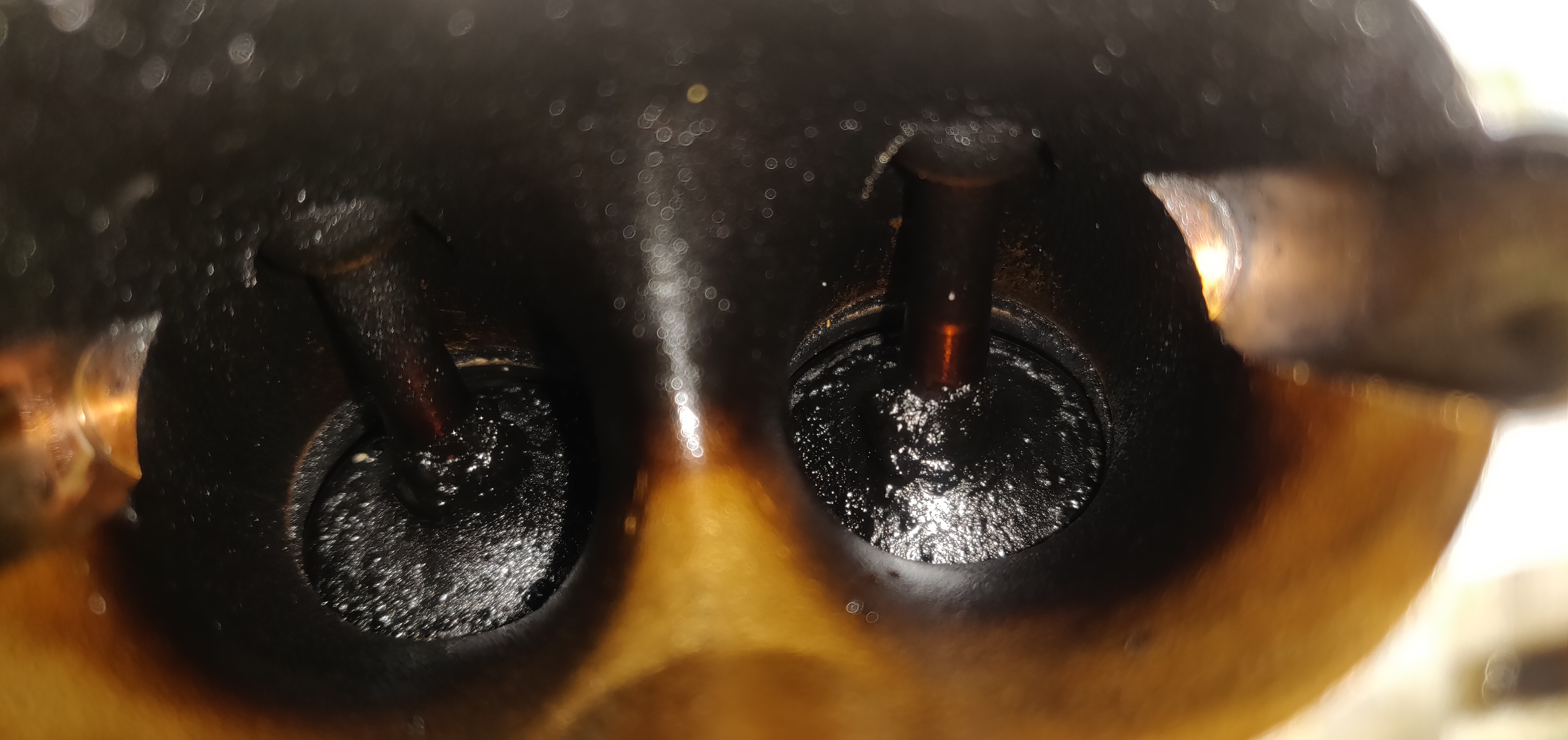

Similar to mine at 96k miles, the Forced Induction from the turbos keeps the back of the valves way cleaner than the RS4 and other none-FI cars but eventually you'll get some sticking.
MRC did mine and this is what mine looked like before and after -

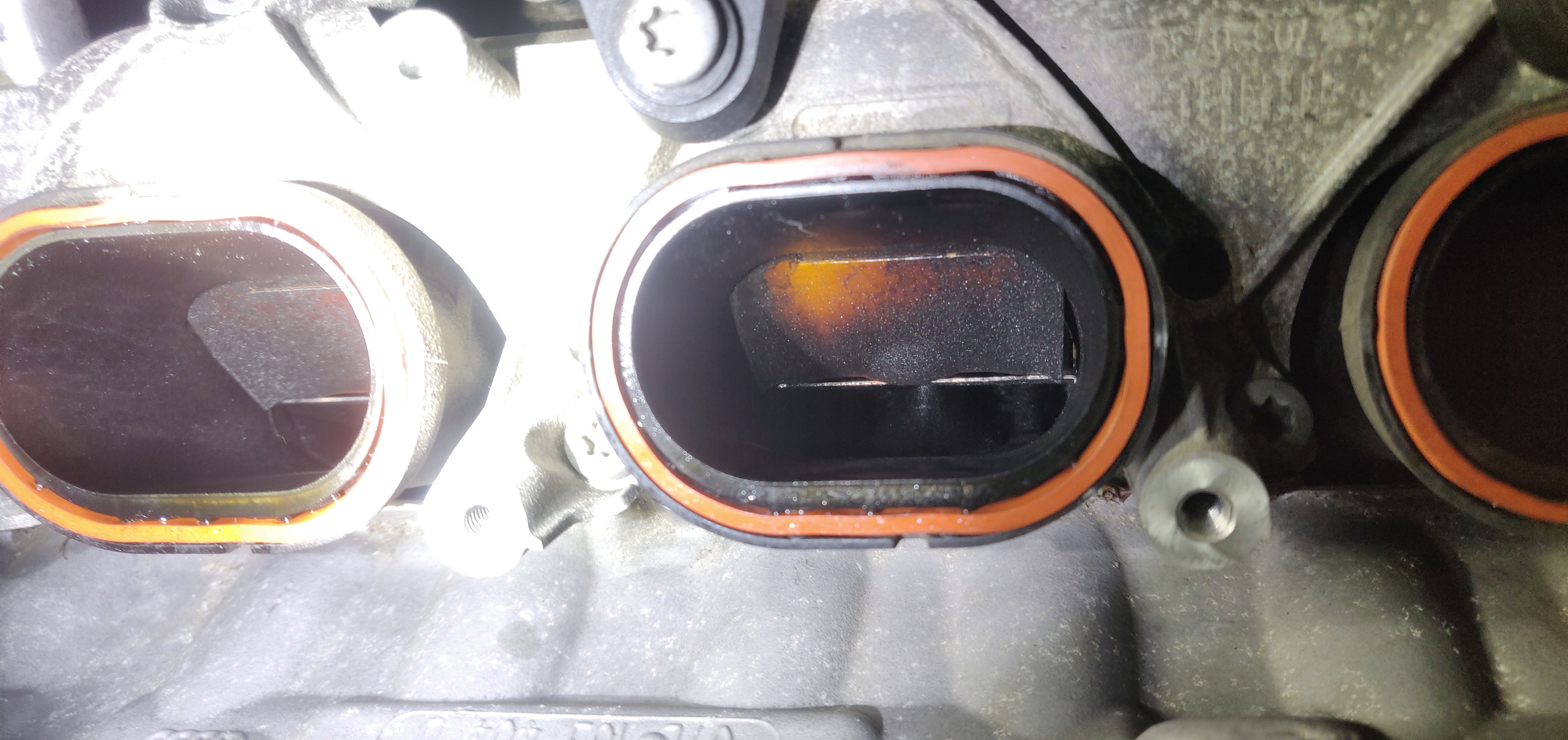

To answer my own question. The flaps are in the lower manifold, not the upper.

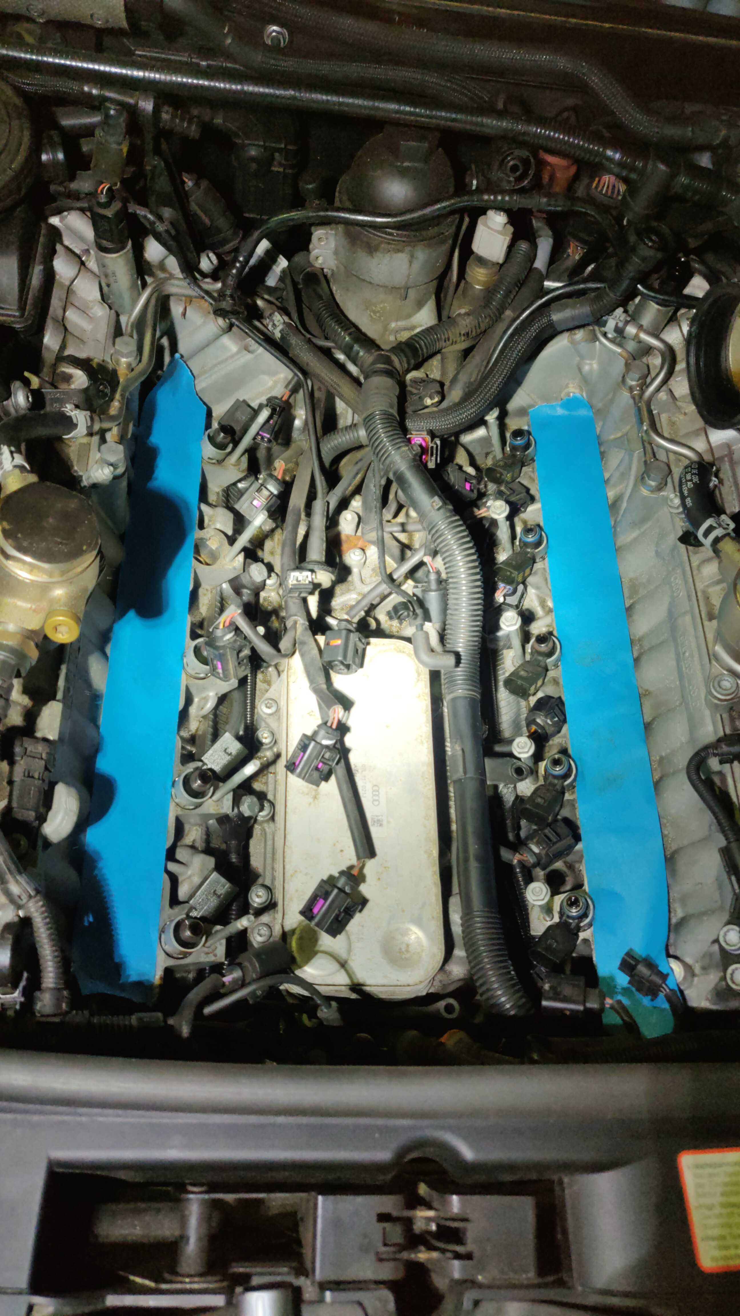

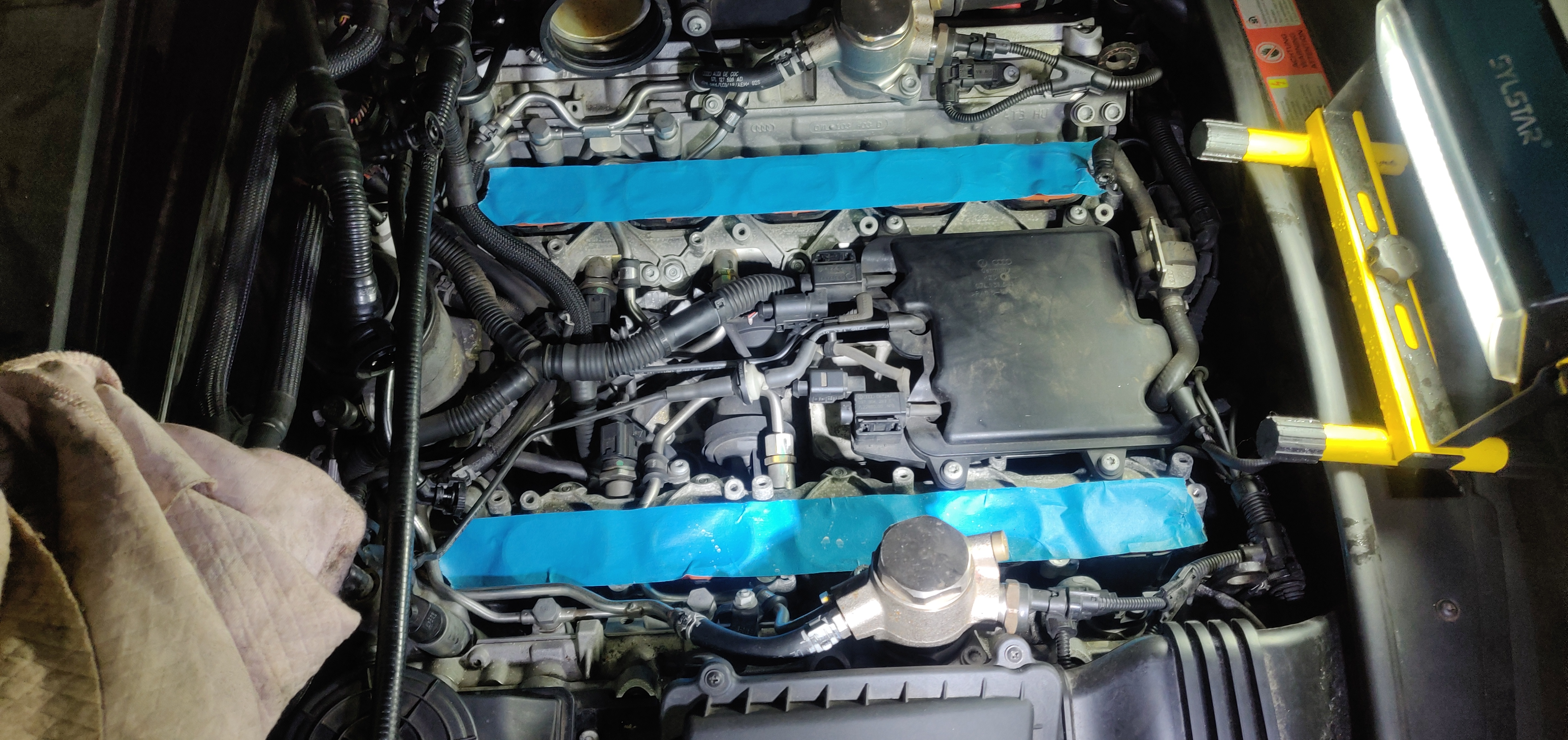

Step one of operation "I should have left this alone" complete:
The hoses at the back were a pain to get off the manifold.
Looks like the lower manifold has to come off as well. If the injectors are easy to get out after that, I might send them off for a service since I'm in there anyway.

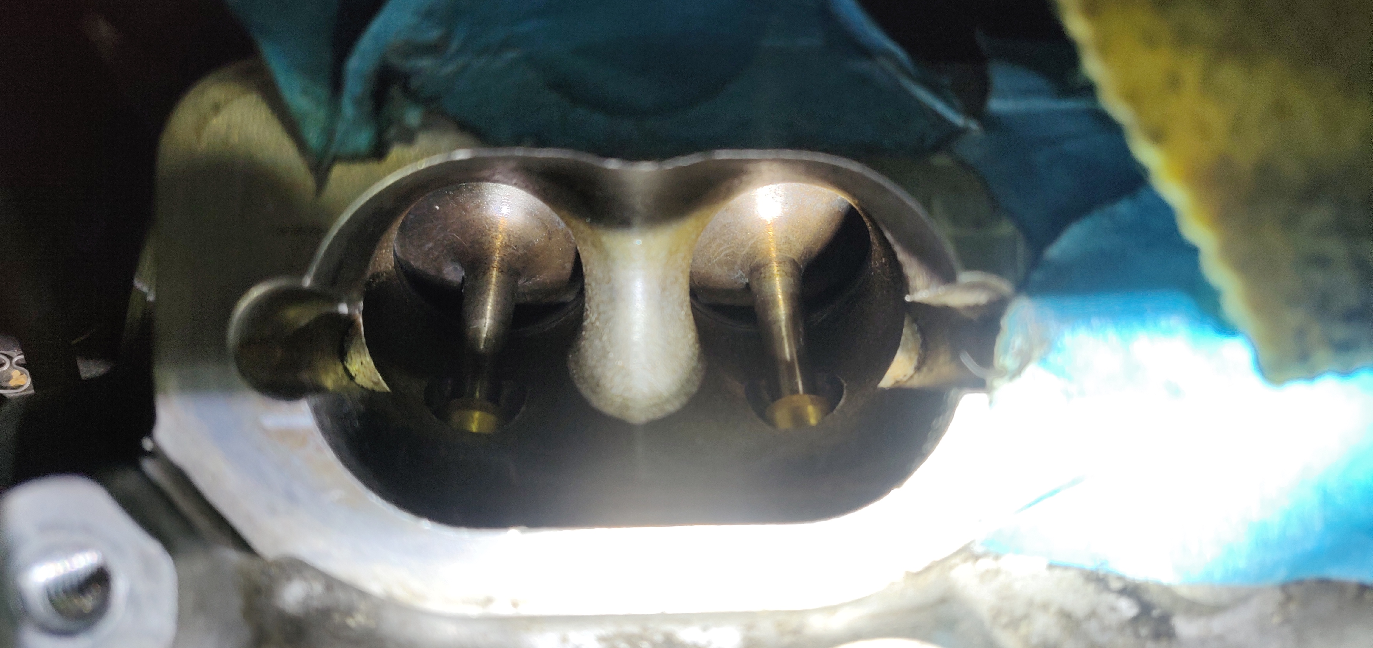

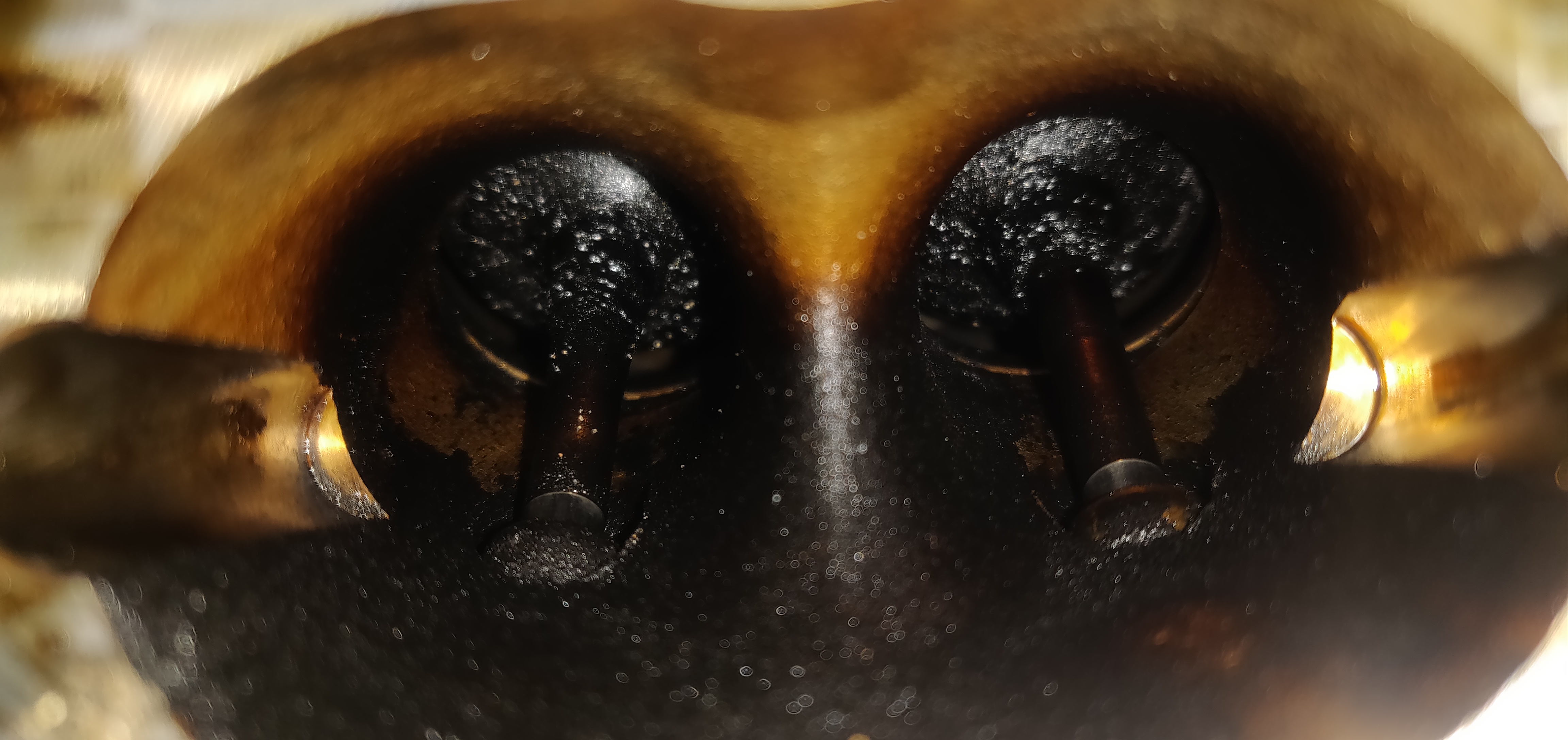

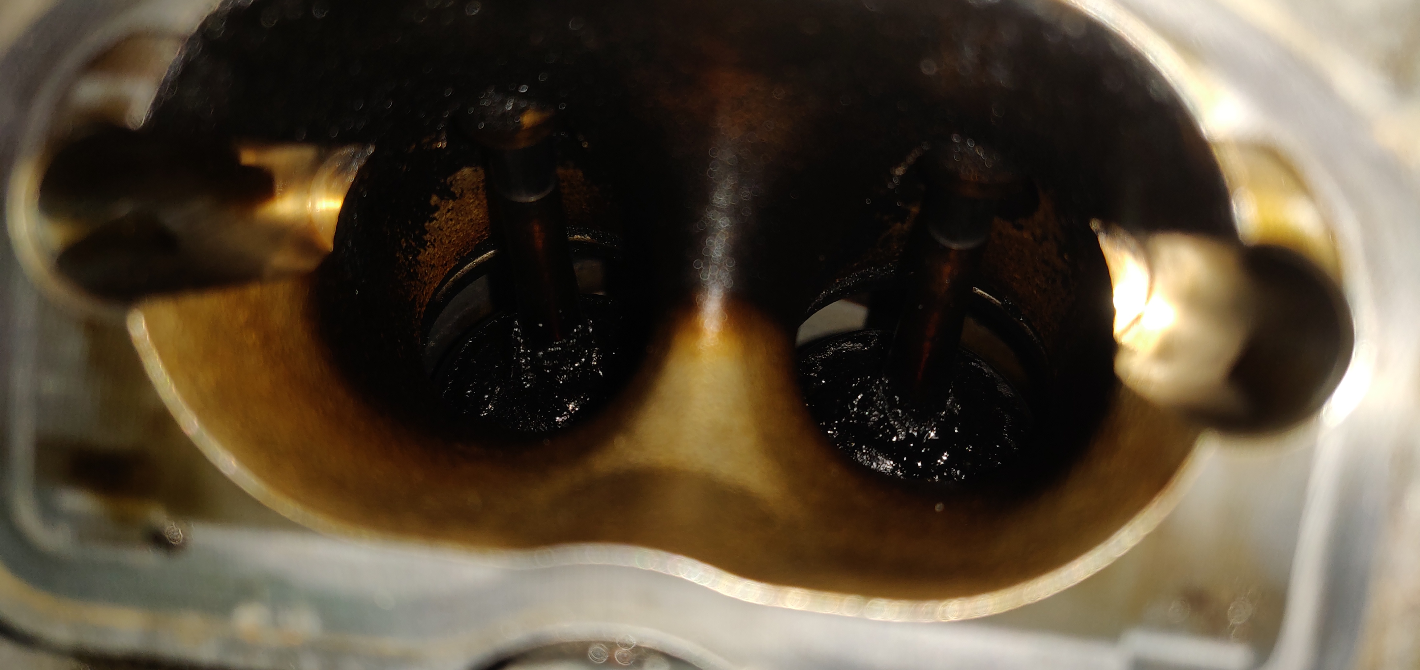

So, to use the port adapter you really need an extra long blasting tip that you can get down into the port and aim. They only seem to be available from the states. Otherwise, you end up getting the walnut shells everywhere. I'm waiting on some brass pipe brushes to arrive so I can get around the back of the valve and the very edges a bit better but here's the first one.

Well, all done. Haven't driven it yet but I pulled the battery to clear any trim on the fuel table and it's immediately smoother on cold start. I need to play musical cars tomorrow to get it out for a drive.
All in all, not the worst job but you need to be careful and methodical. I can see why it costs £450. I spent about £100 on gaskets and it would probably be most of a day even with experience and all the tools to hand.
