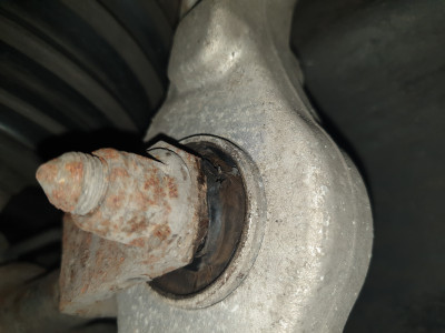

I've got a fairly significant judder, which isn't consistent. It's on light to medium braking, but braking hard is fine... making me think it's not warped discs. Also seemed worse when going uphill... making me think its a steering geometry thing.
Front brakes are arp calipers and discs (done by previous owner),
I've seen some posts on here pointing to issues caused by front suspension arm bushes, so I got it on the ramp today to take a look. This is the only slightly dodgy looking g Bush on the rhs lower arm, what do you all think, could it just be this?
Opinions on brake judder please...

Thanks, I've tried this a couple of times now and it's slightly better, but the judder is still there when braking from more than about 60mph. How violent is it normally when you've had this? As mine is to the point where the steering wheel shakes.
Re: Opinions on brake judder please...
If rebedding didn't work after the first attempt (7-10 hard brakes) then it's definitely not uneven pad transfer so, now you've done the Free diagnostics to confirm whether it's still the same, and it is, you can be sure it's a knackered arm bushing which is going to cost money to fix.
Personally I'm a fan of the Meyle HD suspension arm kits but, as they replace all the arms, it's far more expensive than replacing a single arm (still cheaper than Audi OEM) but Lemforder are pretty cheap but still good quality.
