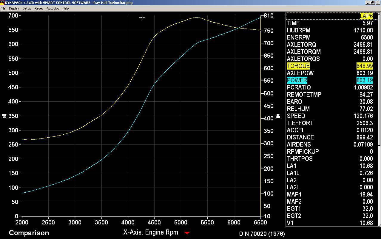

I have the 5.0L V10 BUH engine fitted to a Ultima Evolution. The engine is stock except for the direct injectors are not used and port injectors fitted. The turbochargers are Garrett GTX3071R Gen II. The engine makes 803 HP at the wheels at 22 psi boost. Here is the dyno chart. I have damaged two pistons and bores from detonation. Not from the tune, incorrect fuel in the tank. I rev the engine to 7000 rpm. I am considering fitting iron selves to the bores and forged pistons. Is this necessary at this power level or just make sure the correct fuel is used.

Th BUH internals are pretty strong so while you can rebuild with forged if you wanted it isn't necessary for the power level you're currently running which is almost identical wheel HP to my car (802hp vs 803hp). I'd suggest anything north of 1100hp Flywheel is were you "need" to be forged with anything 1000-1100hp Flywheel advised but not essential and anything below 1000hp not needed.
One thing I would point out looking at your dyno chart is that Garret turbo's you're using seem quite laggy in comparison to the more recent ones designed specifically for the RS6/BUH like the TTE 1000 etc, which hit full boost around 1000rpm sooner than the GTX3071R does, make the same power/torque figures but do so with a more linear delivery.

Yes the turbochargers are a little big. They would be better with a smaller A/R turbine housings. I have had enough traction problems and do not need a big hit at lower rpm.IanH755 wrote: ↑Wed Jul 15, 2020 11:59 amHi Ray,
