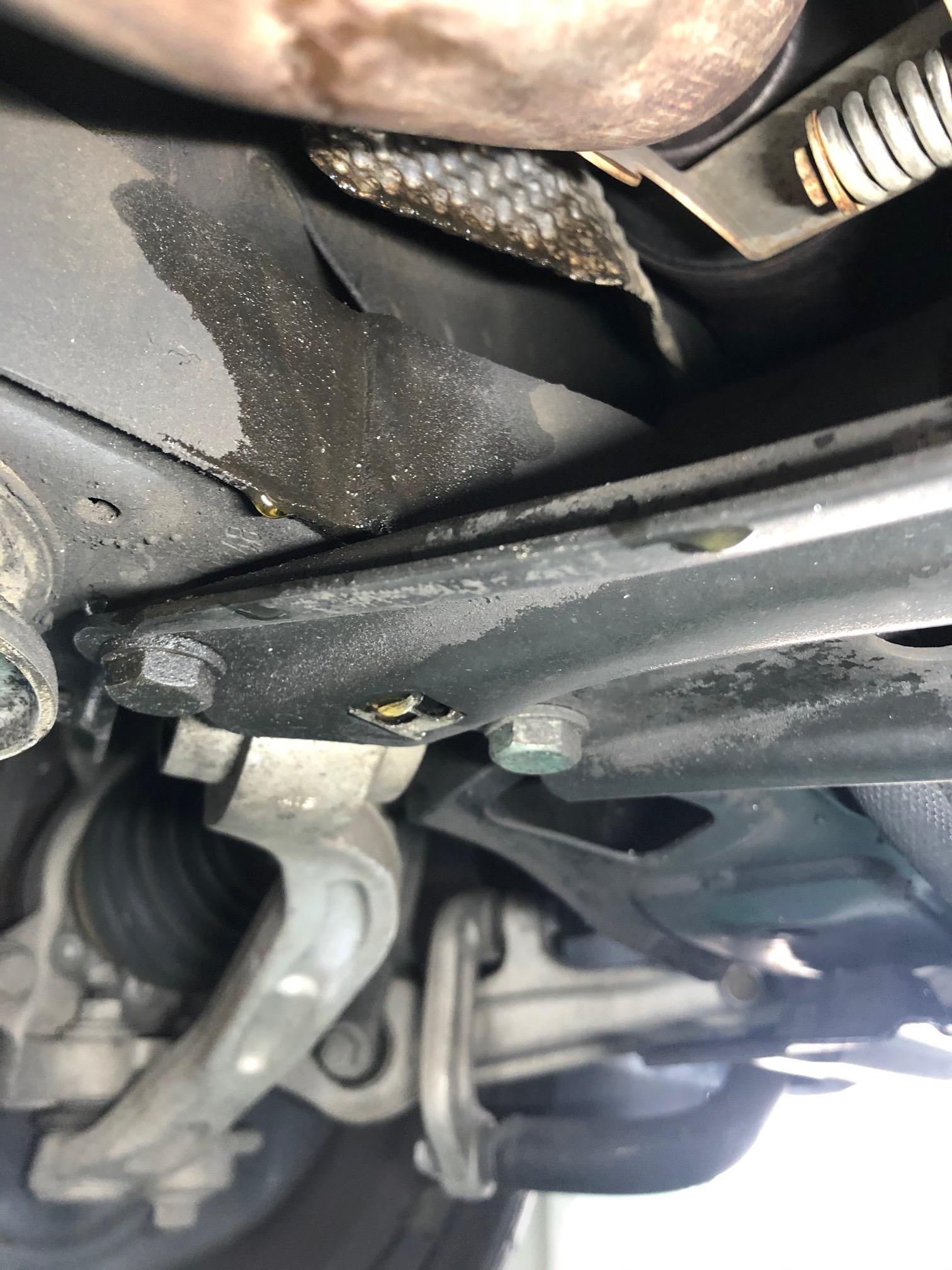

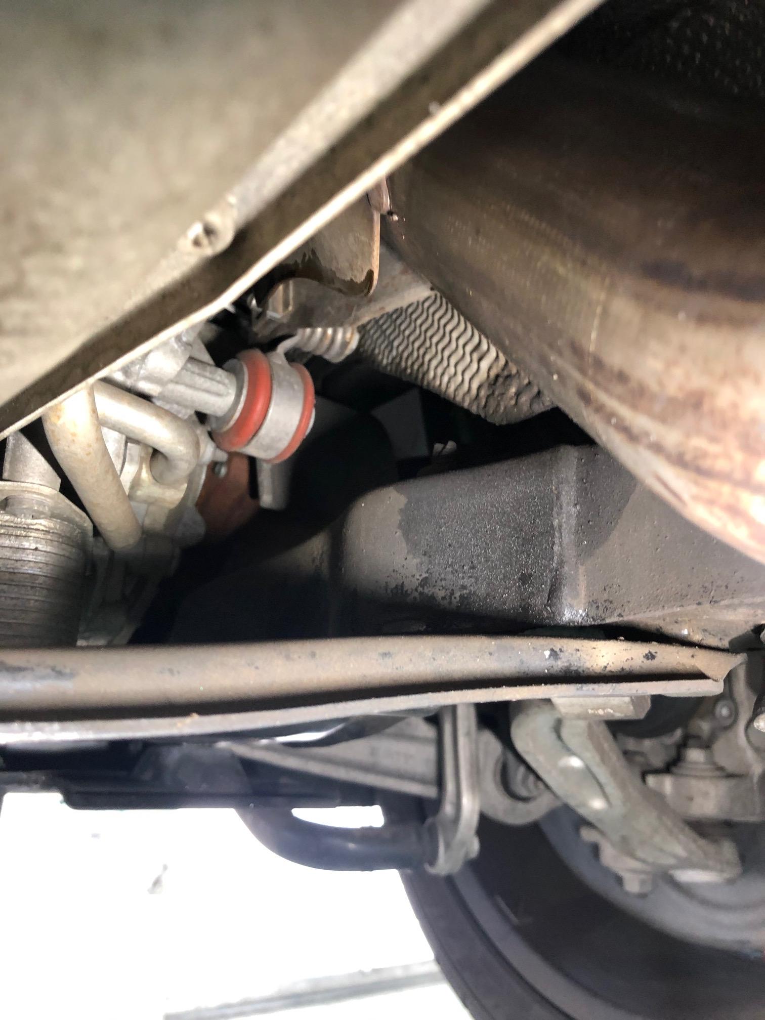

Was doing my brakes and discovered another drip. This one seems to be going a lot faster than the oil seal one. Any advice on what it could be? Left side of the engine, but doesn’t seem to be the oil seal anymore. Some pics:

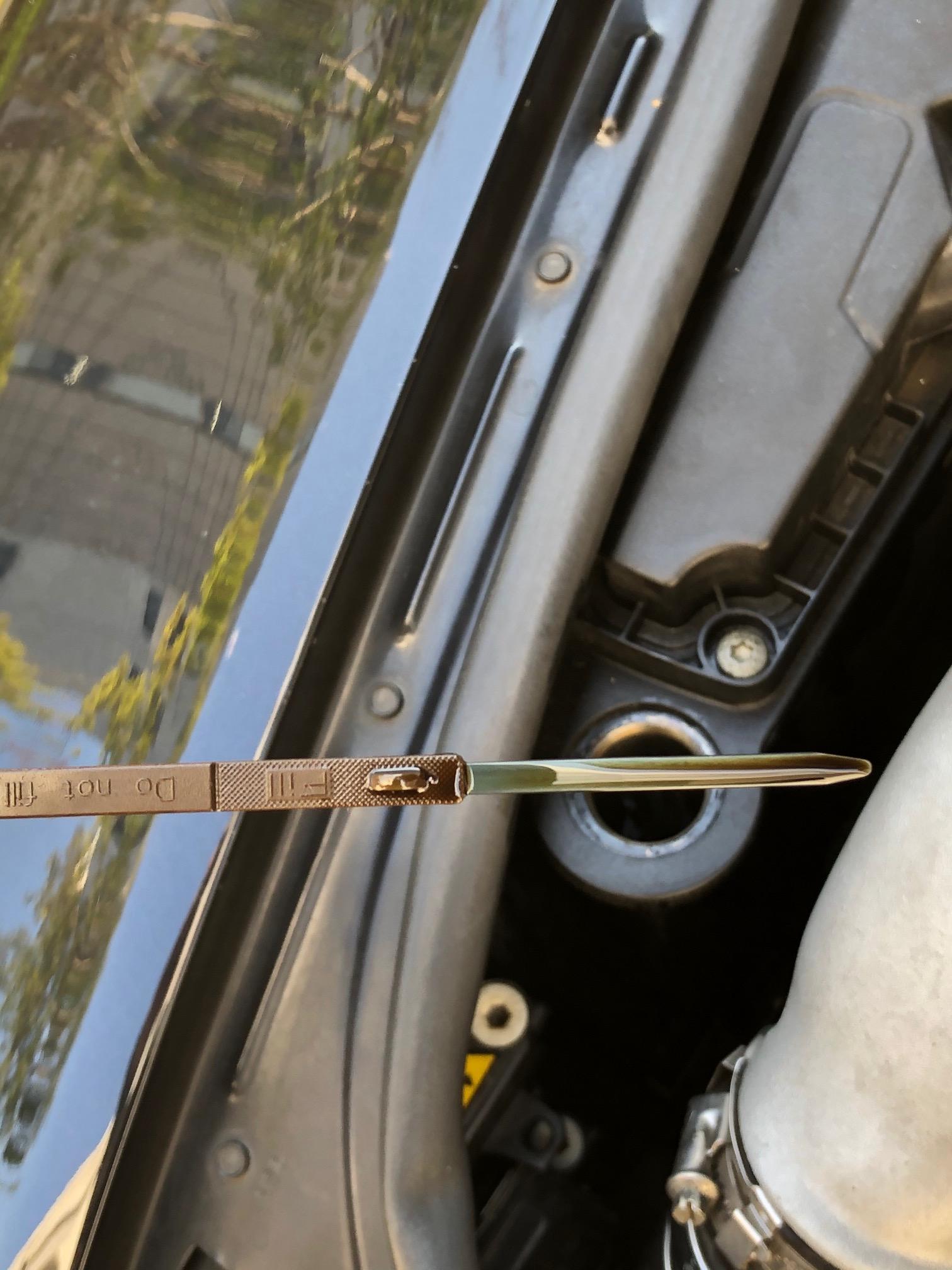

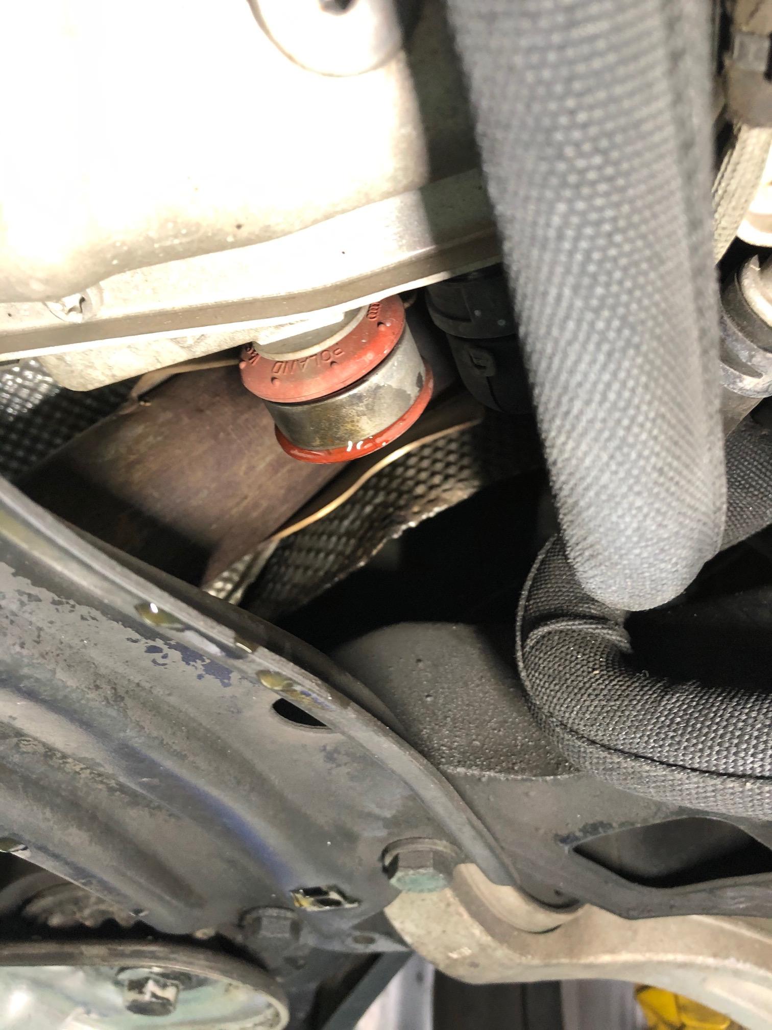

Almost looks like it's coming from that red thing, but I guess that's not likely. Right side of the car also seems to have some funkiness, but it's not nearly as "fresh" as the left side. Oil level after idling the car for 1 min, turning off engine and waiting 4 mins:

The 'red thing' is the bush for the downpipe bracket. Any idea how the oil seal was done - engine in or engine out? Refitting things like the turbo oil return pipes is extremely difficult with the engine in the car, especially if they were removed from the pump and turbos - it's easy to miss one or more of the multitude of clips, I missed one which luckily I spotted when checking the job. And the position of the oil on the body is just about in line with the turbos. There are of course other places it could be leaking from but most (like the cam end caps or the rocker covers) don't have the pressure behind them for the oil to do anything other than just weep down the block.

On the left side, other than the LH Turbo oil extractor pipe, there's nothing high up on the block with oil in it other than the rocker cover seal and thats usually a tiny seep rather than a big dripping leak. Everything else on the LH side of the engine is on the bottom (oil pump).

No, not the turbo seals, the oil return pipe between the turbo and the oil pump. There's a metal pipe attached to the turbo then a rubber one from there to the oil pump (near the back on the left side of the pump). Rubber pipe is attached with spring 'ear' clips which aren't easy to reach or fit - the upper (turbo) end is particularly awkward to get to.
If the turbo seals leak the oil ends up in either the intercooler pipe or the exhaust. Or more usually both.
There's also a possibility that it's actually hydraulic oil from the power steering - the pump is around that area if I recall and there's a metal pipe that has to be removed as part of the 50p oil seal R&R job. Through that oil is a slightly different colour from engine oil and usually has a distinctive (and rather offensive) smell.
