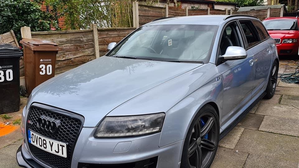

Here’s a pic

Also when I first saw it thought it was like a moon dust silver colour
When we went to view it it’s actually light blue
Very very nice colour
Going to be taking the front lip spoiler off as I don’t like it and there’s some film type <beep> on the headlights and rear lights which will be coming off ASAP
