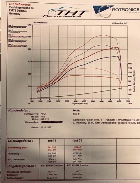

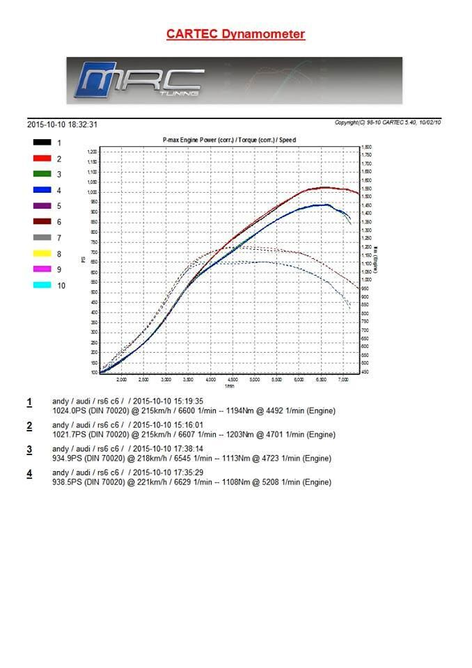

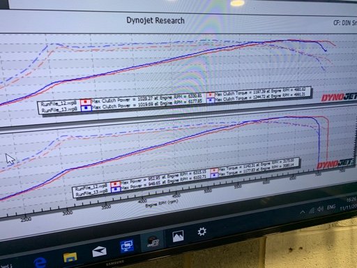

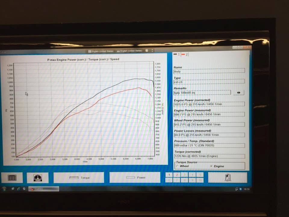

These are the most powerful RS6 that I'm aware of.
There are now 3 companies that sell turbos that support 1kbhp - TTE, TTH and Holex.
Nick
