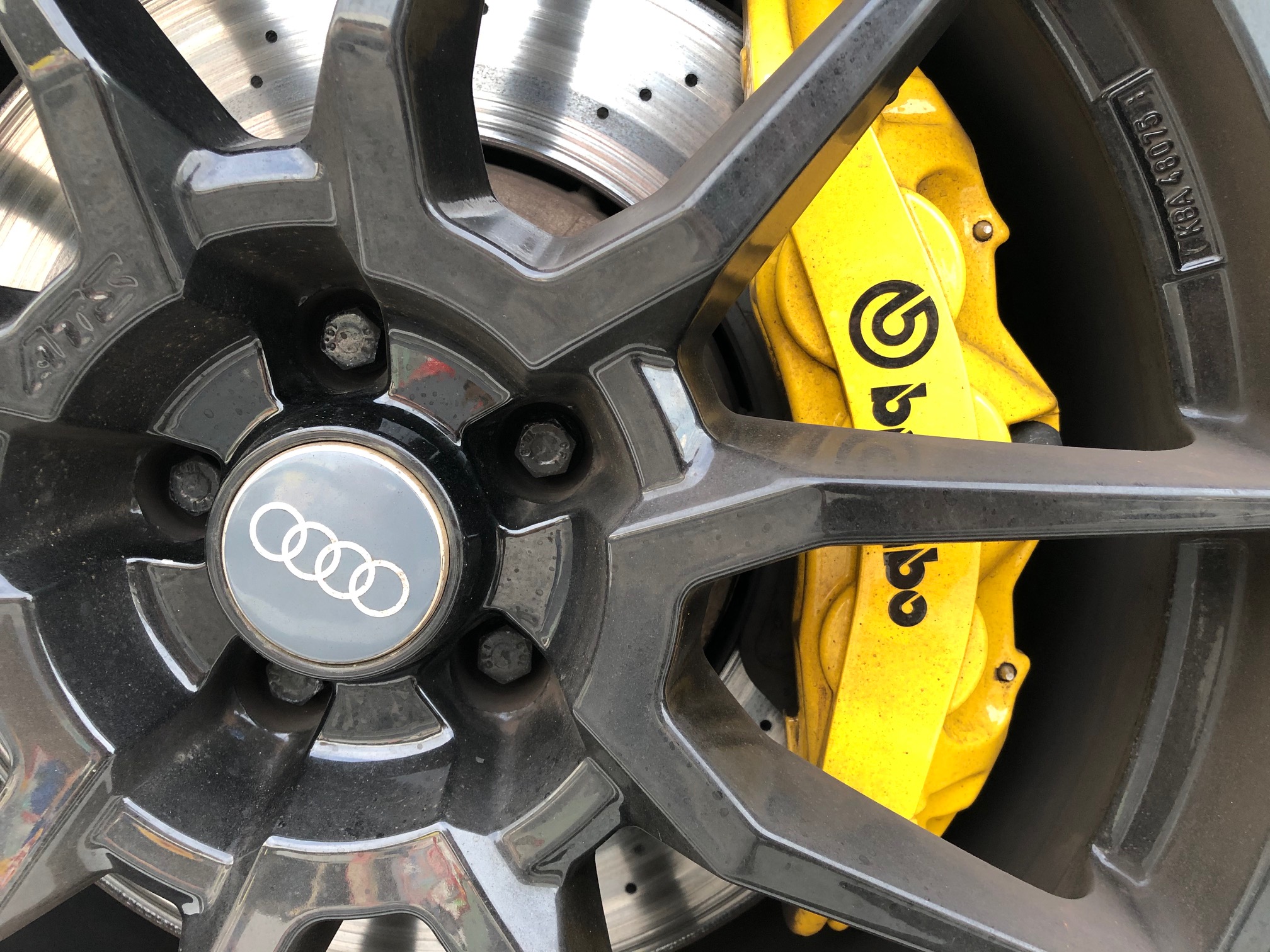

So I got my hands on an RS6, and it came with yellow Brembo calipers. I'm trying to figure out what these are. It's using OEM rotors, but I'm confused as to why someone would replace the OEM calipers with yellow Brembo ones unless they got better stopping power. Any advice on what to look for? Is it possible the previous owner installed a better caliper kit but stuck to the OEM rotors, dumbly? (ie should I look at larger rotors maybe?)
As well, I wonder if OEM pads will fit on this, or do I need some other pads? Any way to determine without disassembling the whole thing? I suspect this is a Brembo GT set, but so too were the OEMs, no? So I'm confused why one would go through the hassle and insane expense.
Was there ever a Brembo GT factory option or are these definitively aftermarket?

I'd say aftermarket for sure. The only option was carbon ceramic brakes.

No accounting for taste. Maybe they're OE calipers refinished in yellow* with Brembo decals**.
* 'cos yellow = ceramics (sometimes)
** 'cos Brembos are an upgrade - aren't they?

The OEM C6 RS6 calipers are made by Brembo. These look like someone has just refinished the OEM calipers to me as Jim said.

Took off the wheels today and looked at them more closely. They’re stamped Audi on some of the edges (in small writing), so I suspect refinishing them in yellow was what was actually done. Weird!!!! I guess they brake better in yellow?...
