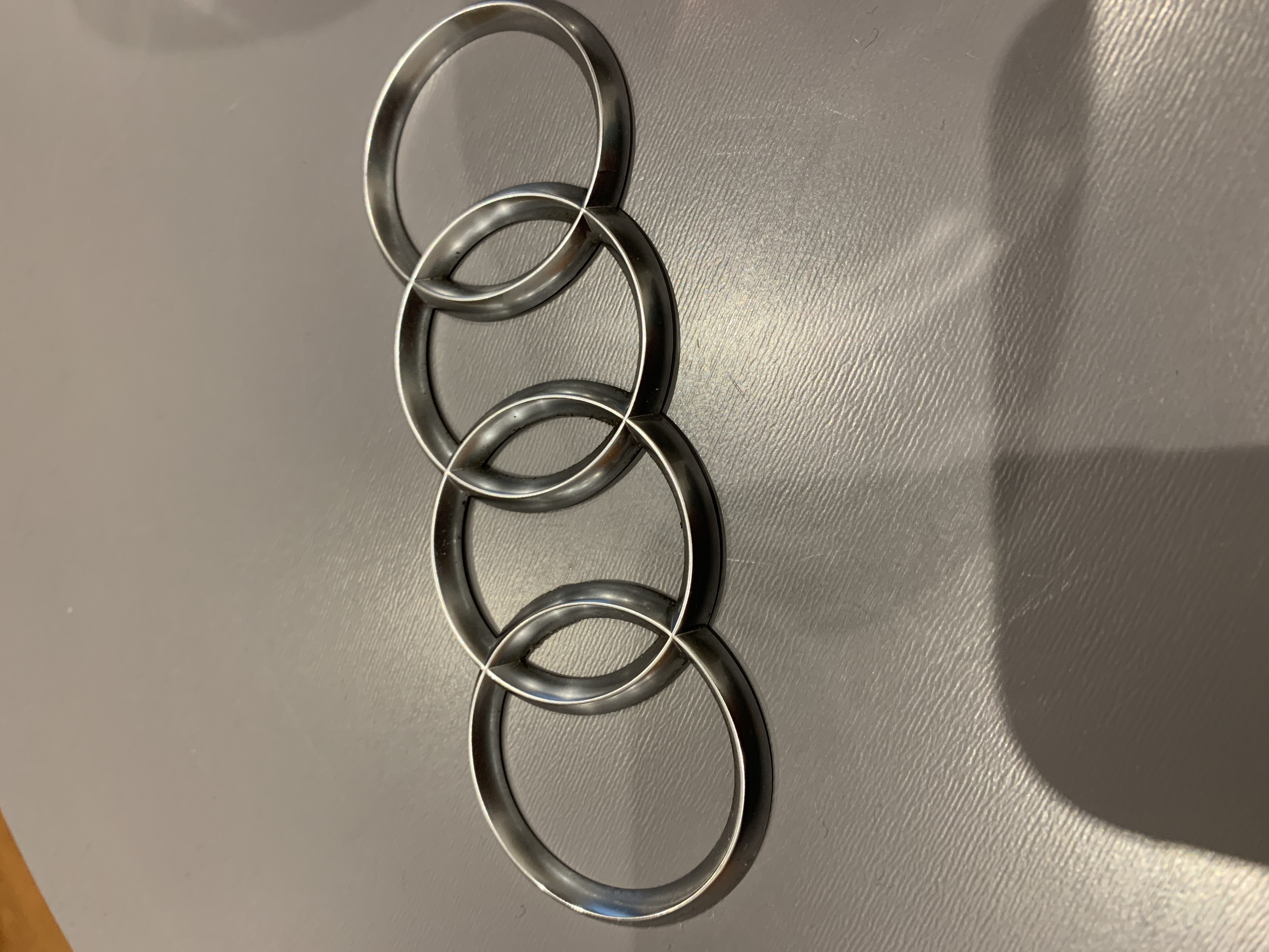

Hi
Anyone know where I can get a replacement from ? Mine has come off and don’t think super glue is going to hold it with the heat from the engine

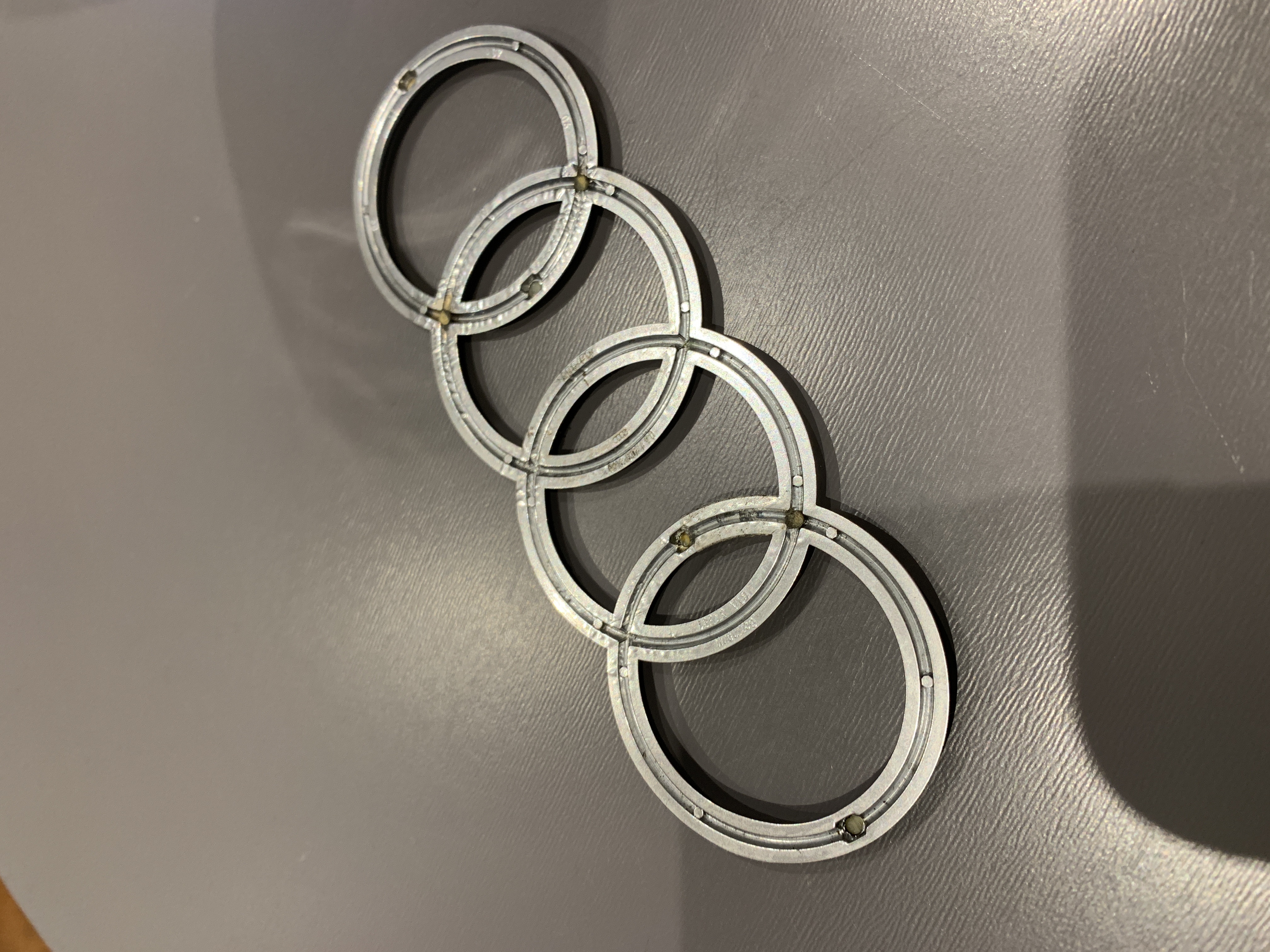

All the back pins have broken off

There's a thread from a couple of years ago - viewtopic.php?f=47&t=122257.
I'd be inclined to drill and plug fit some pins then use a bonding adhesive to fix it in place.
