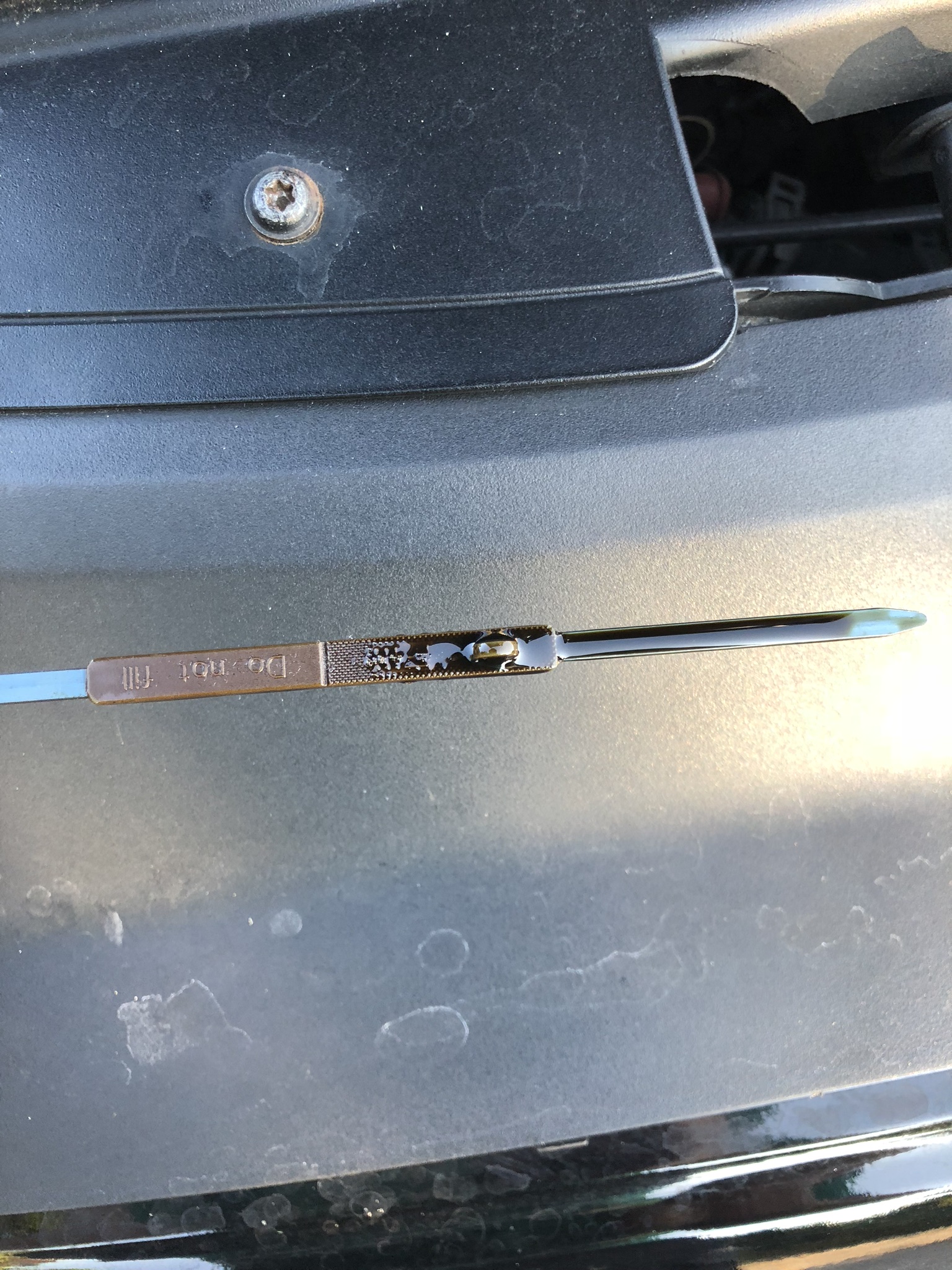

Thanks just I’ve min oil level sensor issue now twice never sure if it’s low oil or it’s the sensor
Check the oil looks fine error goes then comes back after while on long drive

The sensor can be a pain in some cars and fine in others but, as you've checked the oil and its fine, it looks like you've got one of the awkward ones. I think it's best to replace it just for piece of mind but that's your choice.

That dipstick is below the fill line which is why it's flagging probably
I'd estimate you're "down" about a litre or so

Keep it above middle line and you'll be just fine... if symptoms persist, replace the sensor at the next oil change.
