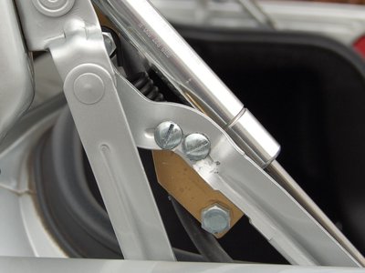

Like the strut on the attached file;
Re: Rear Boot Issue - Pain in the A@S% !!
I like the look of those !! Mine are black although I still have the old ones which were probably fine and guess i could chrome the top parts but not the bottom part as it would wear

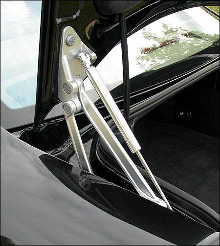

That Chrome strut looks like a Phaeton one?

Hello Ian - no, here is a Phaeton one;
Notice the chunkier and nicer hinge.
It was the strut I was asking about rather than the hinge as both images have the same horizontal line on the strut in what looks like the same place.
