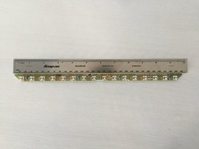

Hi Jim.
Regarding your high level brake light fault, this quite possibly could be an easy fix, if you were good with a multimeter and a soldering iron.
I say this as I have taken notes on the high level brake light PCB on my 2005 Superb 3U, however since I haven't worked on a C6 RS6 (yet!) I am unsure of the construction of it on the RS6. I would imagine the same general design would follow through on on both cars.
On my Superb 3U, the high level brake light consists of 16 “7676” type through-hole LEDs. The LEDs measure 7.6mm x 7.6mm (hence why they are called "7676" type) and are of clear construction, however they emit red light. The LEDs are numbered on the PCB as such; D1/1, D1/2, D1/3, D1/4, D2/1, D2/2, etc (see picture) up until D4/4. D4/4 in this case means the 4th array and 4th LED in this array. The LEDs are built in 4 arrays of 4 LEDs each. This means that there are 4 LEDs in series in each of the 4 parallel arrays.
In this case, if one LED fails, then the whole array will not light up. I.e. if D1/3 fails then D1/1, D1/2, D1/3 and D1/4 will not light as these are all required to work in order to complete the circuit. Each array also has a current limiting resistor, in my case the value of this is 34 ohms, signified by the colours of the rings on the resistor. There is also in my case a diode named "D1", connecting the +12V from the plug to the +12V rail on the PCB which supplies each array with power. It is possible that this diode could have failed in your case.
One other thing to check is the pins on the PCB that connect to the plug can come loose and obviously if this has happened could explain why your whole unit has failed.
Once again, I stress that what I have said here is specific to my car, a 2005 Skoda Superb 3U, however I imagine that the general design will most likely be similar in the C6 RS6.
Hopefully this helps!

Thanks, that had sort of been my plan - considering the awkwardness of getting to the thing I sourced a new unit yesterday with the intention of taking a look at repairing the old one at my leisure.

Turns out one of the pins had corroded and snapped off at the base of the socket. Getting the remains of the pin out of the plug wasn't easy, even with the terminal released from the plug body.
Where changing the light unit was concerned, what a pig of a job. Took me best part of an hour to release the lower trim from the tailgate and as for getting the old light unit out - well, let's just say that I exhausted the entire vocabulary of swear words that I've collected in nearly 60 years (in two languages too).
