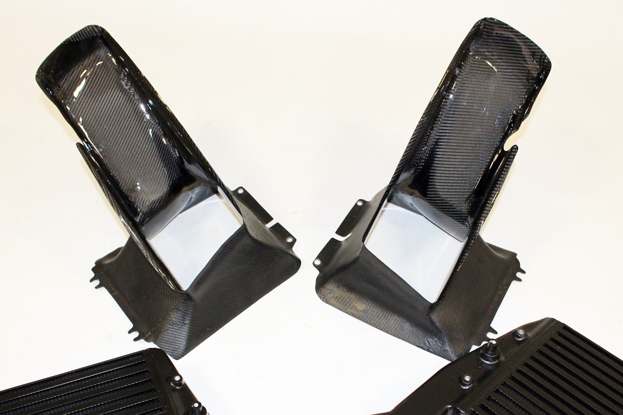

So, performance figures! Well it’s a mixed bag of good & bad which doesn’t sound great but let me explain. They do make the power! They made 920hp no problems which is great for their cost, however, there are two “issues” they have which need to be mentioned.
Their flow rate above 6500rpm seems limited and, as they were making no extra power above that, Doug decided to reduce my limiter back to OEM 6500rpm. This isn’t a huge issue as they still make 900hp+ at that rpm but something to be aware of.
Their biggest problem is that they suffer from heat soak when the car is not moving, due to a combination of having no fans fitted (I felt they block the air passing through the core when driving and I’d rather have more cool air when driving) and having a thick metal core which absorbs heat and doesn’t cool back down easily in static air. On the roads I’ve had absolutely no problems or power issues but when in static air (dynos, start line on drag strips, traffic light grand prix etc where the car isn’t moving) after repeated runs they just couldn’t cool down quickly enough between runs which raised the intake temp and robbed power. In fact Doug said my 920hp runs at MRC dropped to 900hp within 3 consecutive runs and to 880hp after a further 5-6 back to back runs and that is with some very good dyno cooling.
Worse still, at the Surrey Rolling Road day the car had not been “prep’d” in the best way prior to the run. I’d been out for a blast, then switched it off for 20 mins, then sat idling for a further 10mins adding even more heat soak before the run which was done without any IC fans (only one engine bay fan so the worst possible setup imaginable) and the power had dropped to only 780hp!!!! Even cooling the IC’s by flicking some water on them brought them back 30hp to 810hp showing how poor they are when in static air (when the car isn’t moving).
So, my review – They work, they’re cheap and they’re adequate for 900hp+ but just stay away from dynos and drag strips as heat soak is an issue.
Will I be changing mine? – It depends on the cost of the Sportmile ones to be fair. Now I know the KWE’s “limitations” I can work with those as I rarely do dynos/drag days/traffic light grand prix but if there’s a better IC for a respectable price then I’d consider it. However I feel the Marston’s are still too expensive for what they are, now I know the cost of the cores.

No they're designed to fit the OEM fan if you want to fit them.
However the core of the fans restricts the airflow to about 40% of the cooling fins so I made the choice to leave them off as I personally prefer to have 100% of the cooling fins available for cooling when your driving (which is how my car spends 99.9% of its time), rather than having fans to help during the very short time you're static and want to launch off the line.
Again, once your driving the IC's are fine although it's still fairly "cold" here (<10'c) so maybe once it gets up to mid 20's in the summer it'll be different?

Euro spec cars also have cooling pipework routed around the right hand ic. Don't ask me how I know.
The KWE ic's are far from plug and play on euro spec cars no matter what KWE is saying.

When I was in contact with KWE they suggested to use the OEM fans. This was the best compromise at the time, but that all depends on how you use the car. For your area it is probably the best solution.
KWE has also experimented without fans and with bigger fans. They went back to recommending OEM fans.

Yes the OEM fans fit and, for Dubai, I'd definitely fit them.

From my experience - traffic & cities etc needs fans regardless so while I completely removed my fans to allow more cooling air to hit the IC's when driving at speed (spend most time in countrysides and fast roads) if I lived in London I would never remove the fans.
One thing to remember is these KWE IC''s are not direct fit replacements, they needs the "ducts/shrouds" from the bumper to the IC modding to fit properly so add that cost into the buying price too, although KWE also do a nice set of CF ducts/shrounds for about £600 which is ridiculous but so tempting
