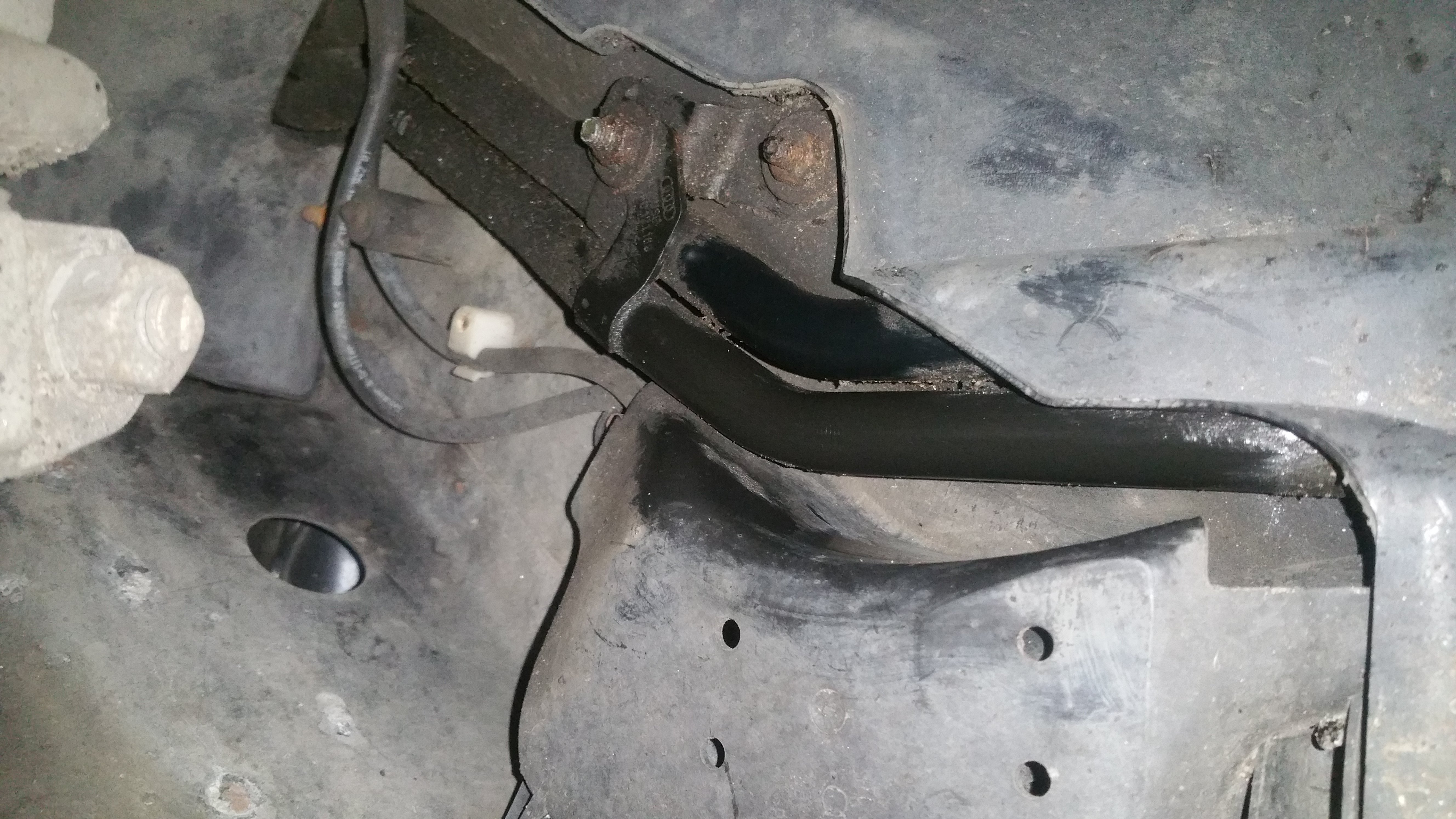

So I've been in comms with 'strawman' who is selling his lovely sepang blue Avant in the classifieds re the coolant pipes. Turns out the pipes are NOT covered under Audi Warranty (but the oil leak is). He had his fixed by Audi and they failed to spot the pipes needed fixing until the engine was out and picked up the labour in good faith. One ray of sunshine was the fact that they 'should' be able to fix the pipes without removing the engine. The car is into Audi next week so will have a chat with them then and if it's a crazy price I'll take it to MRC as invariably they should be cheaper than Audi. Will also have a close look at the warranty as its up for renewal next month and need to weigh up the cost. One bonus should be that once the pipes are sorted then it shouldn't be an issue again. Will be holding my breath when they give me the quote!

Ok so to wrap up this subject-the RS went into Audi yesterday for the coolant pipe issue. Audi reports back that its surface corrosion and so it's not a negative issue at this time. They also confirmed what others have said that extended comprehensive Audi warranty does NOT cover corrosion. So that's a self funding job if it rears its ugly head and I don't fancy paying Audi labour rates when a specialist such as MRC can do the same (if not better) at a cheaper rate.
Everything else checked out and whilst she's in there it was time for an oil service and brake fluid change. £385.00 for the oil and £59.00 for the brake fluid in case anyone is wondering.
Looks like I dodged the coolant pipe issue although am sure at some stage in the future surface corrosion will become deep corrosion.

Got the car back from Audi today and one thing the techs said about the corroded lines was that they weren't sure that they were in fact coolant lines and may be air conditioning pipes? That was from the tech that's their resident RS specialist. Any ideas? Photo at the beginning of this thread. Baffled.com here.....

stevo55 wrote:Got the car back from Audi today and one thing the techs said about the corroded lines was that they weren't sure that they were in fact coolant lines and may be air conditioning pipes? That was from the tech that's their resident RS specialist. Any ideas? Photo at the beginning of this thread. Baffled.com here.....
Just ask them.... "Do I need to take the engine out to replace them?"
Who cares what the line is, when it bursts, what does it cost!

I'll update this since it was mine that was done recently.
They were called 'Heater Matrix' pipes on the parts list that I saw and were about £400 for parts.
They swapped them without removing the engine. They had quoted approx £1k to replace but agreed to pick up the labour as it hadn't been spotted when the engine was out having a lambda sensor replaced so fair play to them.

Post by stevo55 » Wed Jul 20, 2016 10:12 pm
Interesting-I wonder if the ones in the pic I took to kick this thread off are the same ones? If so then £1k is better than £2k let's face it...

Post by strawman » Wed Jul 20, 2016 10:23 pm
It's the two lines that run together at the top rear of the OSF wheel arch. I guess they pick up all the road muck and it seems crazy that they're not protected in any way.
The tech said it was tight, as they run round the back of the engine, and they weren't sure if they could do it with the engine in but maybe their offer to pay the labour focused them a little.

Funny you say that just wiped a little of my lines with a bit of kitchen roll and they were covered in some oily grease ...bear in mind my pipes have been replaced. What's strange is that a wee sleaved wire has nothing on it in terms of the oily residue pic below

Post by TomRS » Thu Jul 21, 2016 11:22 am
Oily residue will be underseal to attempt to protect it!

Perfect Tom only cleaned half so will apply some grease to tell bit I wiped makes sense actually now I think about it.

discostu49 wrote:Funny you say that just wiped a little of my lines with a bit of kitchen roll and they were covered in some oily grease ...bear in mind my pipes have been replaced. What's strange is that a wee sleaved wire has nothing on it in terms of the oily residue pic below
Nice pipes Image mine look nothing like that...wondering if I should just coat them in grease and hope for the best of would that just be pointless? Audi gave them a clean bill of health and looking back at my photo it looks like a past of the pipes is corroded the rest is the metal clamp.
