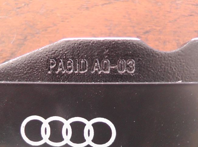

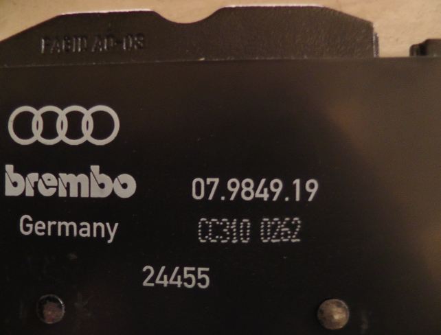

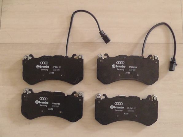

I dont know about the rotors, but have been told the front brake pads used on the steel rotors/discs of the C6 RS6 are the same as used on the nissan gtr35.
[/quote]
Hi bam_bam, you are correct on the Brembo pads for the C6 steelies. They are Pagid A0-03. Brake pads are same size etc as pagids fitted to GTR35 but called Pagid RS19.bam_bam wrote:[Really? I thought these were actual Brembo pads on the C6 steelies, I'm surprised Alcon would use Brembo. Not saying it's wrong, just saying I'm surprised.
