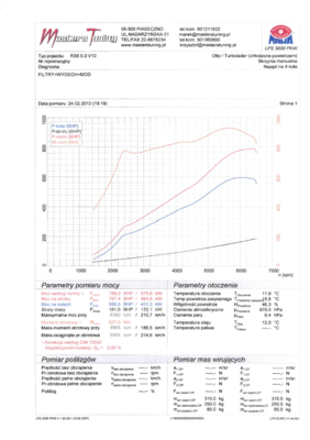

I had my car tested on the same dyno type as OP. Results are below. The losses seem to be lower in my case but also the speed / gear during the test.
The car was first tuned in Germany by MTM and with 650PS, fell well short of marketed 700PS. Earlier this year I had it modded by Sportmile in Poland and following change of filters and fitting 3’’ exhaust from dowpipes it has now 788PS and puts smile on my face every time I drive it. It is a real beast with a child seat ;-). See also a clip taken in Germany showing how it deals with everyday road situations (vs. 600bhp 835nm GT-R) ;-).

Can you please confirm that you are running 3" catless down pipes from the turbos to tail pipe or are you running standard down pipes with precats and then 3" exhaust all the way to the tail pipe?
Or are you running the high power spec valved MTM exhaust with 100 cell race cats or no cats at all?
http://www.mtm-online.de/content/produc ... =RS6C6426Q
" 742 bhp - MTM - metal catalysts (export version) with MTM - stainless exhaust system from catalyst 4-pipe incl. throttles in 2 pipes with control and with air filters"
john

Hi John
Exhaust is fully custom made by Sportmile: 3'' downpipes from turbos to tail pipes with aux cats removed and 100 cell race cats (by Magnaflow IIRC), non-resonated. Gained 50hp and 100nm across the band vs stock exhaust.

Hi Tomasz,
many thanks for the prompt reply and vey useful information and pictures of the sportsmile custom 3" exhaust and how it looks on your beast. :thumbs:
From your photos, it almost looks like you can bolt the sportsmile exhaust downpipes to the turbos without having to pull or lift the engine/trans unit?
50bhp and 100nm gain from standard is very respectable, indeed. :bowdown:

Post by TBl » Wed Apr 11, 2012 7:52 am
You'd have to ask Sportmile how they've done it but as far as I know they had to lower the engine a bit and it was big pain in the a.. to have the old downpipes removed.
