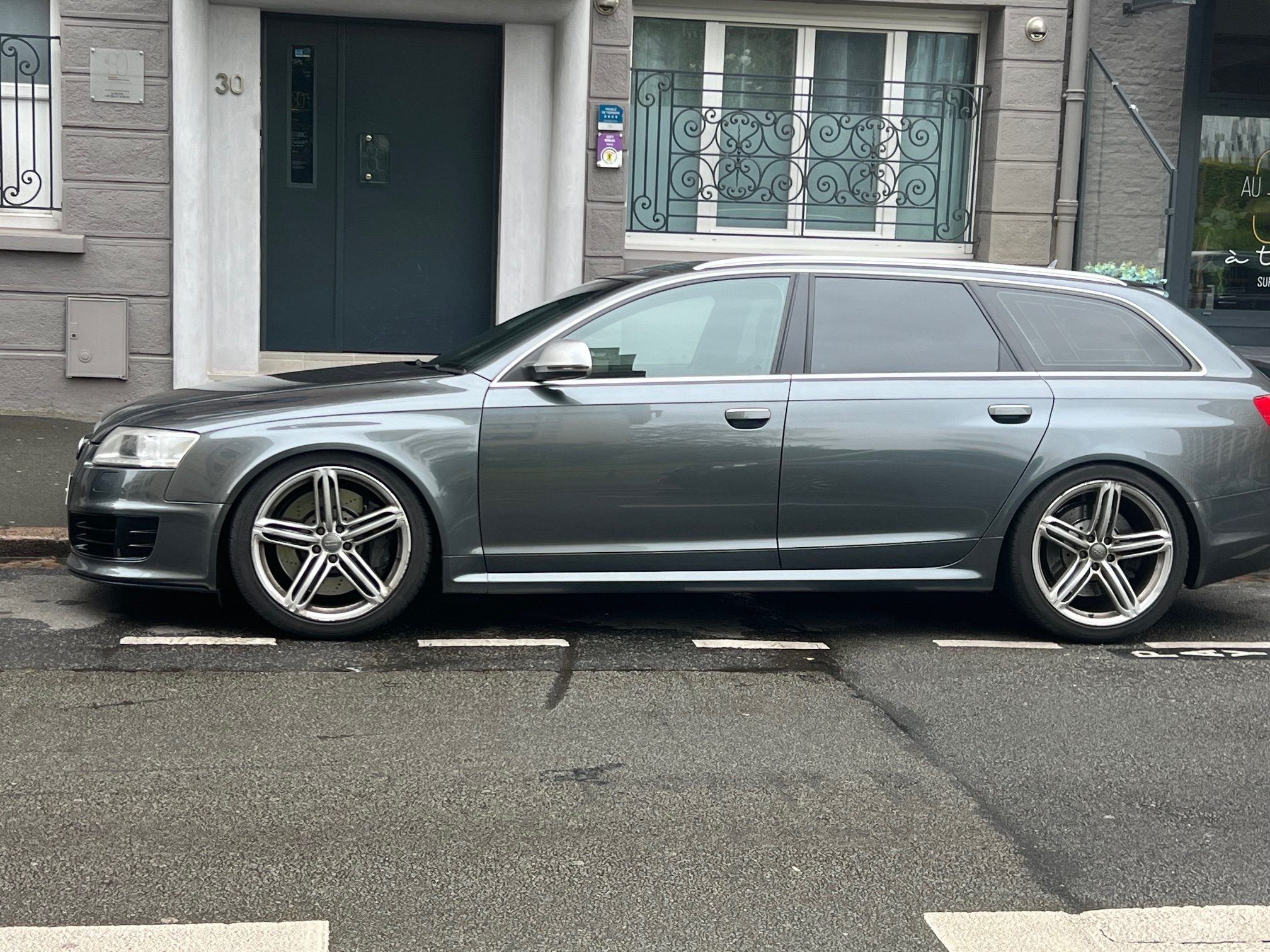

French
Posts: 37
Joined: Mon Sep 18, 2017 10:17 pm
Re: Need coilovers asap
Post by French » Wed May 01, 2024 7:44 am
This is the look now....
