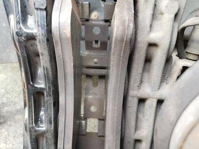

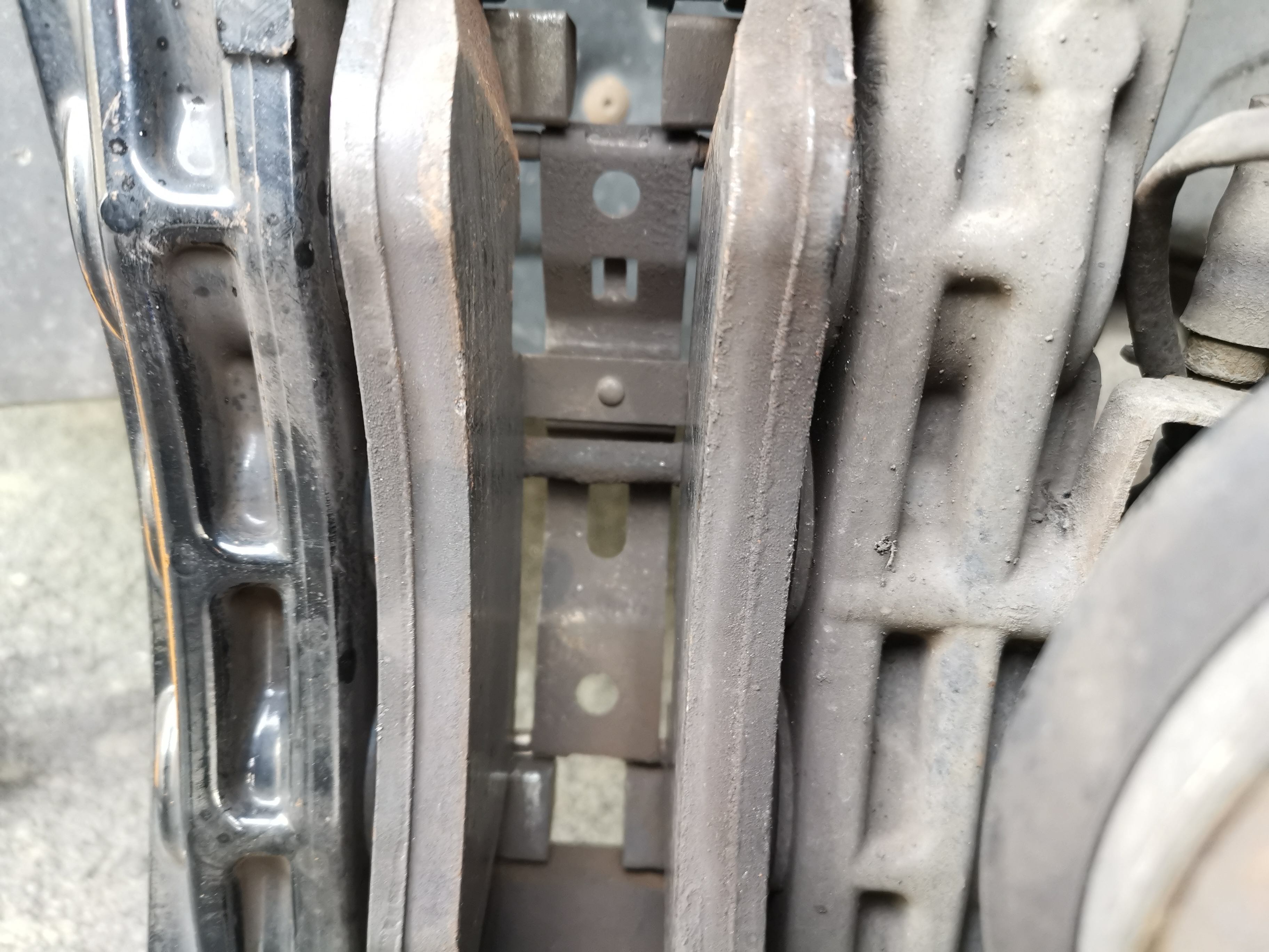

I wanted to clean up the brakes and measure the thickness of my discs as Audi had claimed they were 90% worn at last years inspection. Decided to take the discs off and rounded the small torx bolts at the front :x
Had to drill the buggers out. An hours job turned into many. Good news though as the front discs measured in at 35.0mm. I'm going to stop taking the car to Audi.
@jbourne where did you get your discs from?
Could you guys tell me how much life is left on these pads? I've got a set ready to go on which I may as well throw on when I get the tyres changed in the next few weeks if they're close to the wear limit.

Those pads look pretty alive to me, maybe half worn? Maybe even less than half. I can post a pic of my brand new pads.

35.0 mm discs are half worn, and those pads even less so. Replacing half worn brakes is a common garage scam IMHO.
My rule of thumb is that each disc surface is allowed 1.0 mm of wear, and each pad is allowed 10 mm of wear.
