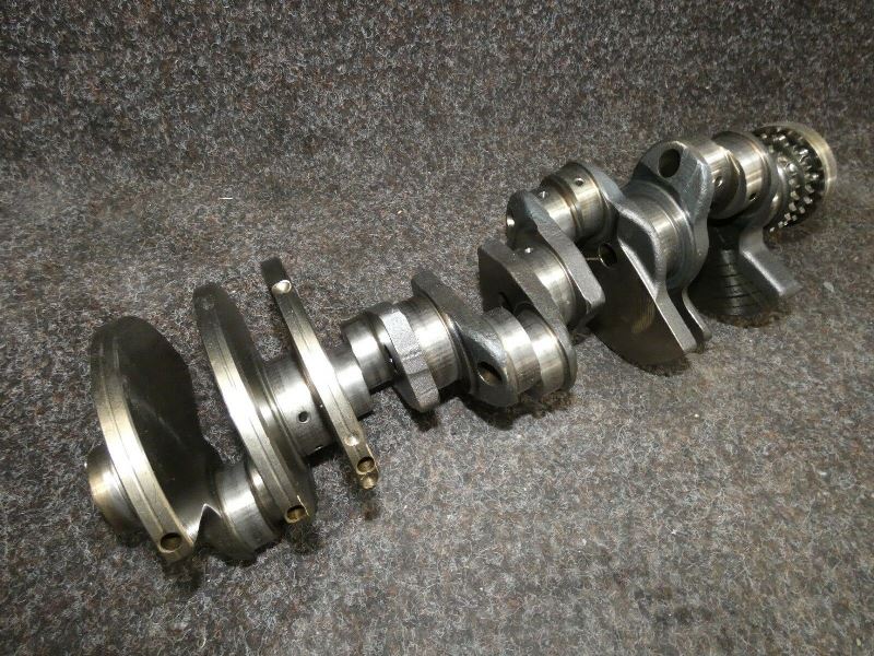

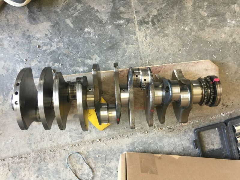

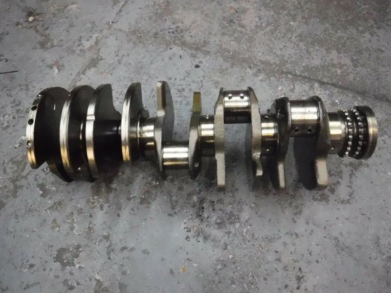

Here are some pictures I found in the following order:
Audi V10 : split pins, six counterweights Gallardo : split pins, ten counterweights Huracan : straight pins, ten counterweights .

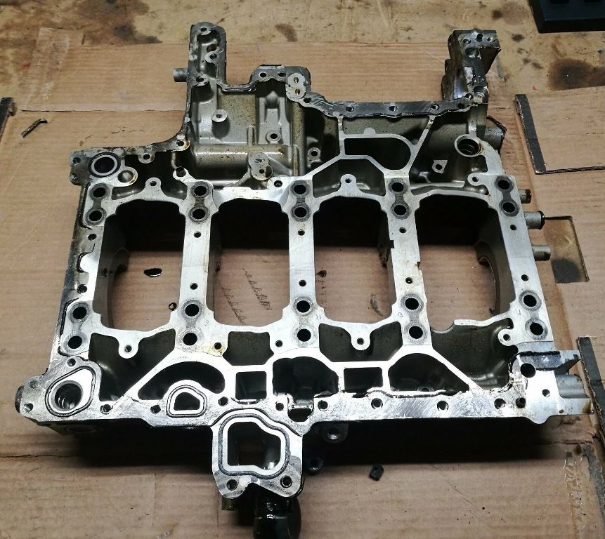

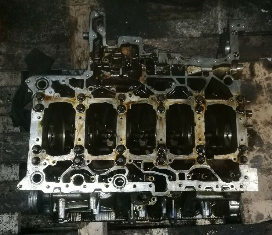

It turns out the streets aren't paved with gold, and Audi V10's aren't Lamborghini engines after all.
There are more differences between them than you might expect. Here are the bottom ends of:
Audi RS4 4.2: Audi 5.2 V10 Lamboghini 5.2 V10
I couldn't find any pictures of the RS6 bottom end. What you see in the pictures are the block girdles (also called bed plates). While all these engines do have block girdles, which are certainly a good thing, they're quite different.
Interestingly the Ferrari 458, BMW V10 and the Audi/Bentley W12 also have bed plates. In the case of the latter, the windage tray and bed plate are integrated into one casting, even though it's a wet sump. It makes for a stiff structure that effectively ties all the bearing caps together down the sides AND down the bottom, kind-of like the Lamborghini.
Nick
