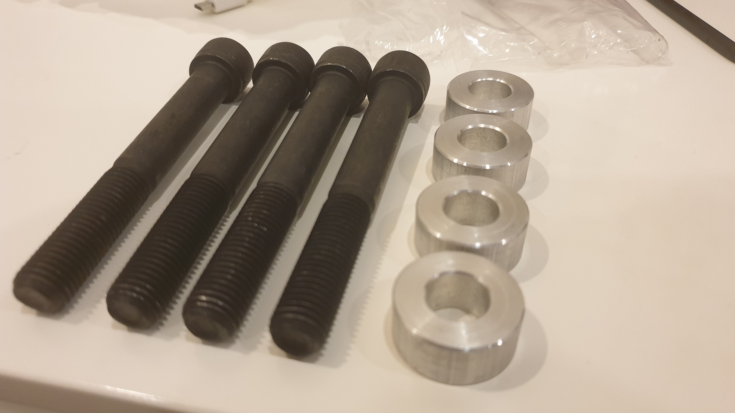

Hello,
Would anyone have a photo of what the spacers actually look like that are required to fit the AP Racing 410mm discs? I have the discs & the longer bolts now, but I dont seem to have the spacers. Are they supposed to look like a bracket, or just like big / thicker washers?
Attached is what was sent, to me but i was expecting 'bracket' type looking spacers, not big washers. Can anyone confirn that these big washer looking items are indeed correct & they are what everyone's calling the spacers?

Most brake calipers have mounting bolts that are oriented sideways with respect to the car centreline, and they're the ones that need brackets.
Some high performance calipers like these however, have the mounting bolts oriented longitudinally. The modification consists of moving the caliper backwards by a few mm, and in this case all you need are spacers and longer mounting bolts.
I did this on one of my cars a few years ago (brilliant mod). The trick is getting the height of the spacer right - it's not simply half the difference in the disk diameters. The bolts have to be good as well - typically 12.8 grade steel. IF you're buying a kit, the seller will have figured this out.

Hi Nick,
Thanks for that, sounds like i do have the correct items then. I got the discs from RB Racing, but the longer bolts & spacers were shipped seperately by them which have just arrived, so just wanted to check they are indeed the right items. The guys at RB Racing for sure will know their onions, so im confident all is in order.
I've sent my car in to get the TTE 1000+ turbos & Wagner IC installed & i'll also get the brakes done at the same time. It will be a few weeks before i get the car back, but i can't wait to see the outcome!! :bigblink:
