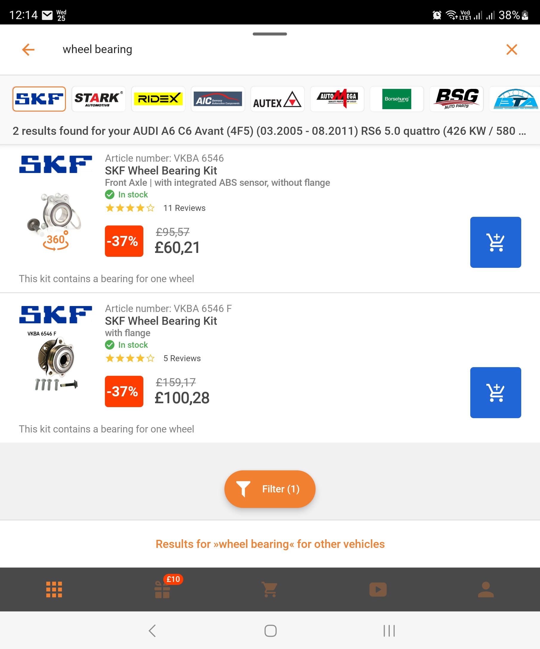

Anyone know which of these I should be going for?
Jim Haseltine
Posts: 908
Re: Wheel bearings
Post by Jim Haseltine » Wed Jan 25, 2023 8:24 pm
The bottom one is plug'n'play, the top one will require the hub transferring from the old one, which may need a press.

Post by Imola_Sid » Wed Jan 25, 2023 8:44 pm
Plug and play it is!
Thanks Jim, as always super helpful 👍👍👍

I typed "may need a press" because I don't have access to ElsaWin at the moment. Going from older Audis, the hubs in them are a tight interference fit in the bearing and require a fairly hefty hydraulic press to push them out and to fit them to new bearings. If you do it wrong you wreck the bearing before you get the hub fully home.
