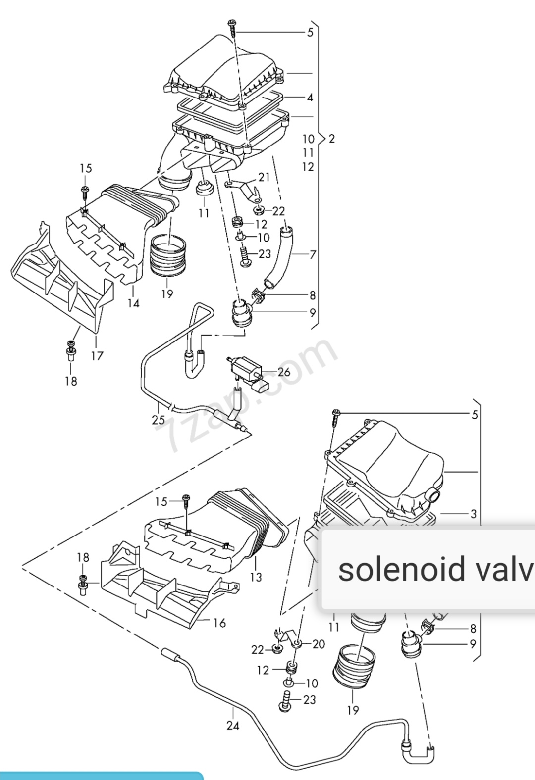

What valve is located under the small plastic trim in frokt of the engine? Some prev owner seems to have bypassed it - not sure why and what it does? I would need a routing diagram to fix that.

no26 on the attached diagram is the valve/solenoid that has been altered. Mounted on the intake under the v10 cover. The diagram doesnt say which part number it has nor how it should be connected to the intake etc.
Found a image online, should it be connected to the intake via 2 ports and a third port to the diverter valves?

For connection it should the bottom port goes to a T-piece which then goes to each DV along pipes 24 and 25 as shown in your diagram. Then for the last two ports - as shown in the diagram linked below, one port goes to the Vacuum reservoir (item 39) and to the last goes the intake manifold (the right one in the photo you gave).
The Pt No is 07L906270 if you need to buy one, it's item 32 on this diagram - https://audi.7zap.com/en/rdw/audi+rs6+r ... 145010/#32

It's the N249 valve, it uses vacuum pressure to help open the two diverter/dump/blow-off valves (item 9 on your image) which are molded (one per side) into the bottom of the airboxes. With it disconnected you may find driving is a little jerkier/less smooth at low/medium boost/throttle than if you have it connected and working, it's a fairly common Audi S3 engine mod IIRC where I've hear most about it but on the RS6 it's extremely rare.ChrisOsbakk wrote: ↑Wed Nov 24, 2021 3:17 pmno26 on the attached diagram is the valve/solenoid that has been altered. Mounted on the intake under the v10 cover. The diagram doesnt say which part number it has nor how it should be connected to the intake etc.
Hope that helps.
