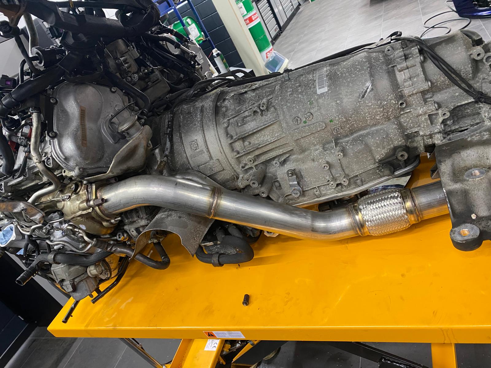

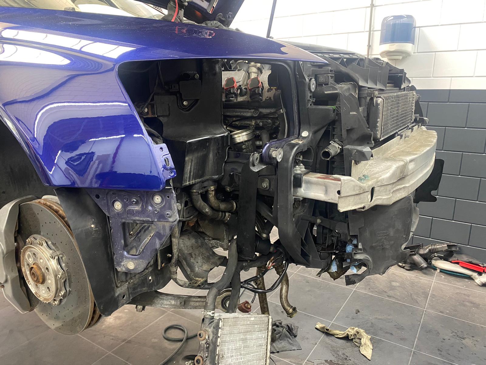

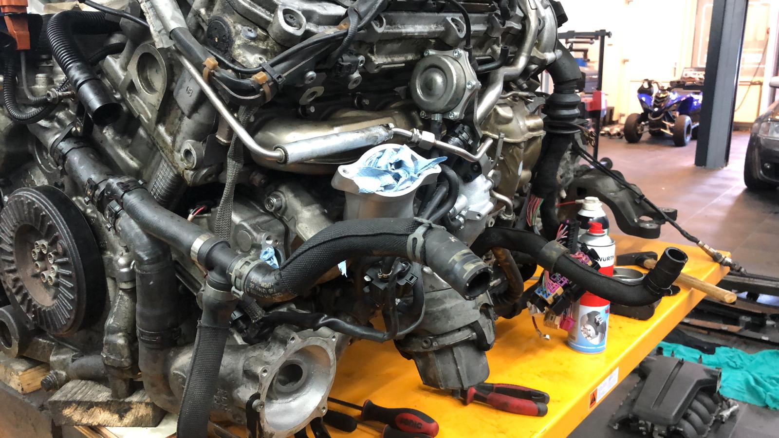

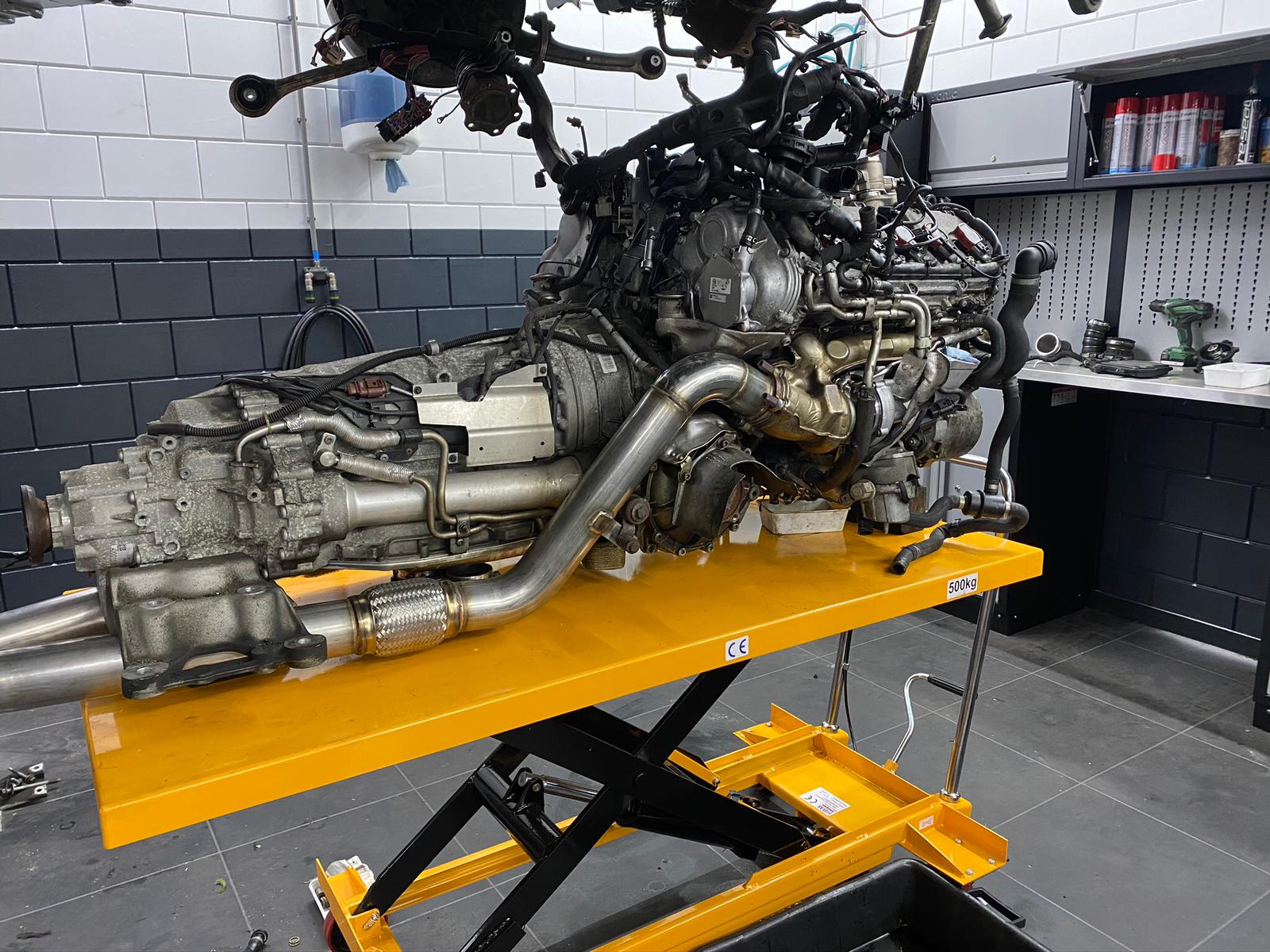

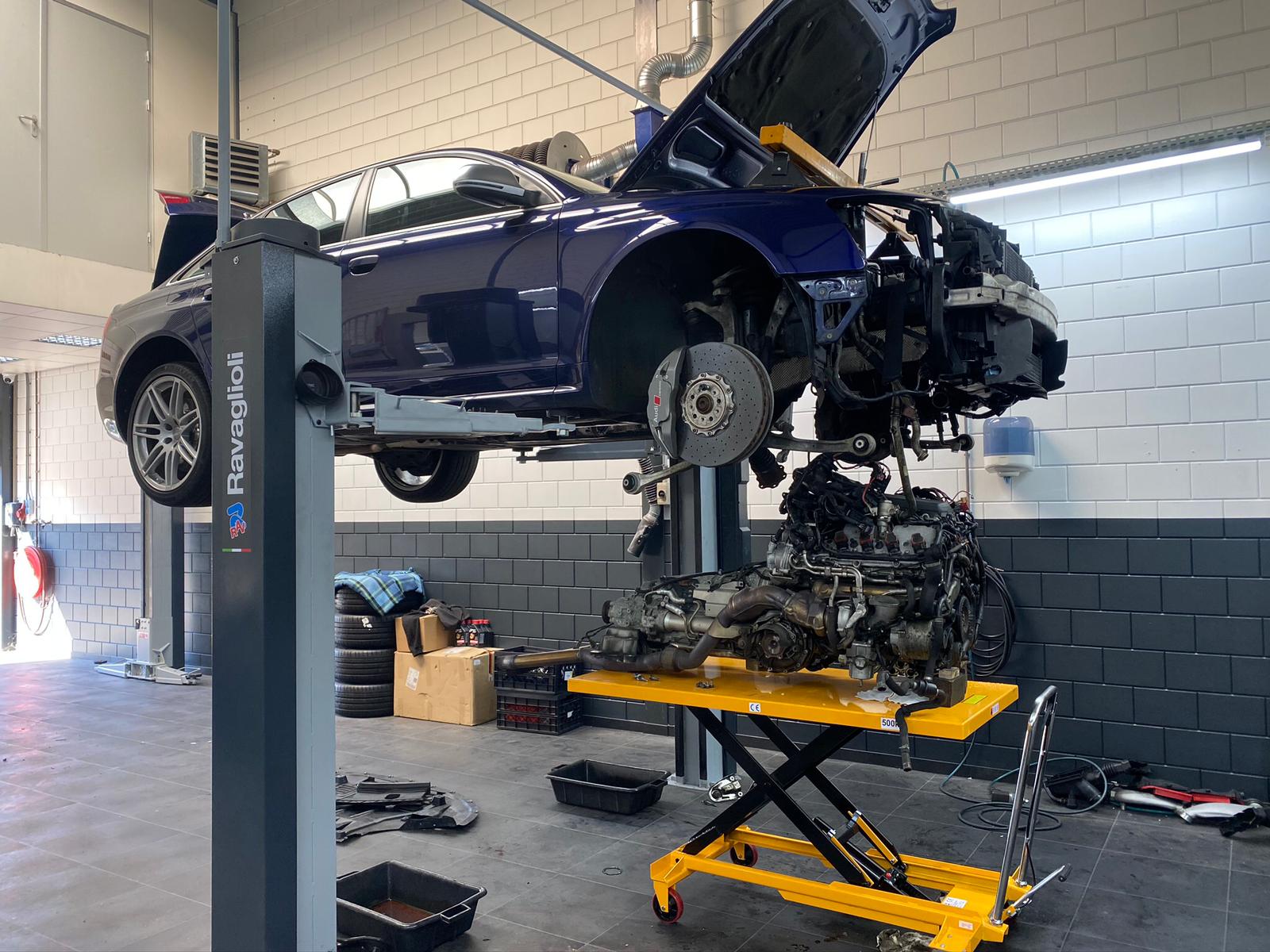

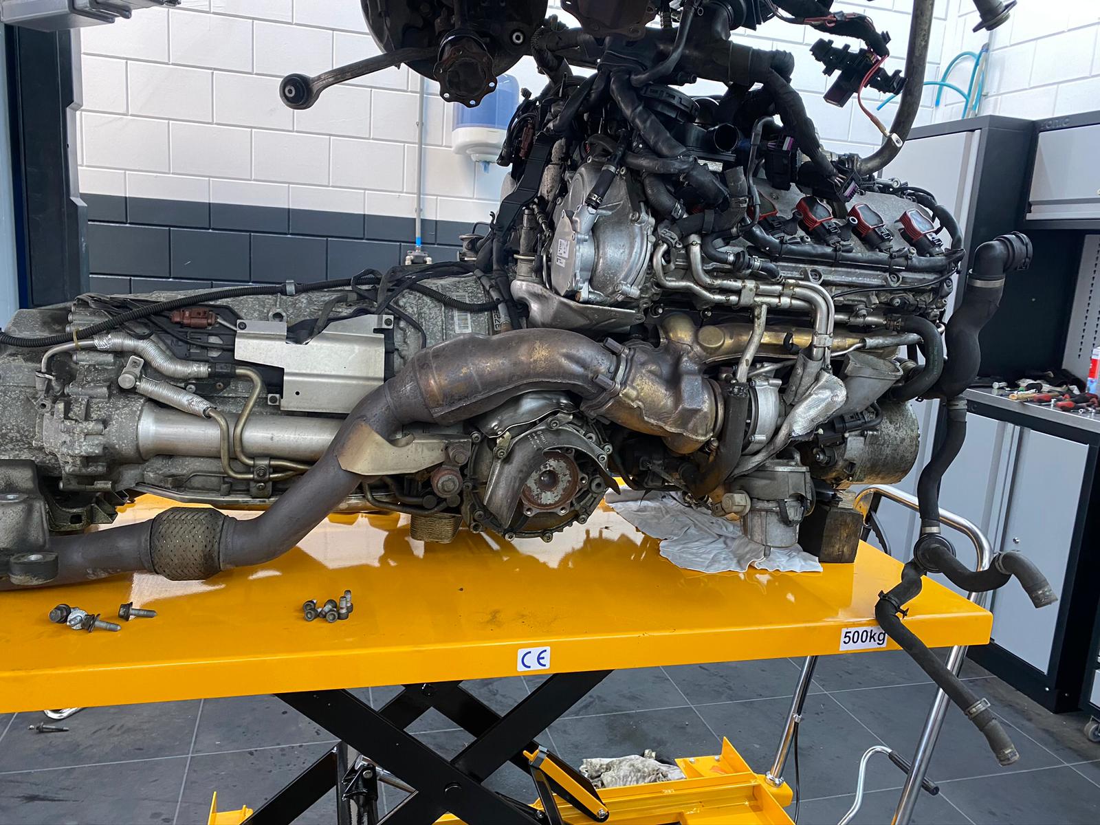

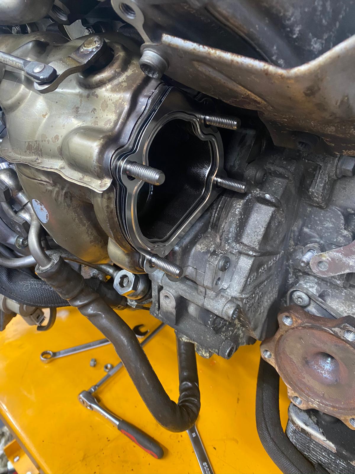

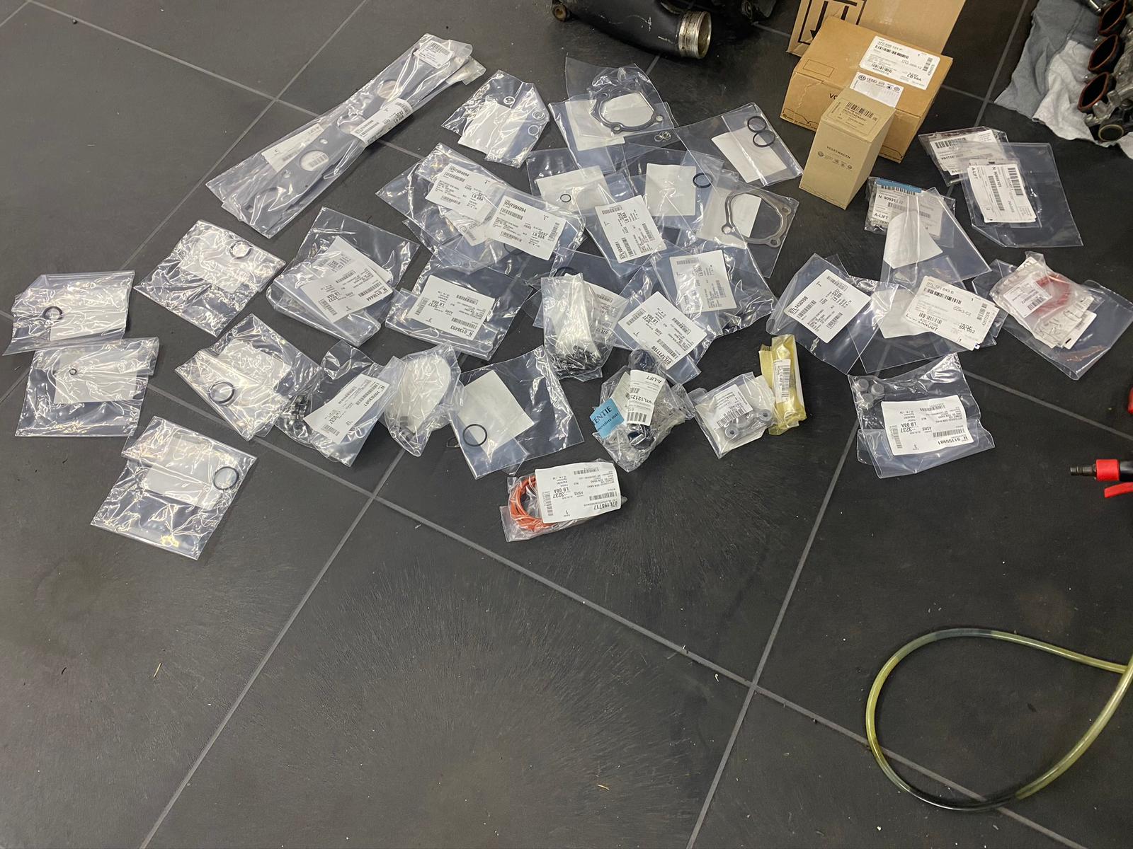

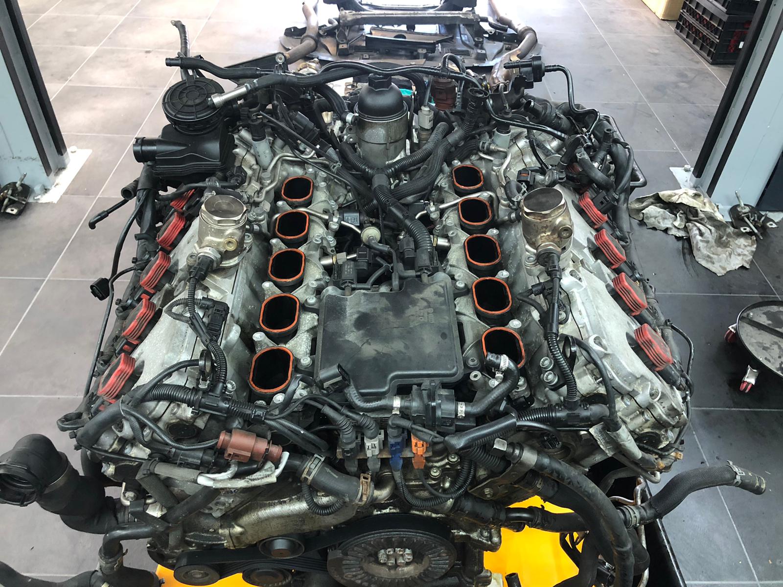

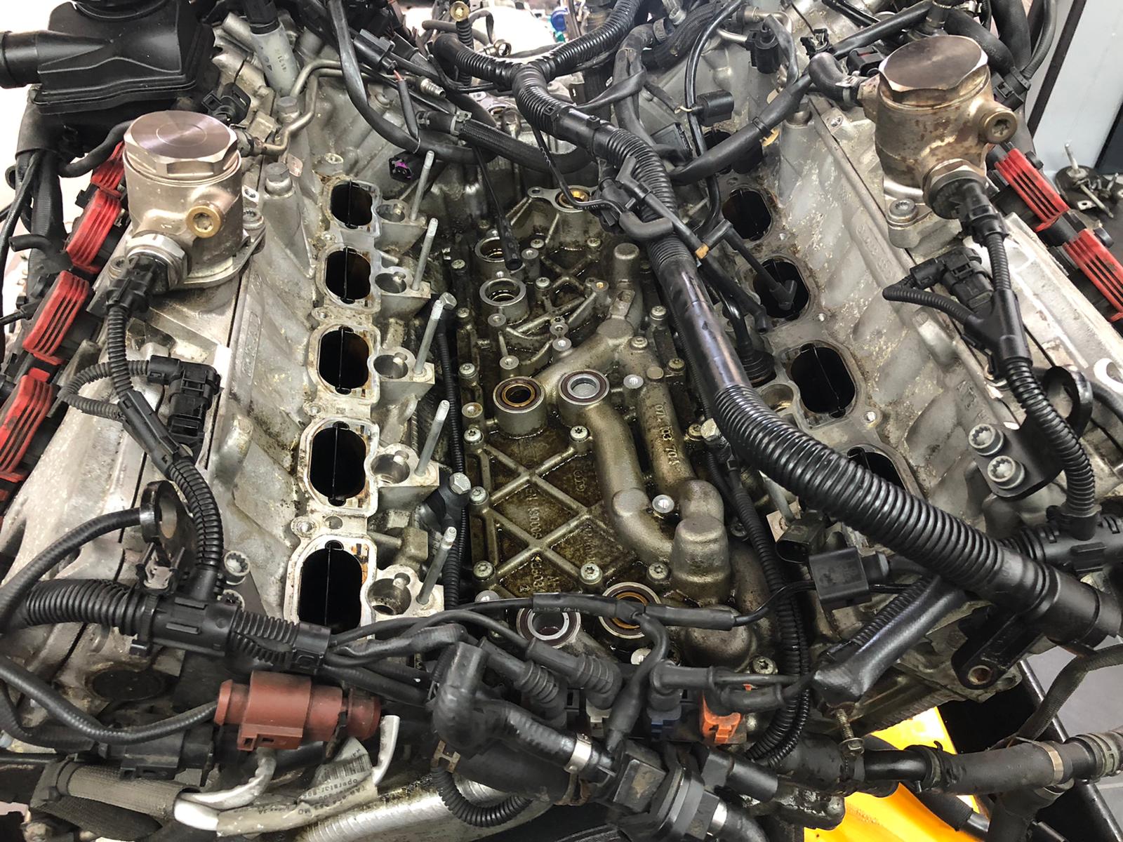

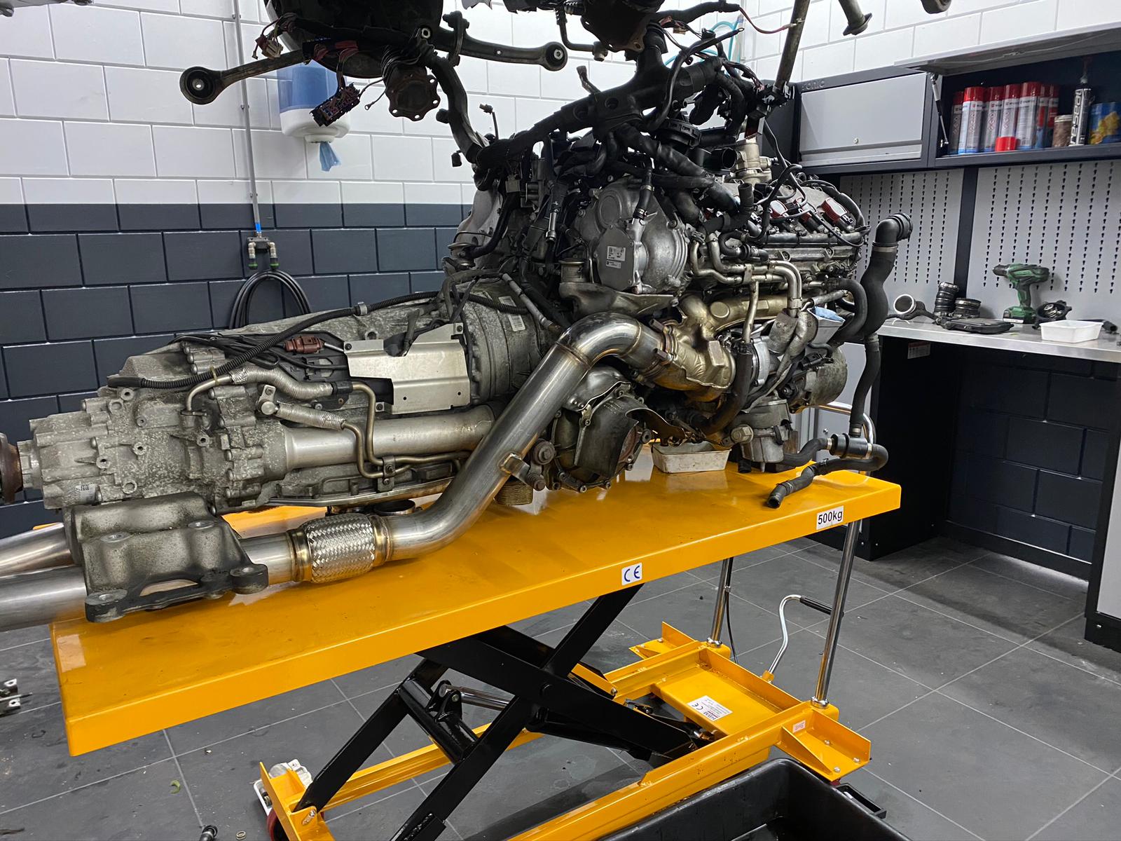

We currently finished our TTH850 project (but already looking forward to another upgrade in the future for the 1000+ HP). However for this we do require a larger piston ring gap in combination with a stronger gearbox (or even a forged build). What we have done with our currently TTE850 setup:
- PCV Check & vacuum check.
- 50 cent "O" ring replacement, also replaced back "triangle" shaped holder just to be sure.
- Replaced all rubbers, rings and such outside block
- Replaced sump pomp rummers
- Oil pump top rubber replaced (was leaking).
- Removed the carbon buildup at the intakes.
- TTE850 set with steel downpipes.
Does anyone know if this engines cylinders can be honed? (is it correct that an oversize pistons cannot be realized because of the cilinder wall type?).
I forgot to place catalysators in the exhaust line in all the excitement, so before the car can drive on the road legally here we still need to add these. Due to circumstanced this will be done 1st or 2nd quarter of 2022 together with the software. From the downpipes to the back we will be creating a custom titanium 3" line with two X pipes and custom muffler boxes, we hope that this way the sound will sound better than just stainless steel.

I would really like to get some more information about the wall of the cilinders. I have cleaned and revised another BUH engine (got lots of pictures if anyone want to see them) recently, but did not went inside the block because compression was sort of decent and cilinder walls looked allright (turbos failed because of PCV failure) but internals were still decent so with a new set of turbos, revision of the pump side with the dreaded O ring and the block was good to go to a new owner. I did have a complete PCV check on my TTH850 block since I know these engines require a good to perfect PCV vacuum/working order not to I*(&^@! after some millage.

I honestly do not know results/benefits directly as we have no comparison runs on the dyno, sound wise its allot louder and deeper - I do see that the flow could be better with the rather cheap downpipes we used. If I could re-do this job I would have gotten titanium ones made or -> (get the MORE expensive steel ones if you want to replace them, we had to heat and bend a spot as this KWE set does not fit at all. Still hear a vibrating sound when turning a sharp left because of this spot. We also welded in a bar between the exhaust just before the flexible bit to prevent rattling and vibrating around). They were filthy cheap so I am not complaining haha. They are allot more straight and some points have a larger diameter than the original downpipes. I think if the flow is better this could result in better spool up, little better responds and a slight increase in horsepower depending on turbo size.

They are 3" downpipes, and we are planning to use 3" titanium all the way to the back if this fits. (We also need to integrate 200CPI cats somewhere)
