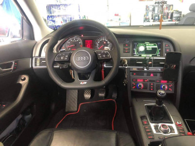

Hi all,
I have seen a few owners retrofitting the new RS4 or even R8 steering wheels on their RS6 C6.
Has anyone done it or have any contact that does not need an arm & leg?
Any feedback, experience & contacts are more than welcome :)

Hi Nick,
Here is an RS6 C6 that has this retrofit but I do not know the owner to ask questions:
I would like to know if I could do the same here in UK and what is the cost
Thanks,
George

I dare say it would be a straight swap as these cars already have a “high line” steering modules and squib which would accept the multifunction steering wheel and controls. Not sure about the start button though.
Hazy dayz would be my first point of call.
Many thing is possible.

Post by RS6-Rob » Mon Aug 16, 2021 6:02 am
I will post pics of mine. Going with a B9 wheel from Ask Carbon.

I was told here in Greece by a specialist it can be done, needs an extra ecu.
I was quoted 1000euro installed.
Currently I like to keep the car as stock as possible so I opted for a new original leather one
