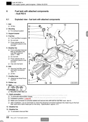

Hi all, realised ive got petrol leaking out at the rear LEFT hand corner just behind the wheel arch.
From what I can gather, the filters on the other side right? But I cant find a diagram anywhere to work out what's on the left. Any ideas?
I'll get it on the ramp tomorrow but having a clue what I might find first would be helpful.

Is this of any use?

Thanks, I've had it on the ramp now and I think it's actually fluid from the DRC hose that goes to the shock that's leaking... tbh I wish it HAD been fuel as it sounds like this is something I'll need the dealer to do :(
