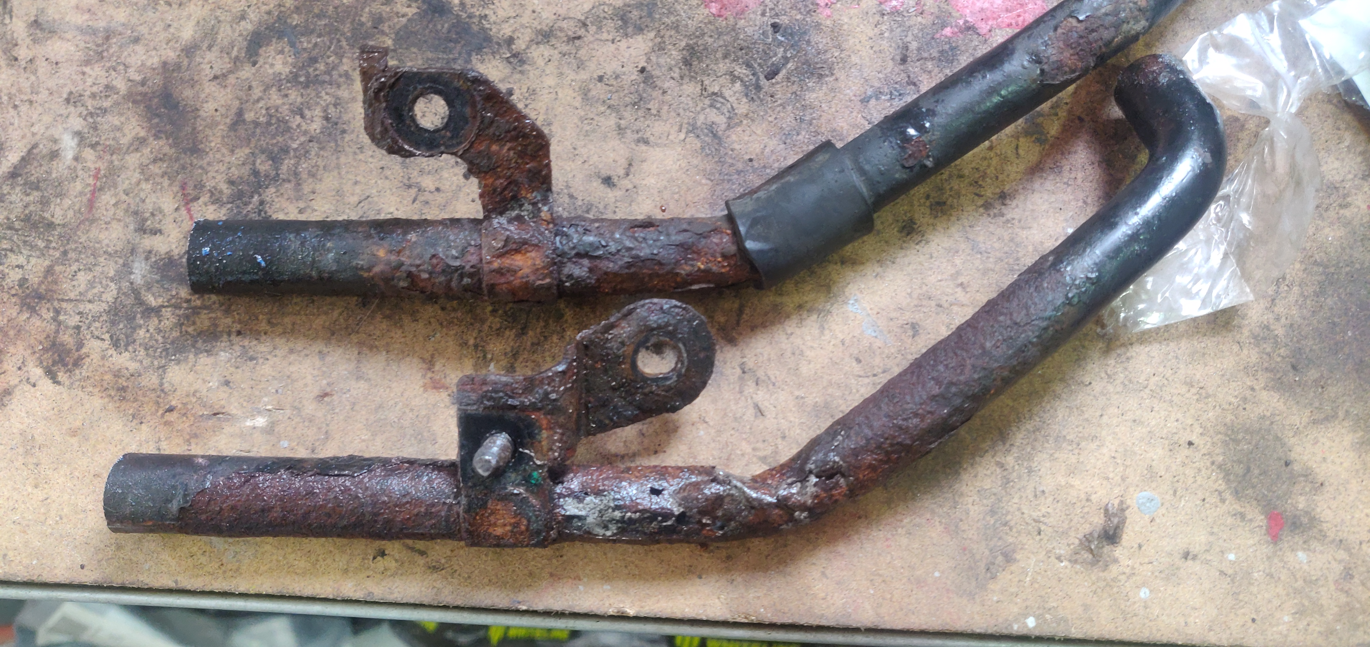

Yes they do take a bit of cutting particularly the cuts that have to be made in situ. Fortunately that's only 2 cuts as the other ones can be made once the pipe is away from the car. One of mine was close to developing a hole an closer inspection (poking with a screwdriver) the other although not pretty to look at was solid. However I'm glad to have replaced both.

The pipes on my RS6 was so badly corroded under inspection, you could clearly see the coolant seeping from the section of the pipe exposed to the elements under the wheel arch. You have to ask why Audi designed these pipes to be located in such a hostile environment. It was my mechanic during MOT (@ Riverside Autos in Birmingham), that first highlighted it to me. He said removing them wasn't hard; however, re-installing wasn't as easy. One thing to note is he applied three layers of protective paint to the new pipe before re-installing them and suggested that I regularly have under the wheel arches cleaned of debris that naturally collects through everyday use. First-class job.

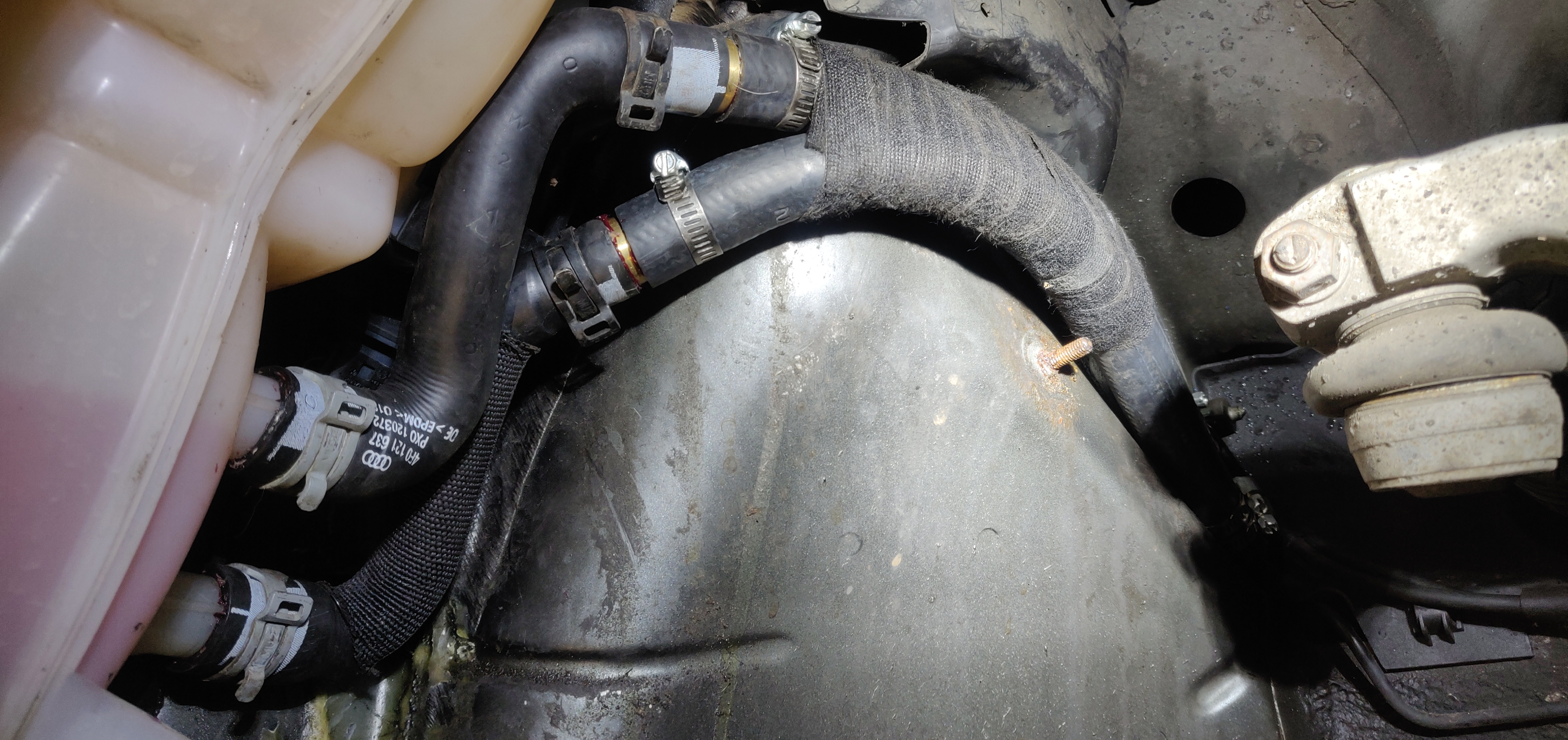

cammmy
Posts: 247
Joined: Tue Dec 10, 2019 3:32 pm
Re: Coolant pipe corrosion
Post by cammmy » Thu Dec 03, 2020 7:10 pm
Fairly happy with this.
Hadies
Posts: 32
Joined: Mon Mar 09, 2020 10:03 pm
Post by Hadies » Fri Dec 04, 2020 2:27 pm
Tidy work man!
cammmy
Posts: 247
Post by cammmy » Fri Dec 04, 2020 6:39 pm
Thanks, it's definitely not the worst job but I think the body saw really helped vs using a pipe cutter.
