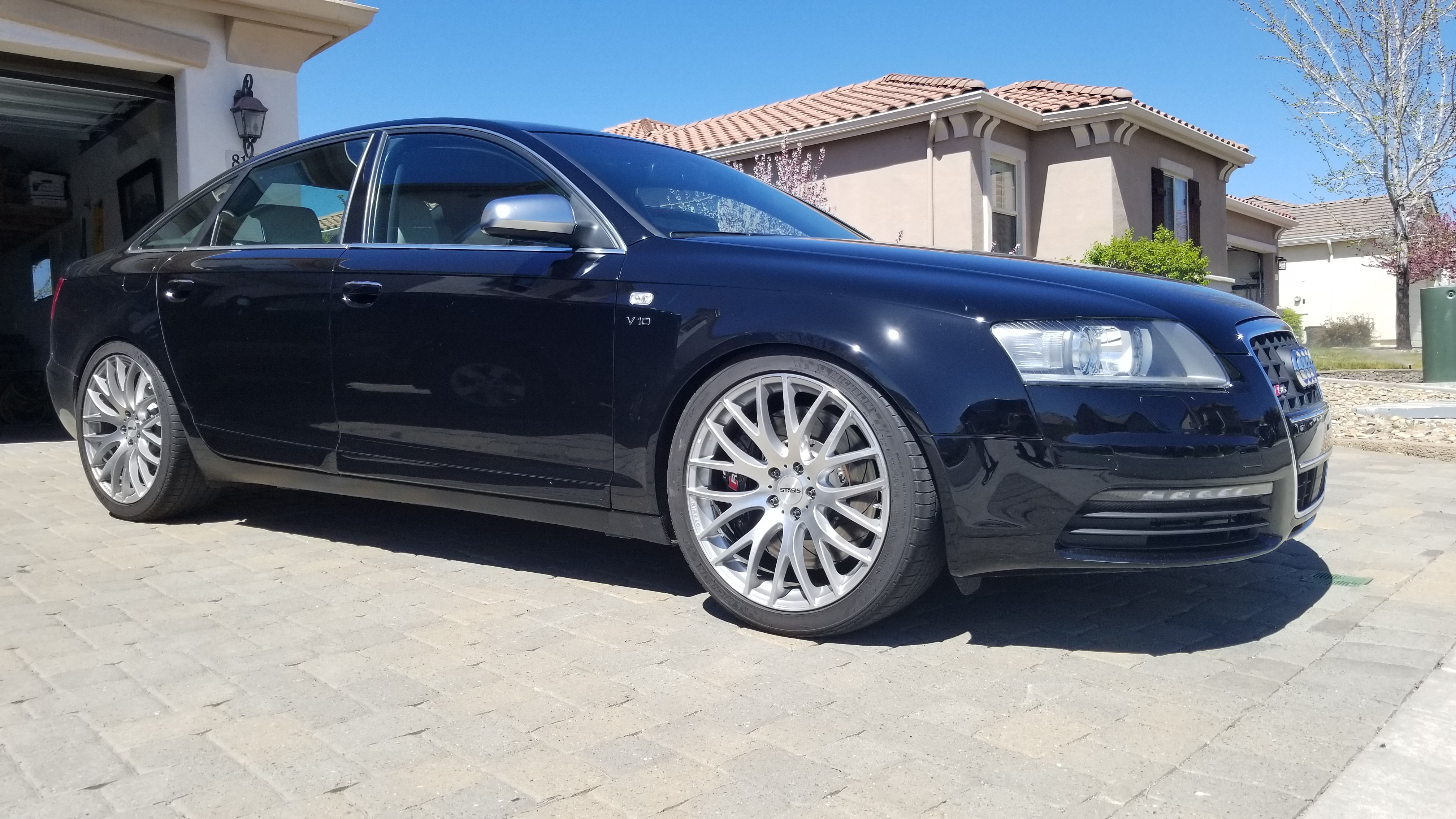

Hey Guys this is my first post, this may have been asked previously, if so apologies.... My name is Peter and I live in Lake Tahoe Nevada, US

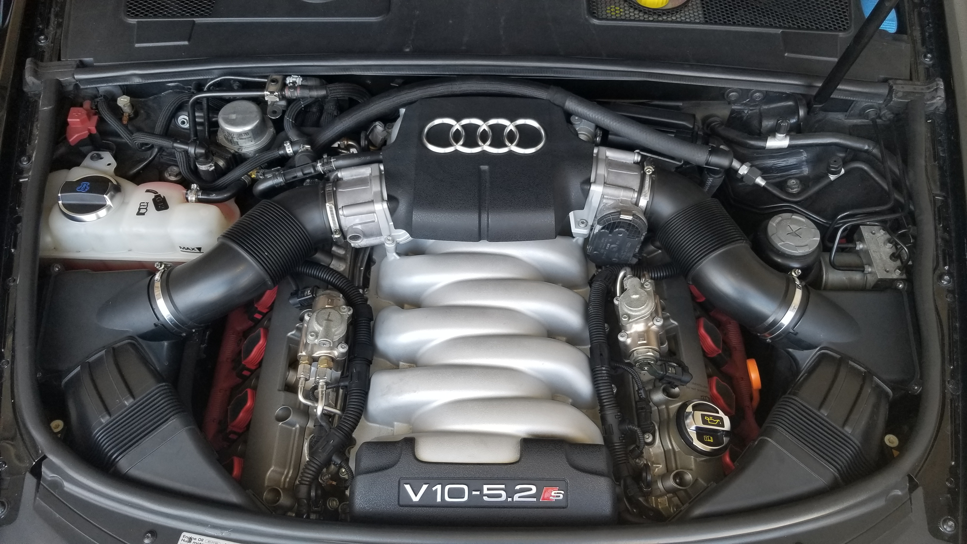

We are not gifted here in the states with the turbo v10, I had to instead purchase the NA version; C6 S6
I am turning this car into my audi club track car, I purchased a set of C6 RS6 front calipers and am now in the process of finding proper 2-piece discs.
