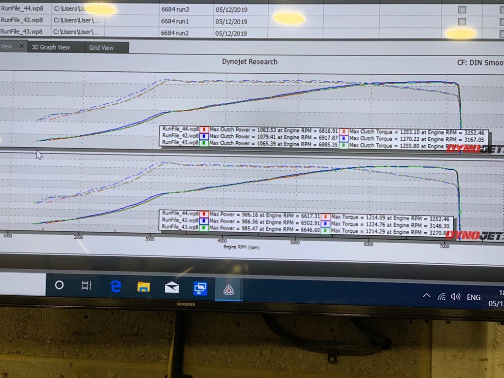

Fair enough. Did you get any other times from your 1080 BHP engine, after doing the 100-200 in 4.7?
Nick
Nick
Re: C6 build stage ....... who knows
4.4 mate best on 99 Octwelwynnick wrote:Right. Did you get any other times from your 1080 BHP engine, after doing the 100-200 in 4.7?

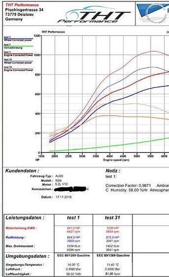

I think it's down to engine revs.
There are some tuners like THT Performance that use lots of boost & torque, but the power peak is only around 5600 rpm.
Some tuners restrain the torque but let the engine rev higher, and hit peak power at 6900 rpm, like S4Players car:
Nick
Nick
