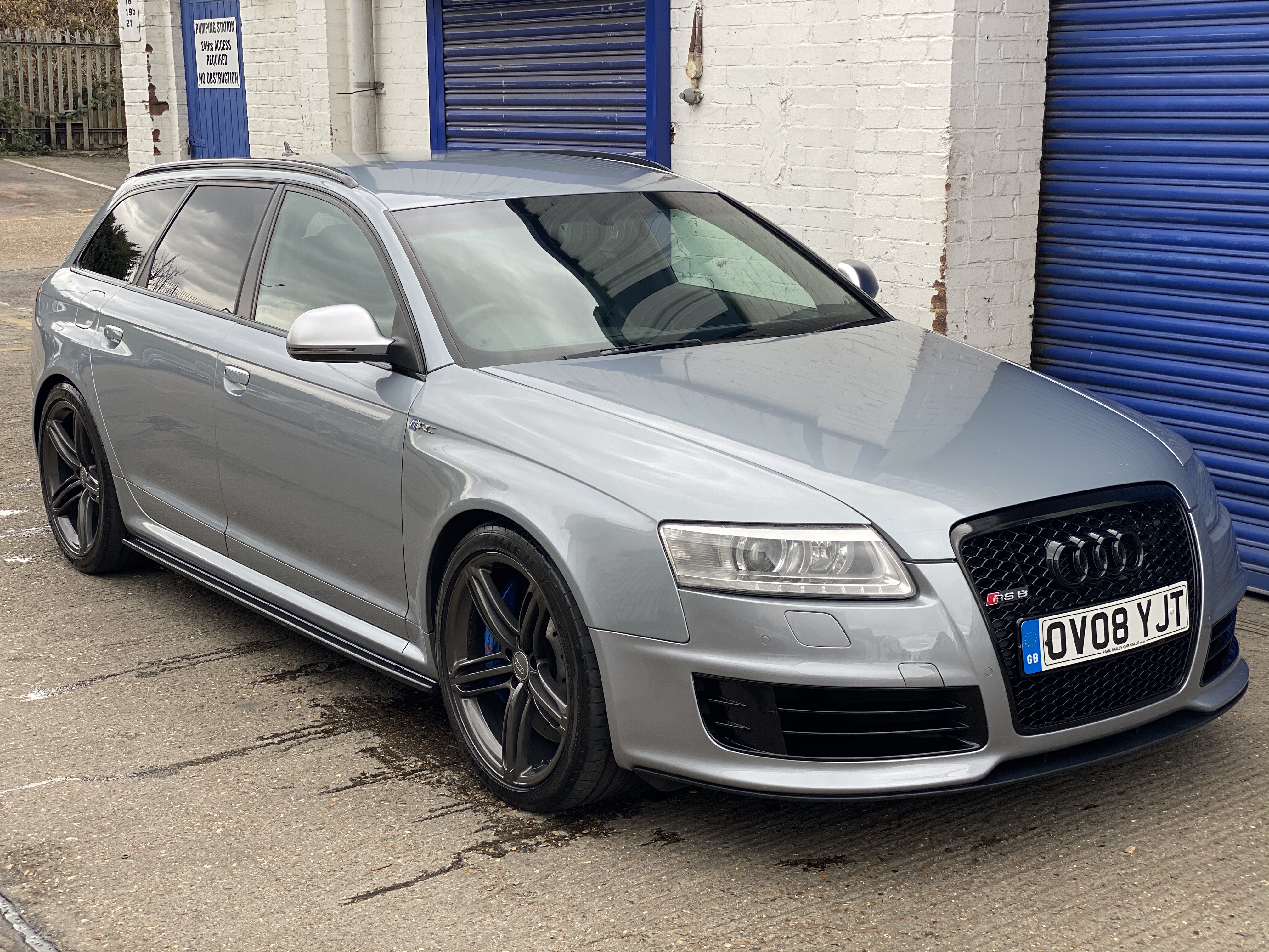

Here’s a pic

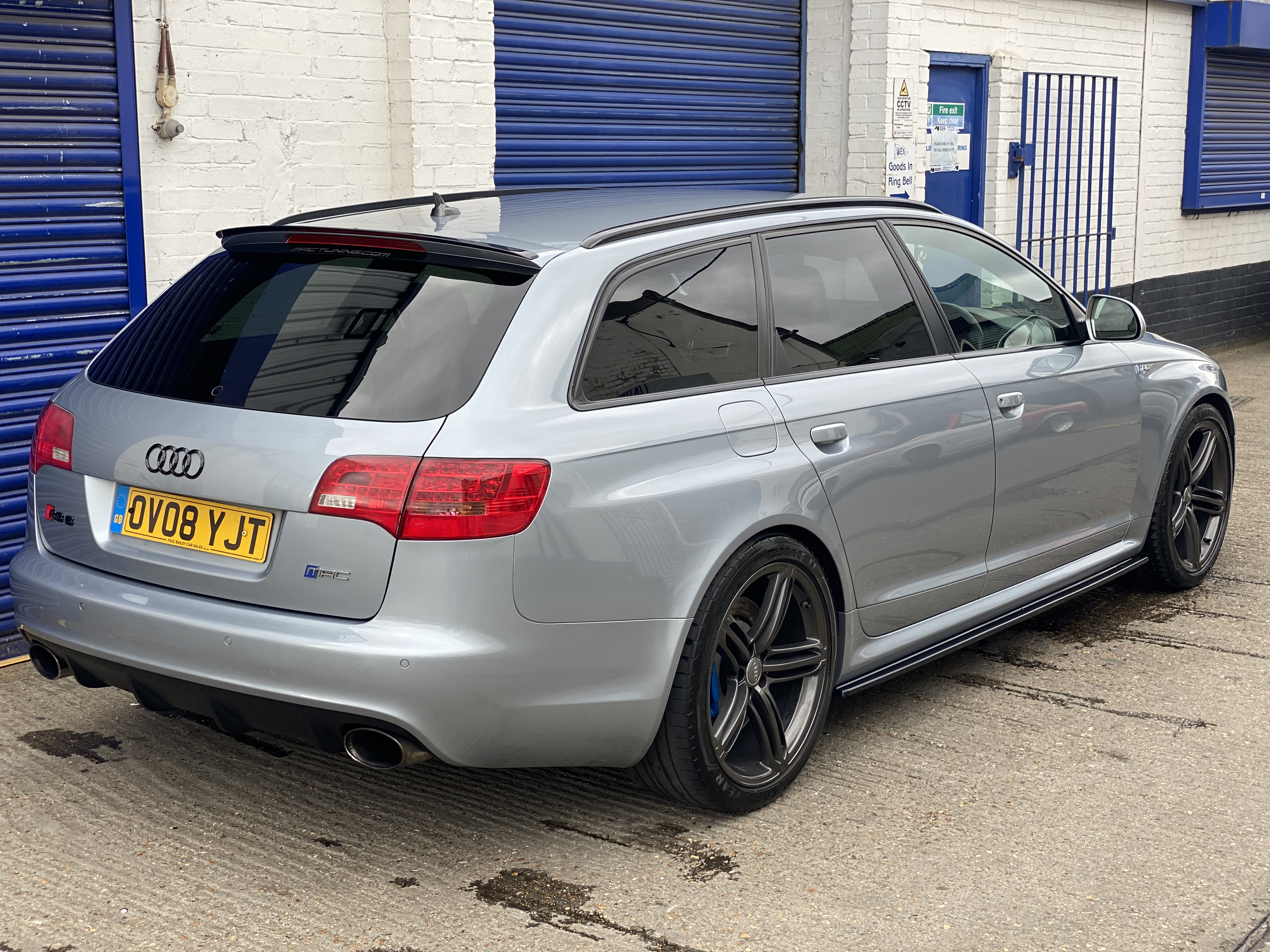

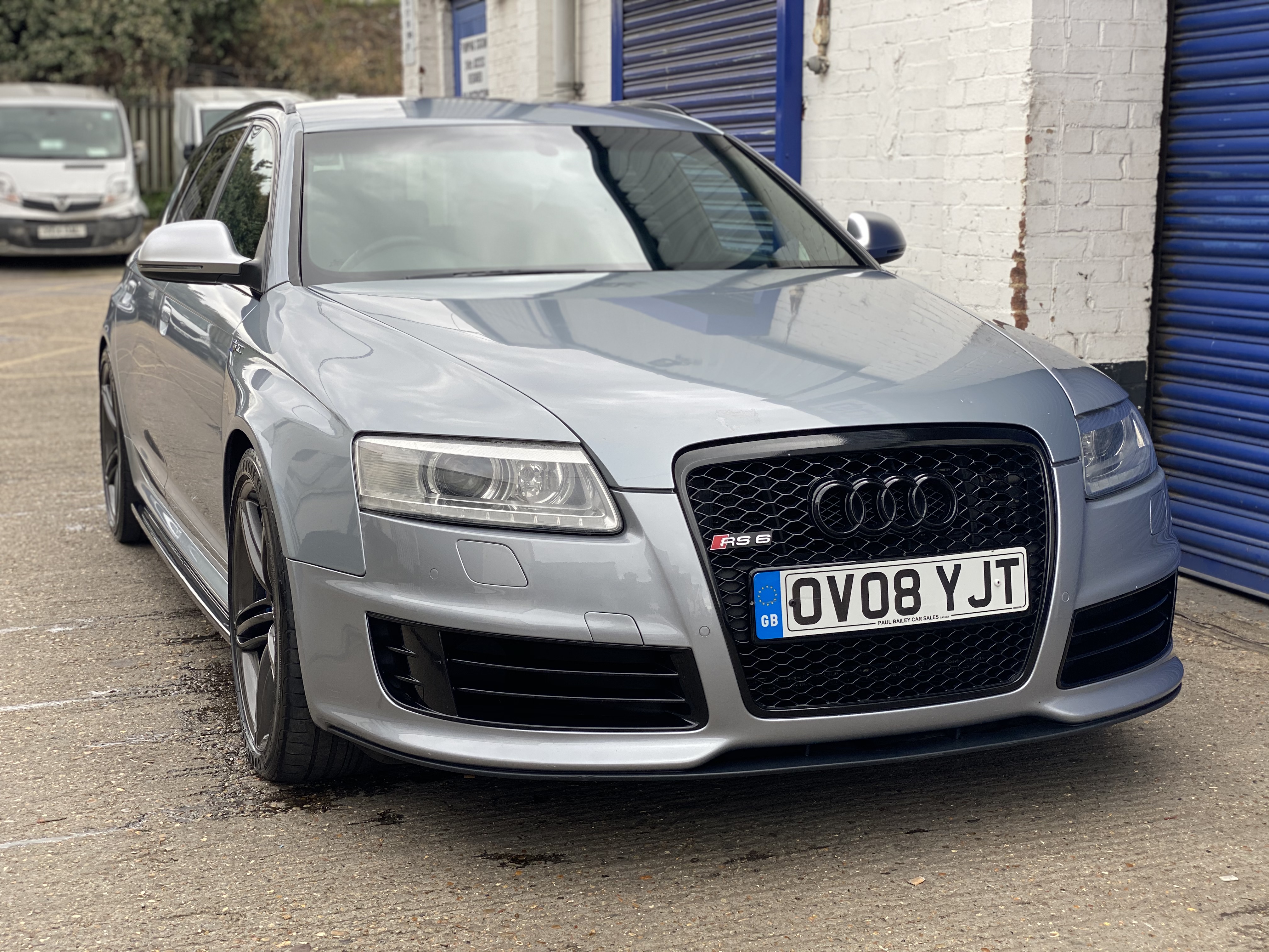

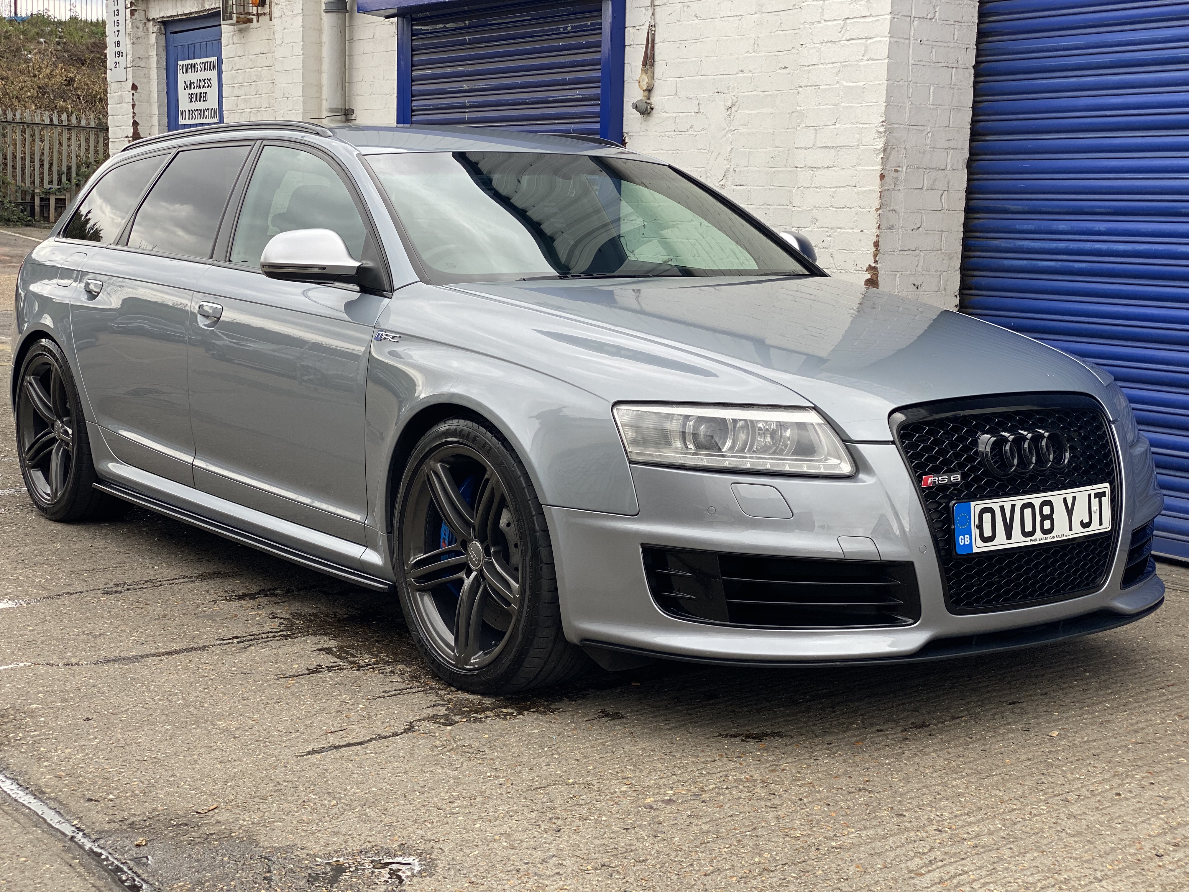

Gave it a good clean today
Took the horrid headlight and back light film off
And the front splitter
Few issues whilst on the ramp
Rear shock is leaking
And so is the front passenger side one
So going the coilovers Route now
How do I get rid of the DRC?
Is there a kit you can buy?
Also both inner lights on tailgate need to be changed
And drivers rear led lights are not working
