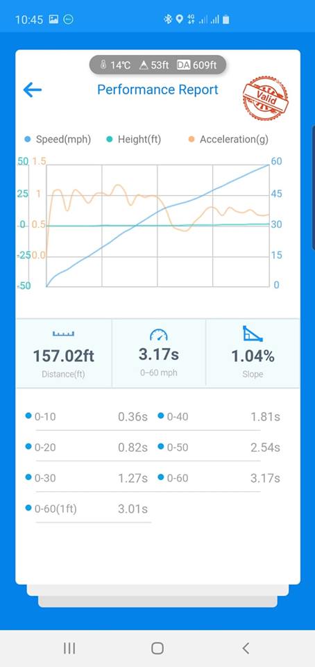

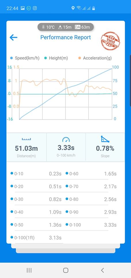

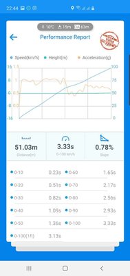

Launch is pretty good with a 1.68sec 60foot and with a lot of wheel spin. I think I can drop to it high 1.5 sec with better tires .
0-60mph is good too with 3.19s (2.98s 0-60 at 1feet elevation) ,0-100km/hour at 3.33s (3.13sec at 1 foot elevation).
What really hurts the car times is its gear change time (look at attach draggy pics) . I am sure it will never be as fast as a dual clutch but I am also sure there is something wrong with the tune the car is using now. I am still trying to understand how the tcu is working but if I understand the maps correctly the redline on the tcu for a gear change is at 8010rpm at full load (stock 6880) . Engine limiter is at 7200 (stock 6900) . So the engine redlines before the tcu gets ready for a gear change. The engine load drops so the tcu starts to make the gear change. I think this is the reason why is the gearchange is so slow now.
Will try and flash a file with tcu gear change set to 7150. Also will raise pressure from 17.5 to 18.5bar.
I think the car will drop below 3 sec for 0-100Km/hour with the gearbox fix and also better tires. Thats really good for a car that weights so much

I see what you mean about the slow gearchanges, but that's still a great 0-60 time. Have you tried timing a 1/4 mile? I wonder if you could crack 11 sec?
Have you seen this video of the GoGi Golf? The tacho needle bounces off the limiter before the transmission changes up. Is that what happens to you?
