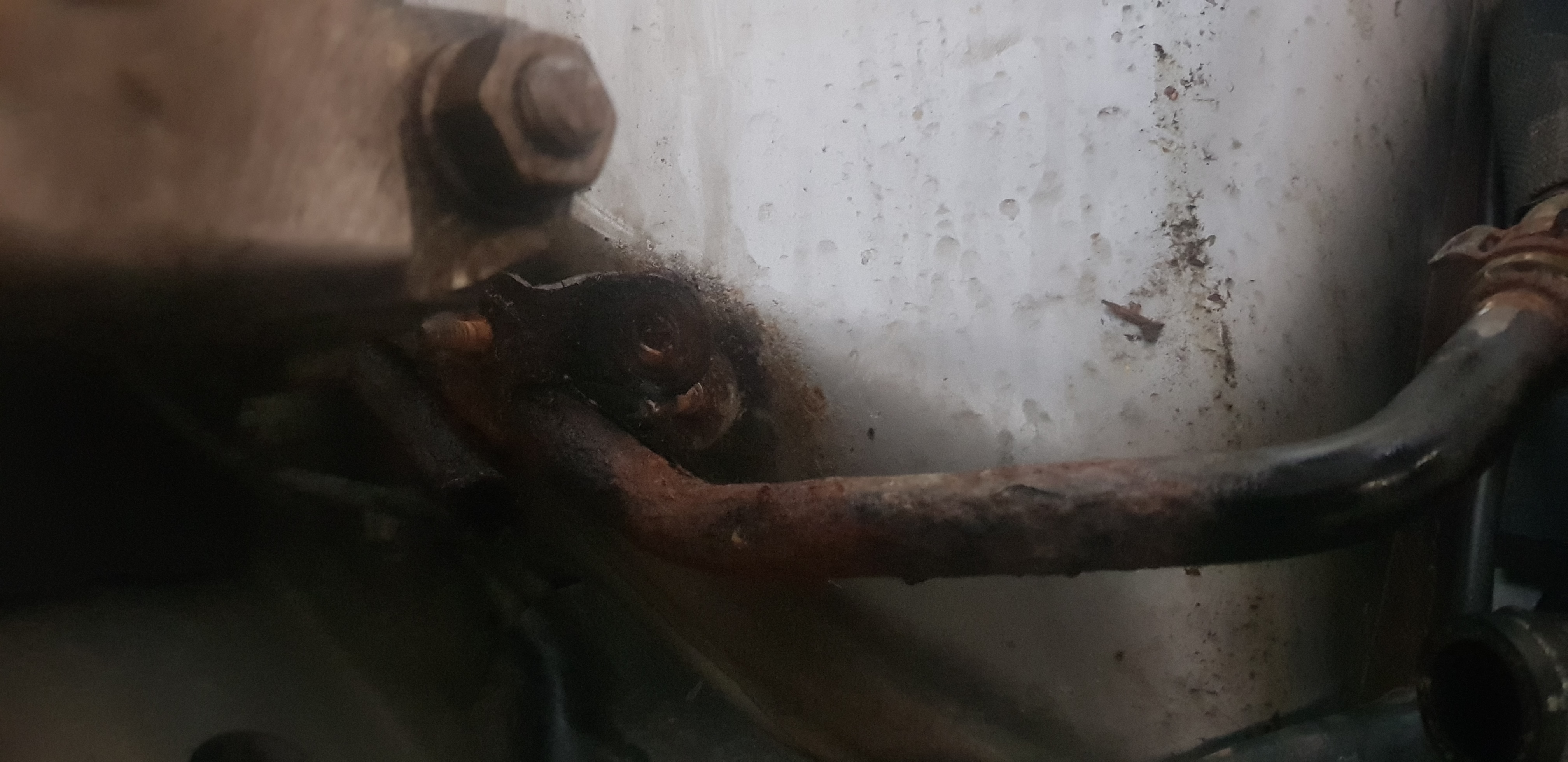

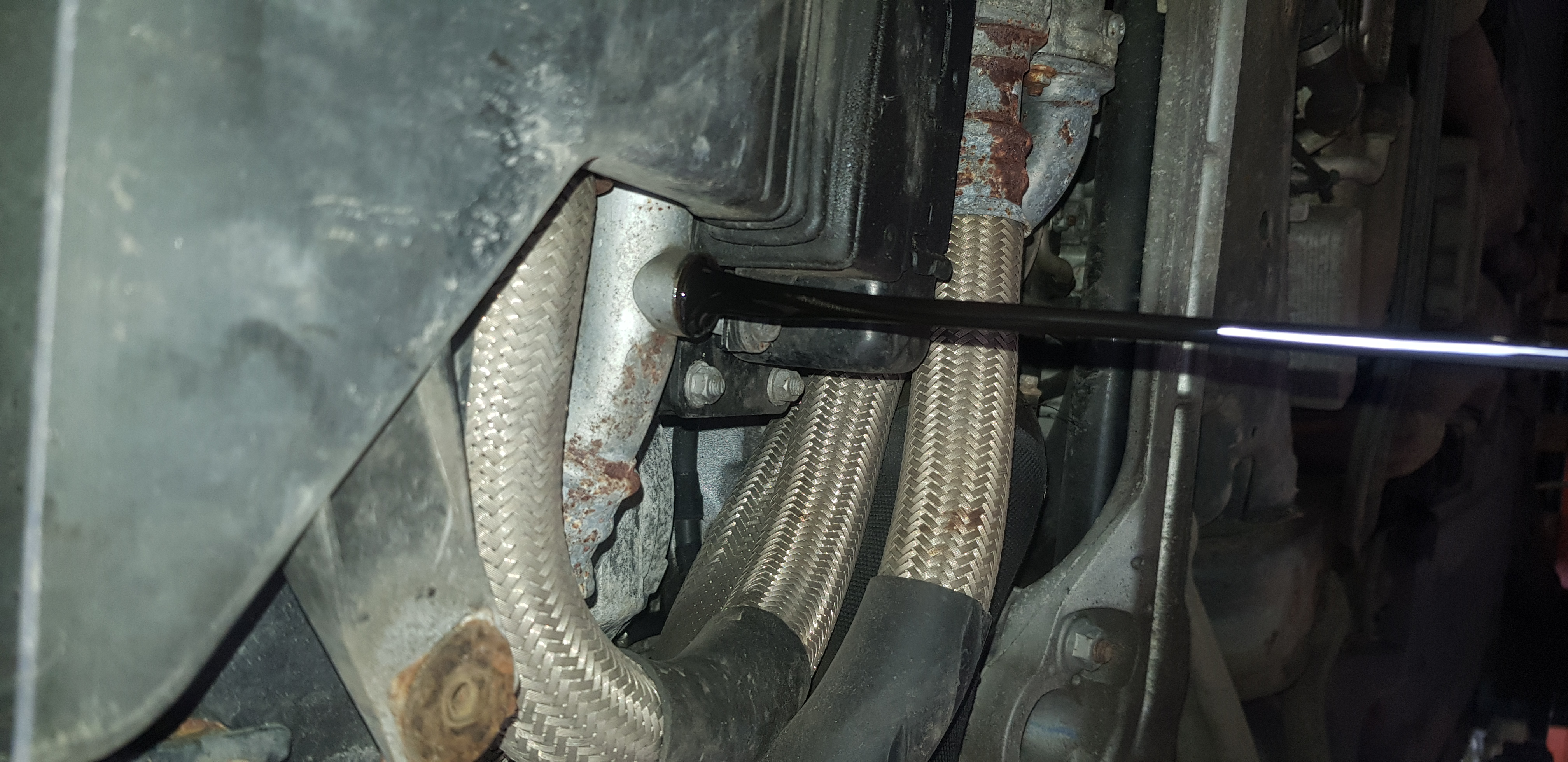

Took about 2.5 hours all told and was easy.
Hardest part is the under tray.
It's a bit fiddly but not difficult.

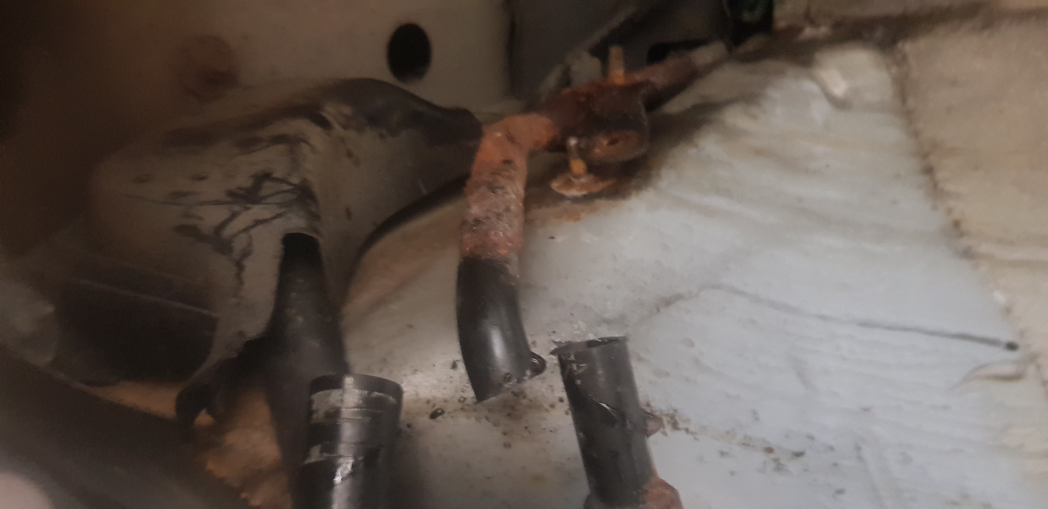

If anyone knows the size of the coolant pipes ,I would like to know as we will replace the bad bits with rubber/silicon and probably get some metal one fabricated at a later date.

Sorted the coolant pipes today.
Took around three hours

We replaced the pipes with silicon hose and then spiral plastic hydraulic hose protector.
