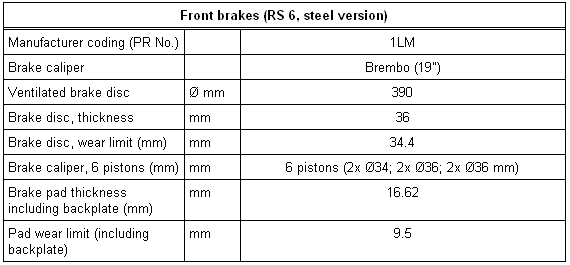

Assuming that I've measured them correctly as the pistons in my calipers are almost at base 'cos the pads are nearly new, (I've measured 3) I reckon that they're 32mm.
The pistons are in 2 different diameters;
2 - 34mm,
4 - 36mm.

I thought "What?" then some Googling showed why. Brembo pistons are stepped, with the pad face being some 4mm smaller in diameter than the body of the piston.
38mm piston has a 34.4mm face
44mm piston has a 40mm face
From that I assume (not a good thing) that I measured the 36mm pistons though from many years experience I know that the accuracy of Audi's published technical info is somewhat lacking at times.
