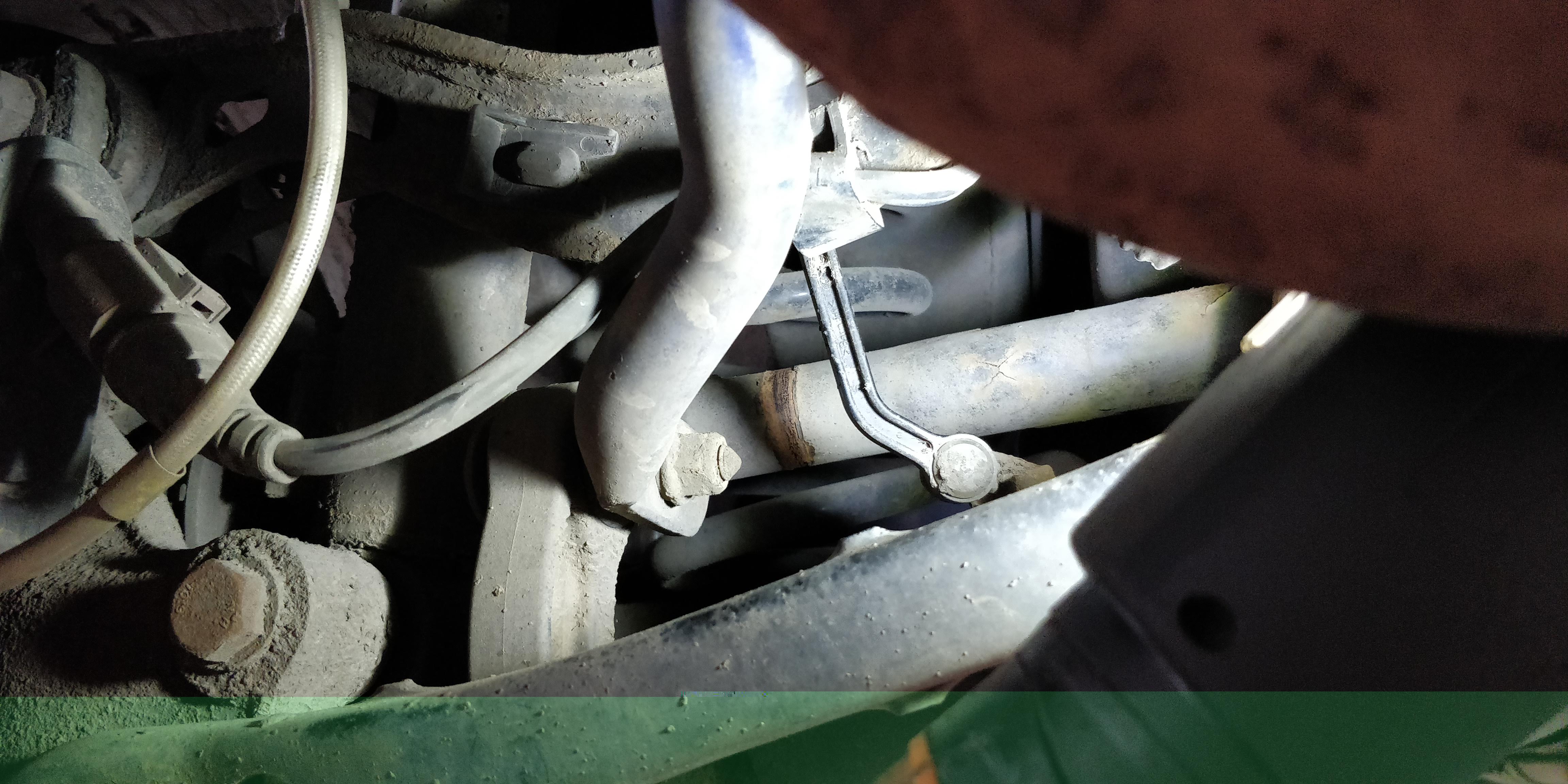

Re fitment, should i opt for inner or the outer hole (e.g. one closer to the edge)?
Ta
(Photo enclosed for ref purposes).

I'd be inclined to start on the outers and then move to inners if you want it stiffer. You might have some clearance issues on the rear using the inners but IMO that depends on the loads you carry and/or the condition of the rear springs.

Ta Jim - much appreciated.Jim Haseltine wrote: ↑Mon Feb 18, 2019 3:47 pmI'd be inclined to start on the outers and then move to inners if you want it stiffer. You might have some clearance issues on the rear using the inners but IMO that depends on the loads you carry and/or the condition of the rear springs.

Proviso: The above applies if using OE C links. If yours have polybushes I don't think it matters.Jim Haseltine wrote: ↑Mon Feb 18, 2019 12:35 pmThe real kicker is that you shouldn't really torque the fittings until the weight of the car is on the suspension which requires some ingenuity unless you've got a lift or a pit.
