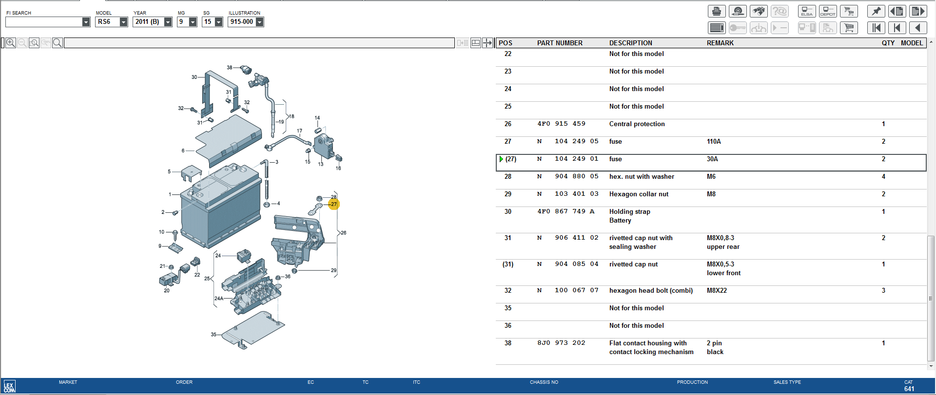

Hi Don,
The part number for the 30A fuse is - N 104 249 01
Hope this helps,
Douglas

douglas96 wrote:
Tue May 29, 2018 9:28 pm
Hi Don,
Hope this helps,
Douglas
Thanks :)
