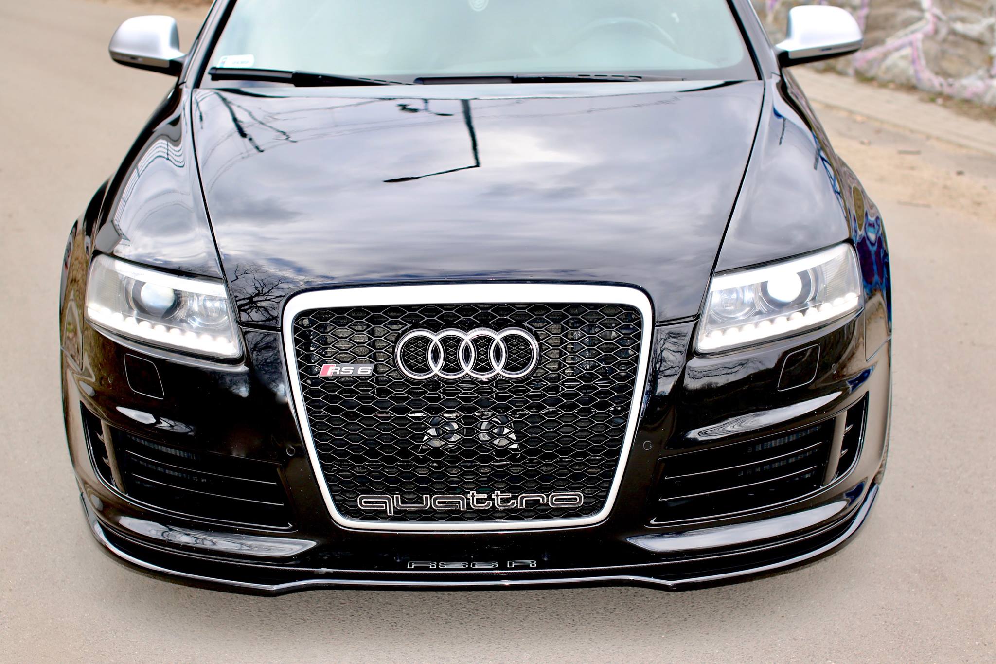

I have just fitted these up, fair job TBH as i wanted to set them up with factory type fastners and no extra holes. the front lip can be fastened by removing the stock black lip and using it as a drilling guide for the supplied hardware. The side skirts however i had to drill quite a few holes in the plastic OEM skirts and used nutserts with the same torx type bolts as factory.
Overall im very happy with the quality. Im thinking of having them reproduced in real carbon though.
Pics are not my car as mine as its not handy atm.

Hows the quality? Is it flexible? I have been running with a fiberglass unit which I have ripped apart twice.......
