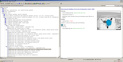

As for the oil level/temperature sensor (G266), according to ElsaWin, the right side headlight has to be removed to replace this.
