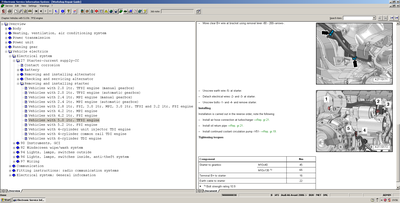

Hi,
Here is the procedure to remove/install the starter motor. It's attached to the gearbox so doesn't look like the easiest of things to get to. I'll have a look later on today where the starter relays are on the car.
Douglas
As pointed out by Jim, the procedure does actually state the engine and gearbox have to be removed.

Jim Haseltine
Posts: 910
Re: Starter motor / relay
Post by Jim Haseltine » Tue Jan 09, 2018 12:51 pm
It says 'Engine/gearbox assembly removed'.

God so it does!! It's a bit early in the morning for me to be posting I think! :? Thanks!
Jim Haseltine
Posts: 910
Post by Jim Haseltine » Tue Jan 09, 2018 5:20 pm
I've also had a quick look at things and doubt that you can get to the starter mounting bolts and cables with the downpipe and turbo in place. If I've got the time (and it's a bit warmer) at the weekend I'll see about taking a closer look.

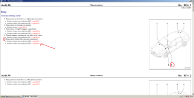

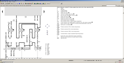

Hi 993turbo,
Here are the fitting locations for the starter relays and also a current flow diagram should you need it (hopefully not though). Also I see your location is Marbella so I'm assuming that your car is a left hand drive as you can see from the pictures.
Hopefully this helps you.

Post by 993turbo » Mon Jan 15, 2018 8:07 pm
Cheers! Fixed. Starter relay.

Post by 993turbo » Sun Jan 21, 2018 8:55 pm
The main one. Upper to the right. Its a standard rele’
