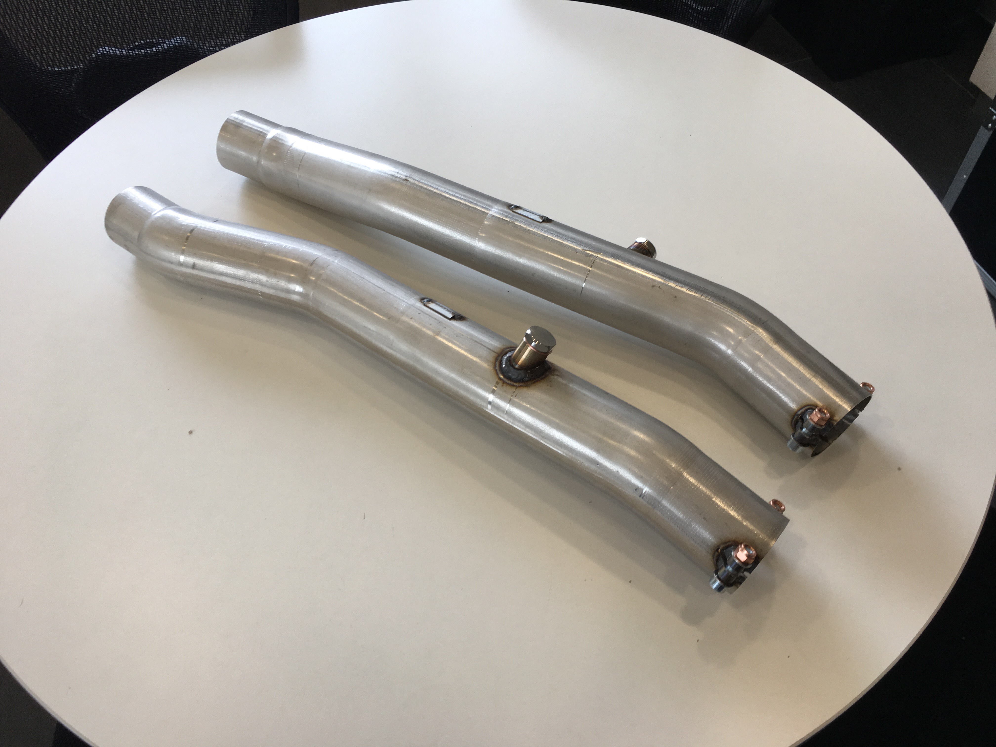

Progress on acquisition of parts progressing slowly...
Secondary CAT Replacement Pipes from Supersprint...
